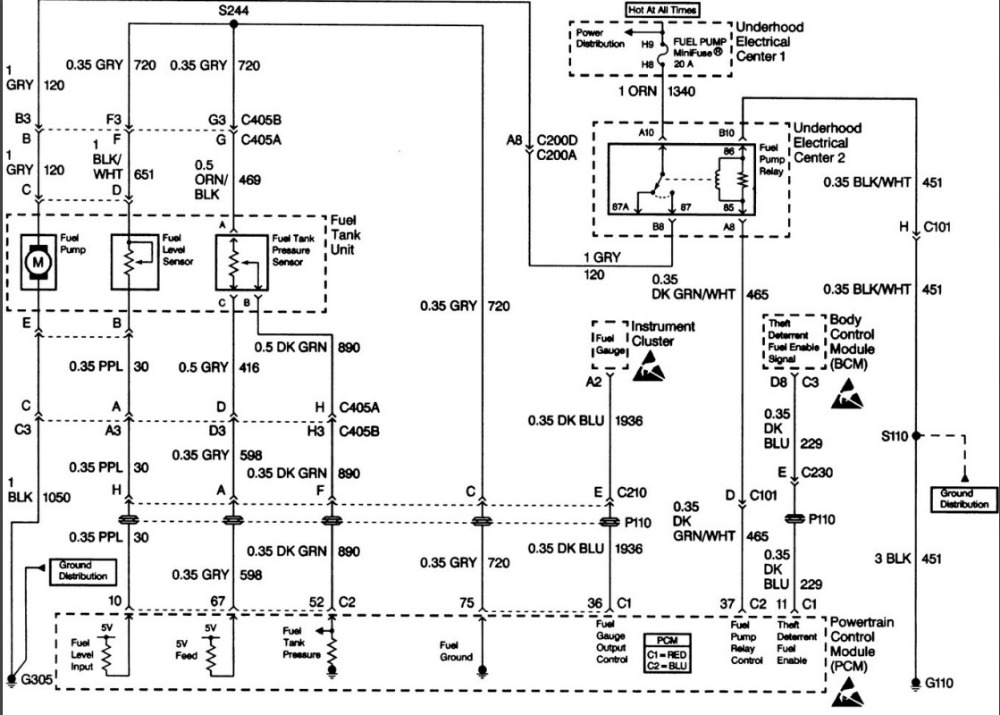

8 years 4 months ago #21187 by Tyler
I'm with Noah, chase the fuel pressure issue. Maybe give it some carb cleaner and see if you can keep it running that way? Just to make sure you're on the right path.
I looked at the power distribution diagram, and didn't see much tying the alternator and fuel pump circuits together. :unsure: Pulling the tank is indeed a challenge, but there is a body connector near the tank (on the underside of the car, right next to the ABS harness connector) that you can test at before going that far. It's C405 in the diagram below.

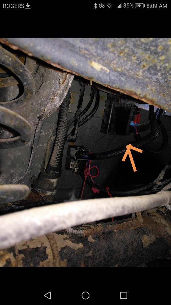

car has pressure now though reading only about 25 psi and surprisingly the car is responding well to acceleration, from idle to WOT and even at snap...(wondering if this is its normal pressure). I check power and ground underneath the car coming from relay, and harness connector, and had intermittent voltage supply. There was a two wire component underneath that that I cleaned and tapped, at the same time I tried to pich return hose going to fuel tank with the hope of increasing fuel pressure. When I started engine , it immedietely fired and idled flawlessly. My question is this: pinching the return hose help increase fuel pressure? Was the 2 wire component I was tapping some sort of a cut0ff switch /inertia switch? I wl try to take a picture of the underbody and post it.

8 years 4 months ago - 8 years 4 months ago #21421 by robert.lesaca
Hi Tyler and Noah ...
Im attaching a picture of the component I was tapping on. Just wondering if you know what this is...
Fuel pressure Ok though hovering between 25-30 psi, and no more DTC PO441. This a FIX btw.
Thanks again, Robert.

8 years 4 months ago #21436 by Tyler
That'd be the EVAP vent valve. That and the P0441 might have been related? Tough to say.
