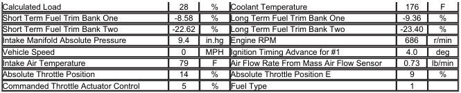

2017 Honda Ridgeline with the following codes.
P0304 - Cylinder 4 Misfire
P0305 - Cylinder 5 Misfire
P0306 - Cylinder 6 Misfire
P0300 - Random / Multiple Misfires
P219B - Bank 2 Air/Fuel Ratio Imbalance
P2098 - Post Catalyst Fuel Trim System Too Lean Bank 2
P0175 - System Too Rich Bank 2
P0430 - Catalyst System Efficiency Below Threshold Bank 2
When I ran codes, i found the Freeze Frame Data
with the following information
As you can see the Fuel Trims are VERY Rich. My B2S1 (Wideband) was reading Lean in the range of 1.3-1.7 Lambda and the B2S2 (Narrowband) Was at 0V. I check this Sensor and found that it was dead. I bought a replacement for the O2 downstream (B2S2) and now it is reading 0.98v so Full on RICH.
I gave the engine a Vacuum leak and then introduced brakeleen into the intake and verified it was reporting correctly. The Upstream on Both were responding to Lean and Rich but I found what i think is an issue. The Bank 1 Upstream is fairly flat line and responded accordingly but the Bank 2 Upstream is very erratic and didnt follow the Bank 1 very well.
Note that the Bank 1 was going into Closed Loop but then would Open Loop (due to Fault) and Bank 2 has always stated Not Reported which makes sense with the fuel trims and erratic reading from B2S1 and B2S2 reading Full Rich. Also note that the upstream sensors were swapped from bank 1 to 2 and 2 to 1 for comparison and the erratic behavior stayed on Bank 2 which leads me to wiring or ECM issue possibly.

Also tested the Lambda readings with and without the MAF connected and got a strange result. Without it connected my Bank 2 Lambda was hovering around 0.8 and with it plugged in I was at Lambda 1.2-1.7
Things I have yet to check was the Timing (which would be done with PicoScope) and Fuel Rail / Injectors.
Curious if anyone has any ideas of what maybe causing this as I am currently lost on this one.

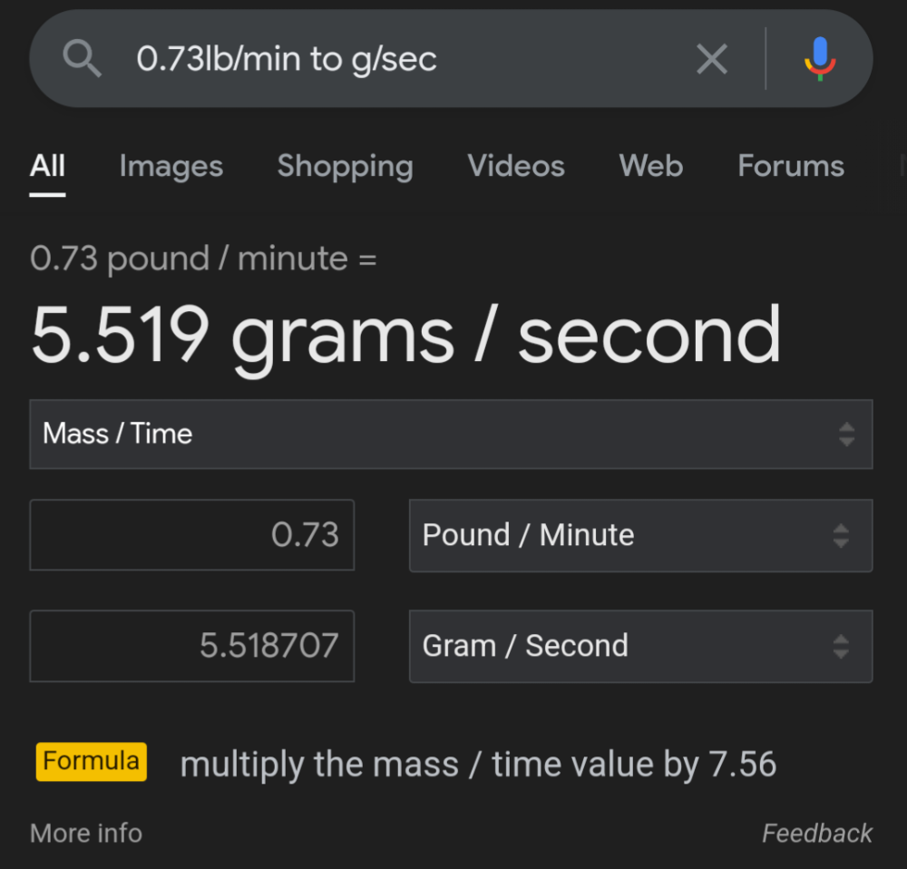

The freeze frame showed 0.73lbs/min
I'm not familiar with that unit of measure for mass air flow, but Google conversion puts it equal to 5.5gps @ idle.
General rule of thumb is 1 gram per second per 1 litre of displacement, or about 3.5gps in the case of a 3.5l V6
