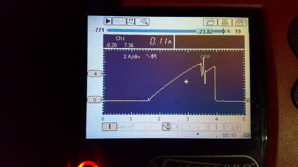

I have problems with the following weveform
  • tatocabrera
  • tatocabrera's Avatar Topic Author
8 years 6 months ago #19386 by tatocabrera
I have problems with the following weveform was created by tatocabrera
someone can explain to me the reasons why I lose my current limiting section
aveo ecotec 2009
8 years 6 months ago #19414 by Tyler
Wow, I've never seen that before. :huh: Does the other coil do the same thing?

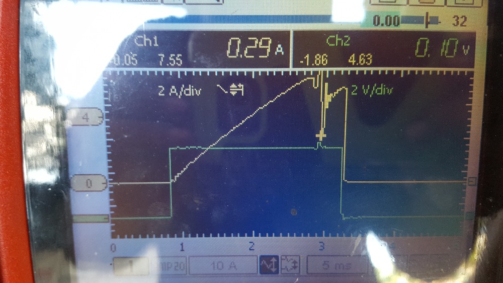

I'd say you're looking at a failed primary winding, but I'd be nice to have a primary voltage trace to go along with it.

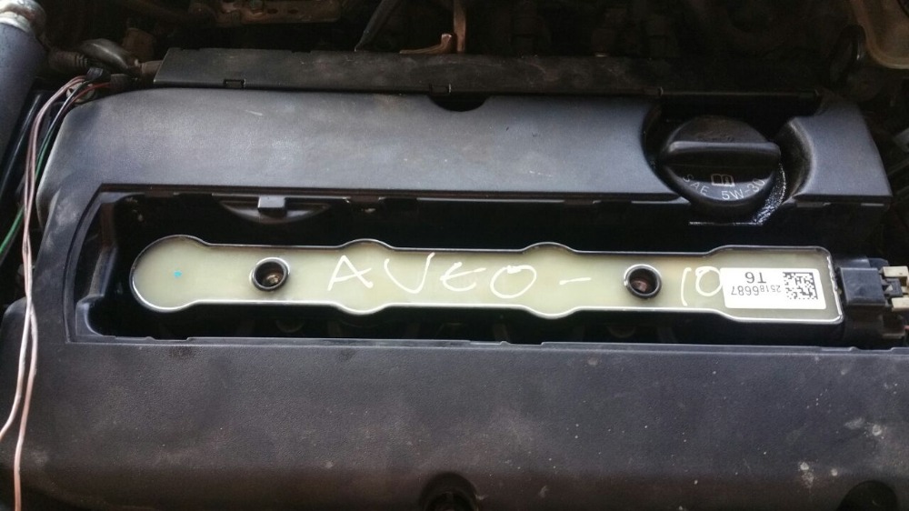

no that is the only one is a coil pack
I changed the coils and for the time I solved the problem

Yah I would say that's a messed up coil
