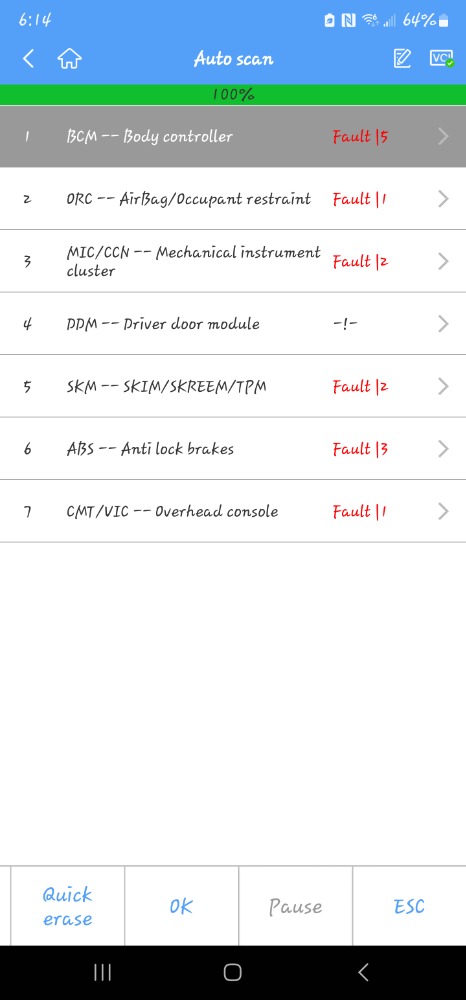

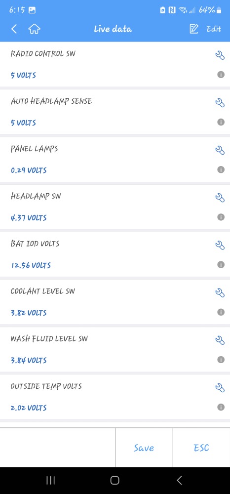

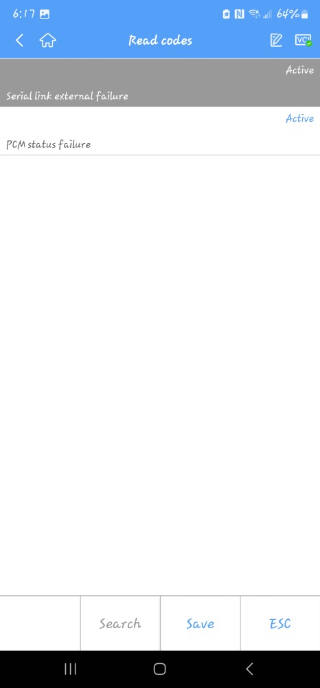

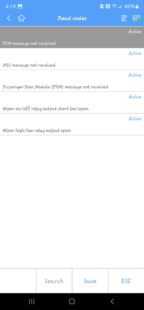

Hello, i am having an issue with my 2004 jeep grand cherokee, i have no gauges, crank but no start
I did have an intermittent issue for the last 2 weeks were my oil pressure gauge would drop to 0 and check gauges would come on, i finally replaced it and the sensor was covered in oil and so was the pigtail, i cleaned it and it did not help.
I have A cheap Autel scanner that can talk to the BCM , ABS , SKIM, but hangs up on the pcm.

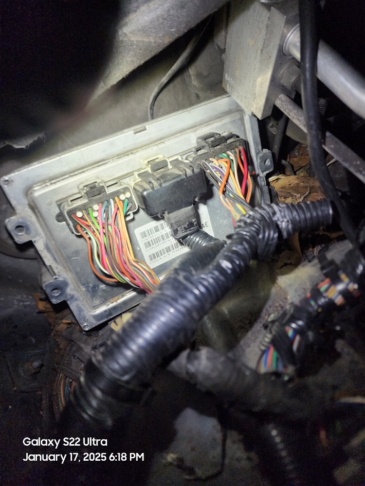

I tried unplugging all the 5v sensors, Crank, cam. TPS , oil pressure
Saw on the forum to go to the cavity 17 and cut the orange 5v supply in case it was shorting.
Still no comms, any other suggestions?

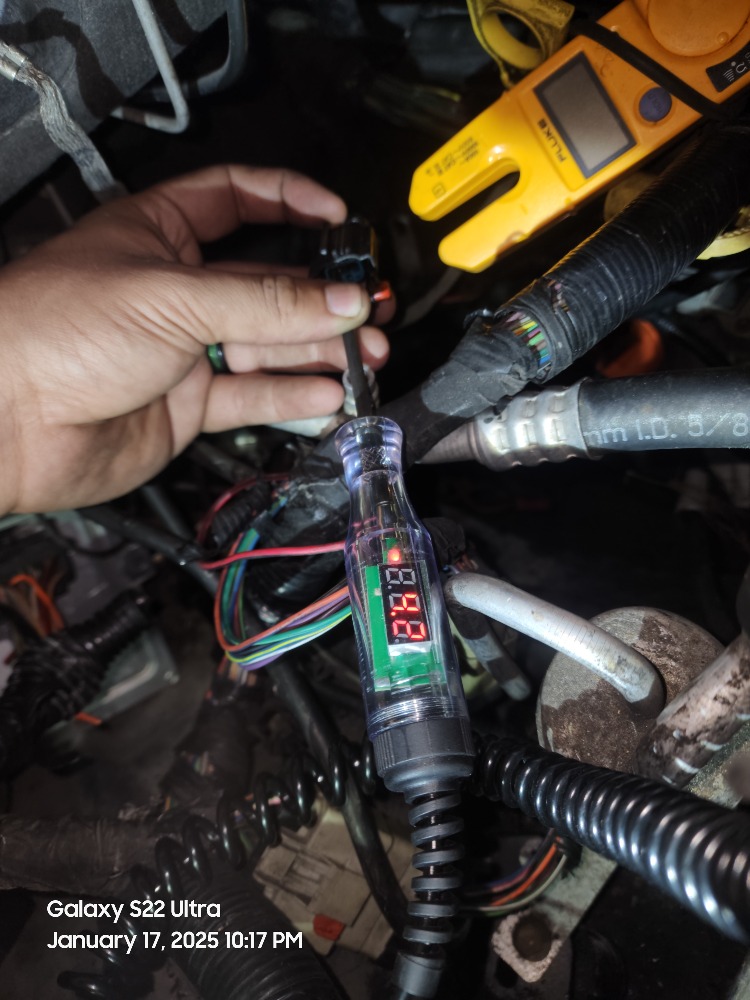

1 year 8 months ago #79476 by Hayzeus
10pm update : Grounds and power verified. Checked the volts on the 5v supply and its outputting 5v, but since i cut it , it should be 0 at sensors right?, well the oil pressure sensor is pulling 4.1v , short to power somewhere on harness? Or do i have that wrong
