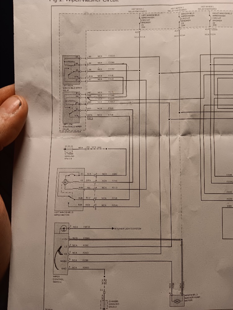

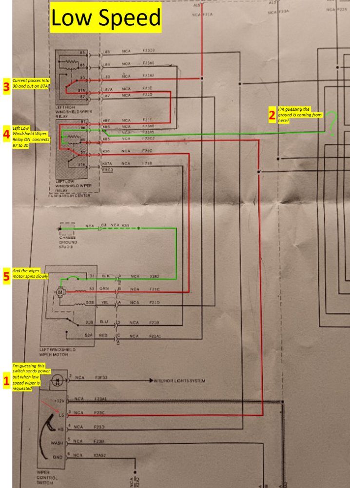

Hey yall so i am confused about why 87 and 87a are connected between the relays. As I see it, the switch gives it a ground for high low speed, but I'm confused on how the relay power and grounds work. I am still learning. The circuit breakers at top are all burned up and j am expecting a short somewhere. The circuit breakers have path to ground at fuse box which is also a little confusing. If anyone can help I'd appreciate it. I am curious to find where Danner talks about this type of circuit design as well. I don't remember any from switch inputs and most were computer controlled. Thanks

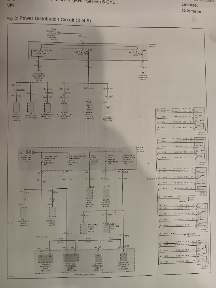

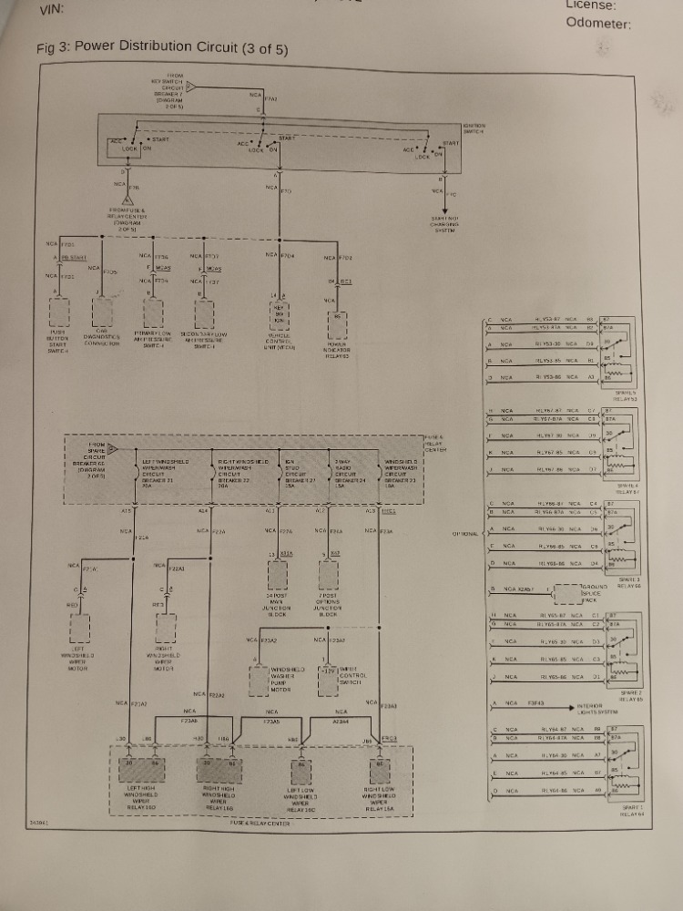

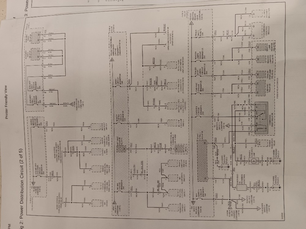

Thanks for the help. My mind gets boogered up sometimes. Hopefully the rest of diagram and power distribution uploaded. The circuit breakers burned up and I have no power. There's no voltage at the switch and interior lights are not working now either but that could be something that I did. What checks would you make? Motors work fine

Again

Power distribution
