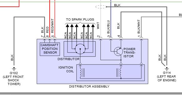

I don't see any 3litre Galants what is the ignition set up -- one coil per cylinder or shared coil wasted spark ? Lean mixture gives high KV but did you also replace the spark plug ?

Andy.MacFadyen wrote: what is the ignition set up -- one coil per cylinder or shared coil wasted spark ?
jsvets2326 wrote: the coil is in the distributor

A distributor throws the dice again on possible causes, the distributor shaft bearing wears causing the spark gap distributor to change as the shaft wobbles about, the rotor arm itself can have issues due to erosion or arcing to ground or a problem with the suppressor resistor built into the rotor arm. Then of course with a distributor you have spark plug wires which are subject to heat vibration have opens and shorts.
