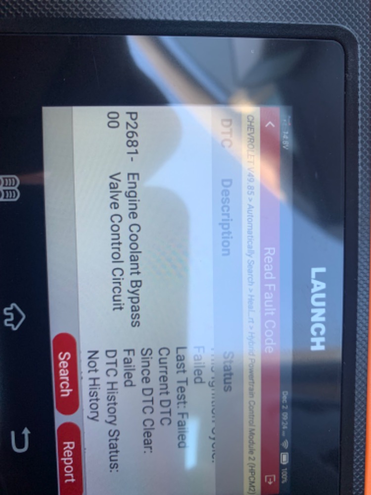

1 year 9 months ago #75092 by spgview
Hello All,
having a hard time figuring out a short to open wire issue on a “coolant bypass valve 3-way” for a 2012 Chevy Volt.
have done the following:
1.replaced 3 way valve
2.Replaced and reprogrammed HPCM2 (K114B)

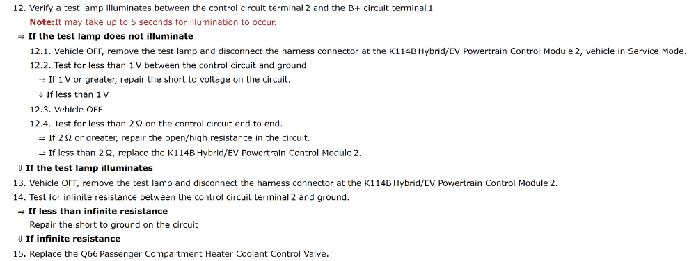

The hybrid powertrain control module 2 has detected a short to voltage or an open on valve drive circuit.
Kinda vague, but we can work with that. I saw that you found .4 ohms on circuit #5125. Stands out a bit when compared to the feedback circuits, yeah, but still a good reading.
I don't know exactly how tough it is to get to the heater valve connector, but my suggestion would be to measure voltage at pin #2 of the heater valve with the connector plugged in and in Service Mode. Backprobe pin #2 or pierce the wire and go over it with liquid electrical tape later. Depending on what you see at #2 at the heater valve will determine where to go next.
Alternately, there's a very specific test included in the manufacturer flow chart that may be worth doing:
This is with the heater valve disconnected and HPCM2 connected, Service Mode. If I'm reading right, the test light should light up after five seconds. As long as circuit #5125 isn't shorted to ground, this would indicate a good working driver in the HPCM2. Both this test and the symbols in the wiring diagram both suggested that this a ground side switched driver.

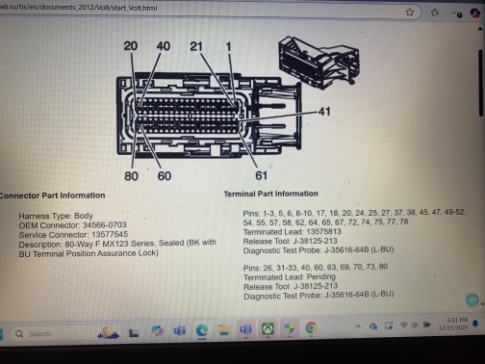

  • spgview
  • spgview's Avatar Topic Author
1 year 9 months ago #77099 by spgview
Hello,
So I replaced all new wires from the passenger compartment heater coolant control valve (Q66) to HPCM2 (K114B)
Pin 2 to Pin 72
Pin 3 to Pin 64
Pin 4 to Pin 50
Pin 5 to Pin 49
I spliced B+ power (pin 1) and ground (pin 6) at the heater coolant control valve.
I still have P2681 code present as a hard code. I reset it and it comes back on after turning the vehicle on and off.
Any additional suggestions?

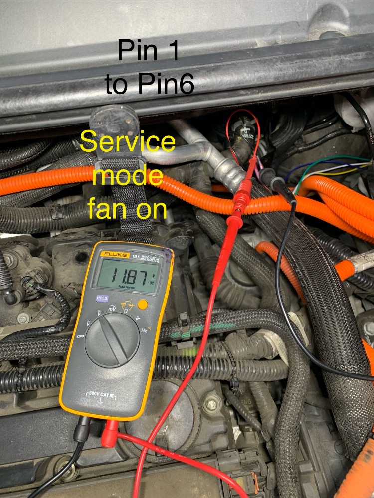

1 year 9 months ago - 1 year 9 months ago #77890 by spgview
Hello @ferris48,
yes, had to post on other sites to try and receive as much feedback to help me overcome this dilemma.
Another member on gm-volt is experiencing the same code. He replaced it under the circumstances of not having heat in electric mode then Installed an aftermarket valve like myself then received code P2681. Hopefully there is a correlation.

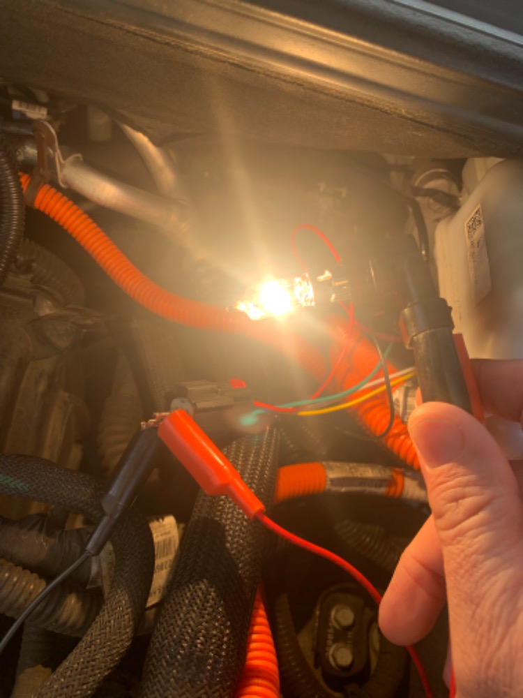

As you suggested after work, I ran test leads to B+ pin 1 then to Pin 6 Ground with a headlight bulb for a load. It appears to be really bright and hurts my eyes if I stare it. Here’s a few photos…
Last edit: 1 year 9 months ago by spgview.
1 year 9 months ago - 1 year 9 months ago #77893 by ferris48
The bulb looks nice and bright. In your other thread you were asking where the fuse was located, it's under the hood, it could be Fuse 12 or Fuse 13 - see diagram here: fuse-box.info/chevrolet/chevrolet-volt-2...2015-fuses-and-relay
If this info's wrong, pull fuses til that bulb goes out I reckon.
Can you do Tyler's test next? I am curious to see what voltage is on this wire.

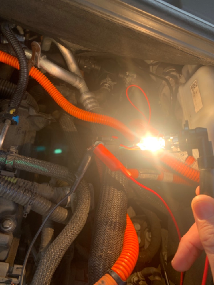

1 year 9 months ago - 1 year 9 months ago #77894 by ferris48
Paraphrasing and repeating from Tyler's post, can you put that head light bulb across female terminal 1 and terminal 2, front probing of course, and then put the vehicle in service mode?
If the bulb lights up that means the wire and driver inside the HPCM2 is working and the odd man out would likely be the valve.
Last edit: 1 year 9 months ago by ferris48. Reason: wrong terminals
1 year 9 months ago #77895 by ferris48
One more thing, if the bulb doesn't do anything try clearing the codes out and try again.

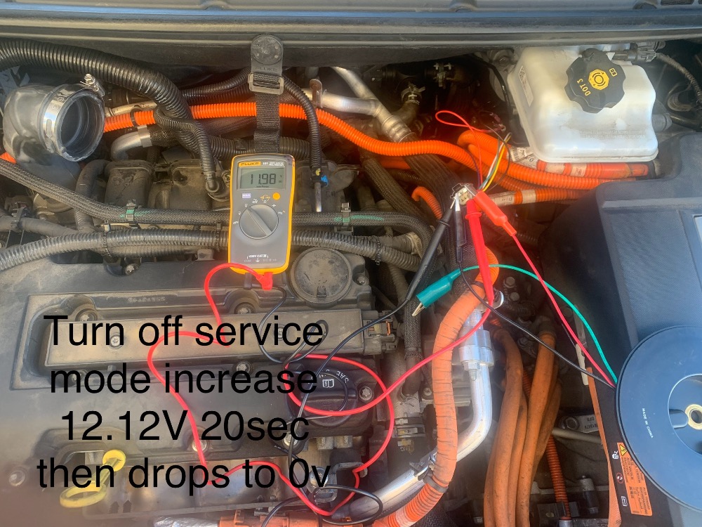

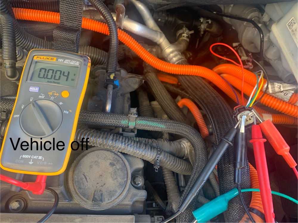

I forgot to perform this test Tyler recommended ,and did so today.
I disconnected the connector from the valve, used a volt meter at Q66.
Pin 1(B+ power) to pin 2 (5125 /Heater Solenoid Valve control)
Vehicle OFF : 0.04V
Vehicle in Service mode: 11.89V
Take vehicle out of service mode and gradually increases to 12.12V for 10-15sec and then drops to 0.04 V when entirely off.
defective valve ?

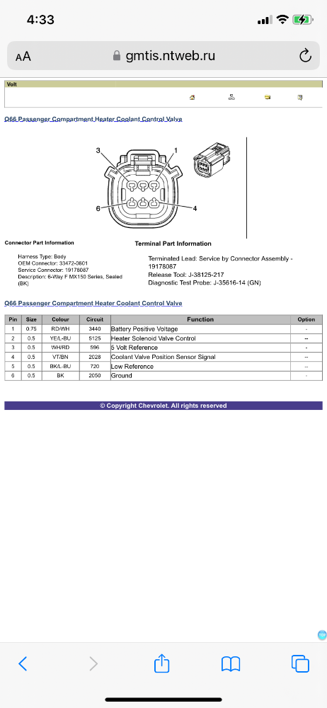

1 year 9 months ago #77938 by spgview
I ran the additional test of with a load(light bulb) on Pin 1& Pin 2
With the light bulb connected to Pin 1 & Pin 2 I had “no light”. Doubled checked power and was 11.78 V
I doubled checked the bulb to make sure I didn’t blown bulb; with constant power Pin 1 & Pin 6 constant ground and it was bright.

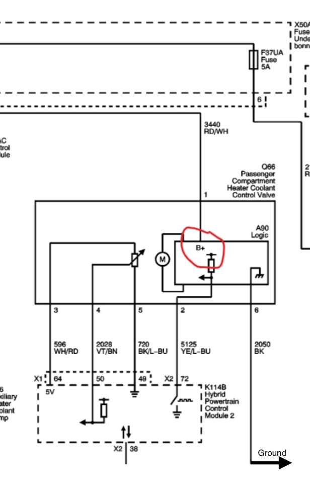

Based on the drawing/schematic, it appears pin 2 is switched ground at the hybrid power control module (HPCM2).
Lost daylight and plan to check resistance of the wire again tomorrow (Pin 2 to Pin 72 wire 5125)
Does this mean the connection is no good at the HPCM2? The wire is new and connectors are both been replaced.
All feedback is helpful, I feel like I’m now getting closer to a solution. Thanks all!
1 year 9 months ago #77947 by ferris48
I think your connection is good because in your last experiment with the Fluke, it showed activity from the HPCM2.
The headlight bulb not lighting is concerning. In hindsight I don't think it was wise for me to tell you to use a headlight bulb on a computer driver and I would have gone with a smaller bulb.
Hopefully the module had some protection from over current and if you could repeat the test you did in the last photo with the Fluke, we will know if the module is still okay. Additionally, put something between those two T-pins. If they touch eachother while the car enters service mode, that is a direct short to voltage which would be bad.
I can only speculate as to why the bulb did not light. Perhaps the HPCM2 didn't give it a full ground, to protect itself because it didn't like the current flow. Or perhaps a DTC prevented the HPCM2 from attempting to control the bulb, or maybe 5 seconds didn't elapse before you turned off service mode. Or worst case scenario - the headlight bulb killed the HPCM2 because I told you to use a bulb that draws too much current. For that, I am sorry.
If you're able to reproduce the experiment with your Fluke like in that last photo that would mean the HPCM2 is still alive, which is good news and if you're feeling up for the task, to do the bulb test again but with something that doesn't pull such a big load, like an incandescent test light, something in the 200 - 500 milliamp range perhaps.
Or if you wish to stop and await the arrival the the GM valve that's perfectly reasonable to me as well. Perhaps we can continue the diag if the code persists if you will still allow me to help you along.

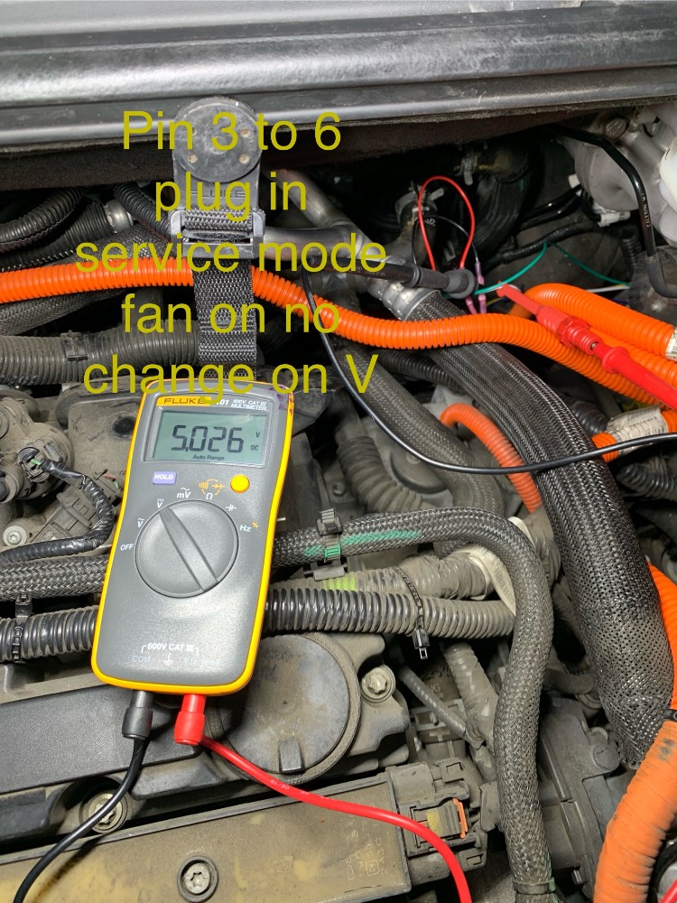

1 year 9 months ago - 1 year 9 months ago #77967 by spgview
ok no worries appreciate the help, out of curiosity I reran test on the existing valve.
All test ran I ensured I was very careful on pin removal and install.
The GM valve should arrive Saturday.

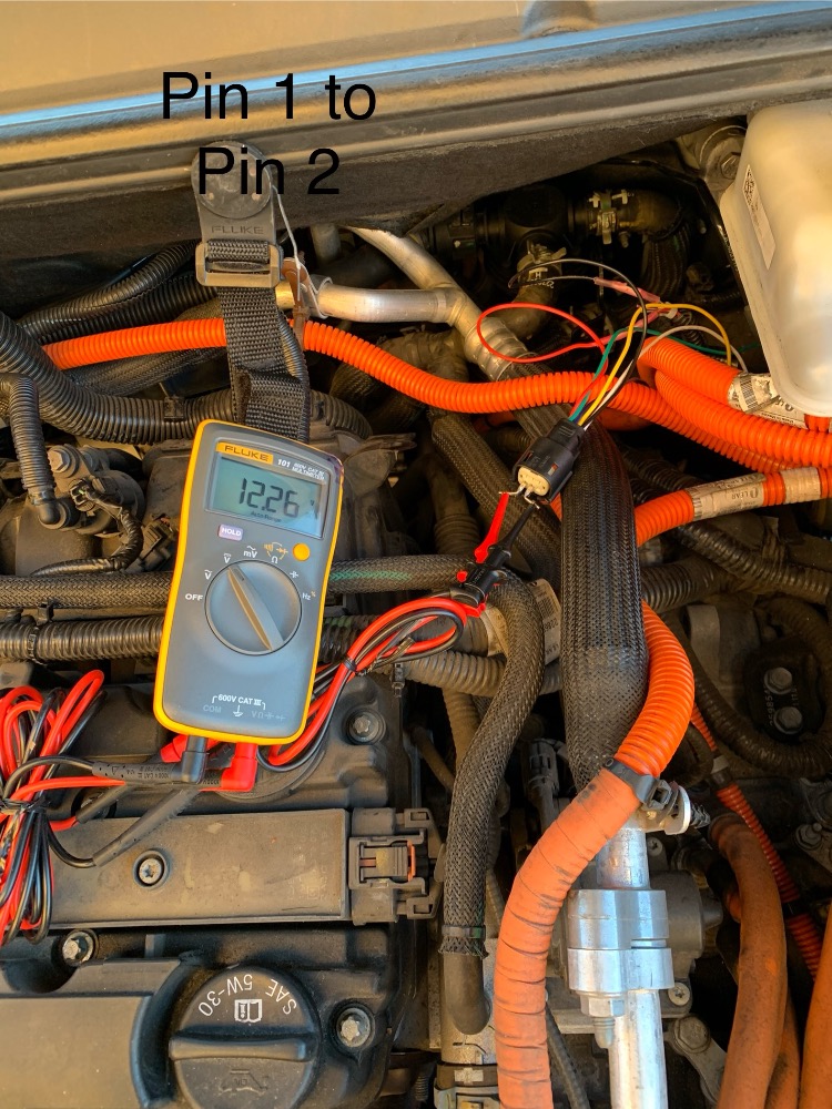

1. Pin 1 to Pin 2 and got 12.26V disconnected in service mode
2. Pin 1 B+ power to Pin 6 (ground) plugged in and backprobed 11.87 V
3. Pin 3 to Pin 6 in service mode plugged in 5.026
On some test, I turned on the heater/fan and back probed the voltage ; it did not reduce at all or produce the heat icon on the display (Pin 3 to 6 5v , Pin 1 to 6 11.87).
Can run more if needed, don’t mind checking thoroughly.
How long did you leave the light bulb installed between pin #1 and #2? Asking because service info specified that it may take up to five seconds for the bulb to illuminate. Were you in service mode?
Like ferris48, I'm also a little concerned about the use of the headlight bulb for that test. The HPCM2 driver probably isn't designed to carry the 3-4A of current that bulb will draw. That doesn't mean damage happened, necessarily. I'm just not sure it's a valid test with that bulb.
Service info for your Volt specifies the use of the EL-35616-200 test lamp kit. From what I can tell, that's a normal incandescent test light. I don't own one, and I can't find any specs for current draw, but I'd guess it'll draw around 200 mA. You don't need the EL-35616 kit (I don't think they make them anymore), just something that draws a similar amount of current. Any of the OTC test lights you'll find on Amazon will be in that range.
Vehicle OFF : 0.04V
This is... good? But also backwards.   Because you're using your meter to test from power to #5125, your reading of 11.89V would suggest that the HPCM2 is switching #5125 to ground like it should. The reading was zero with the vehicle off, which would suggest #5125 isn't shorted to ground.
You did this test at least once after you installed the headlight across pin #1 and #2, right? That would suggest that the HPCM2 driver still works. Or, it suggests that HPCM2 is still trying, anyway.
