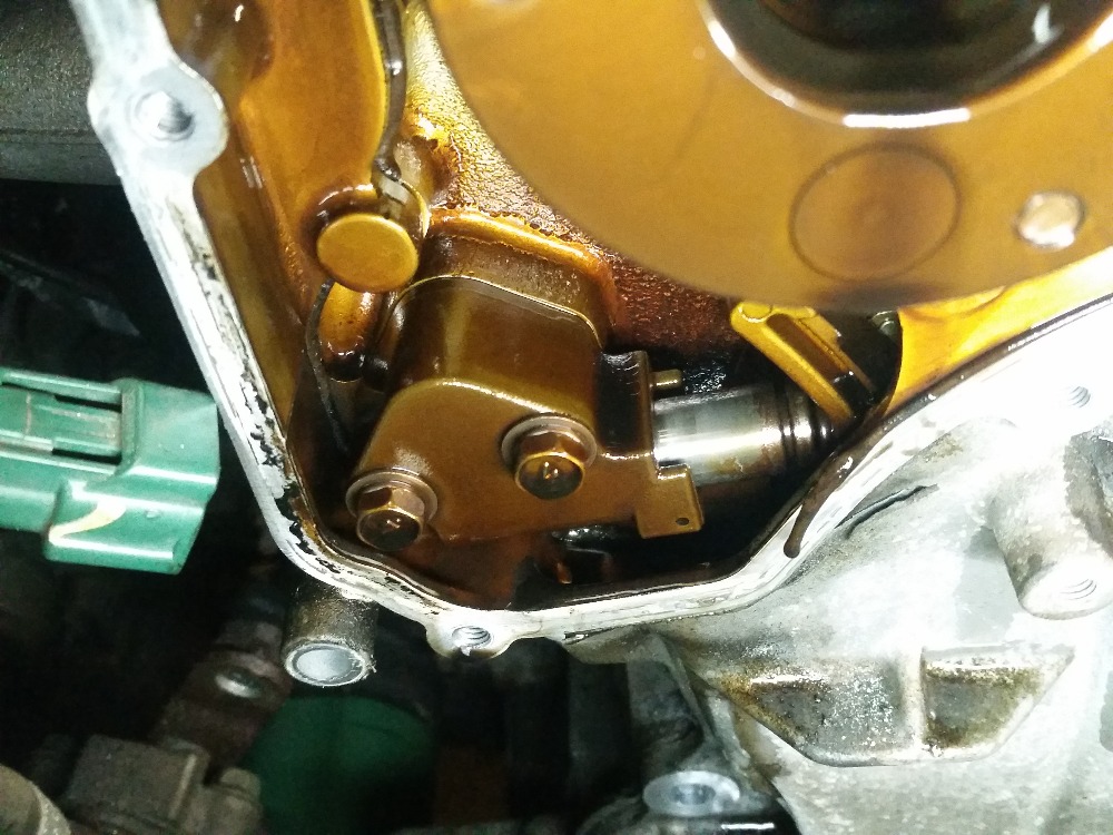

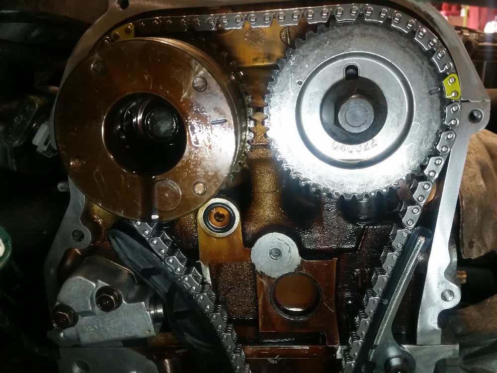

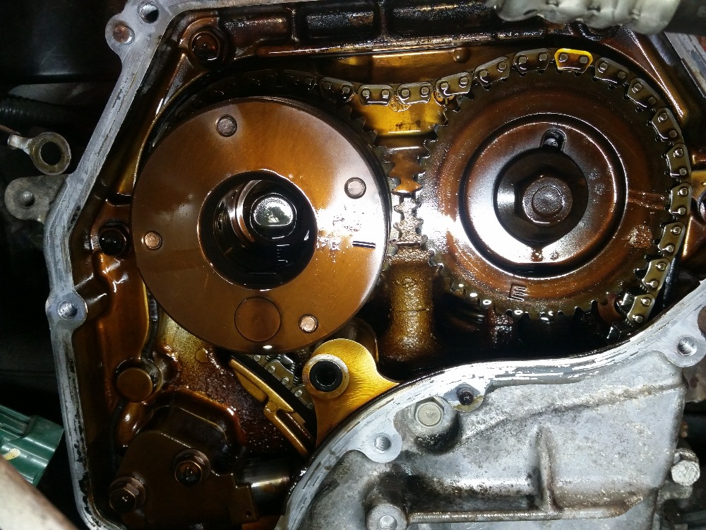

8 years 9 months ago - 8 years 9 months ago #16869 by graywave
Took some pictures in the early stages. Looking like a loose chain to me. Tensioner seems fully extended. Tomorrow I"ll finish the job. I have to check on AllData / Mitchel to see exactly what marks on the crank shaft to look at but the "dot" on the crank shaft doesn't seem to line up 100% with the orange link. Almost looks one tooth off. Didn't have a picture of that.

8 years 9 months ago - 8 years 9 months ago #16877 by Tyler
Holy crap, that tensioner is WAY extended. :ohmy: For fun and games, compare the chain to the new one when you get it apart. The old one will probably be a foot longer. :lol:

8 years 9 months ago #16885 by juergen.scholl
Thanks for the update and yes, the tensioner looks quite extended...

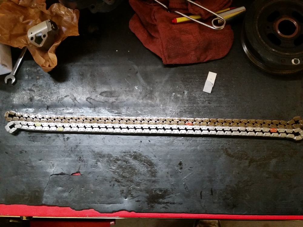

8 years 9 months ago - 8 years 9 months ago #16900 by graywave
Big Difference.
Comparisons.

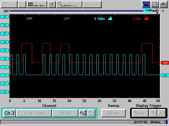

  • graywave
8 years 9 months ago - 8 years 9 months ago #16946 by graywave
!!CONFIRMED FIX!!
TIMING CHAIN and COMPONENTS
CONFIRMED ISSUE
WARN TIMING CHAIN and GEARS (EXCESSIVE SLACK)
INT/V TIM DEG PID is now 0 to -3 (Verse -24 to -36)
No Loss of Coil or Injector Control
Cam and Crank Correlation Waveform looks great

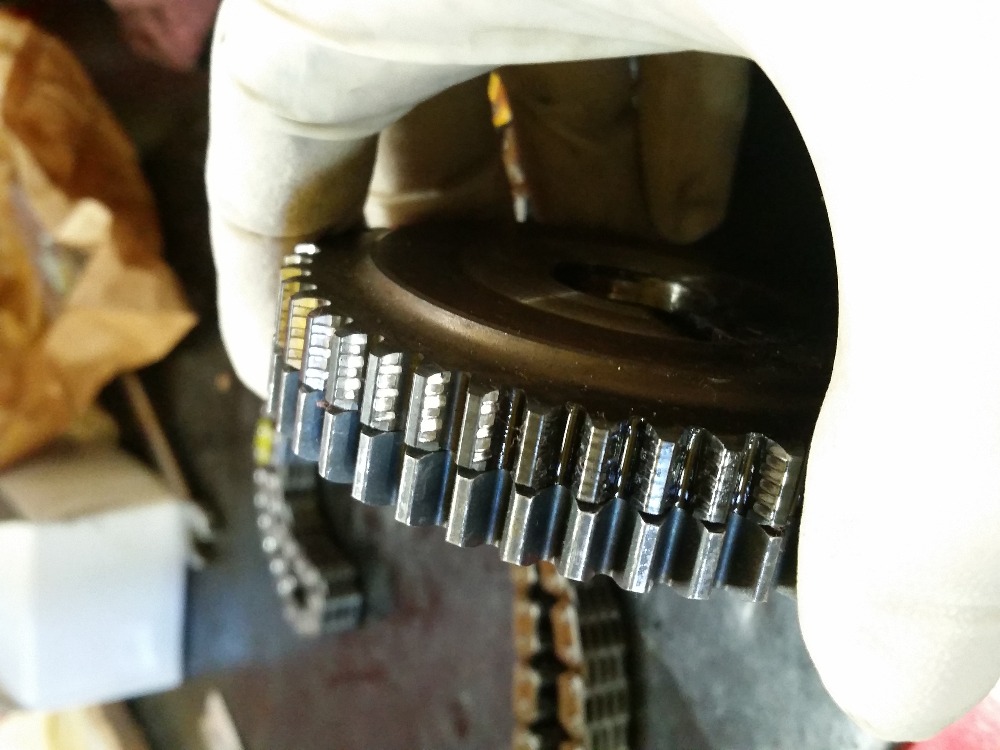

8 years 9 months ago #16995 by Pinto
I am just curious, did you replace the variable timing phaser on the left side as well?
  • graywave
8 years 9 months ago #16996 by graywave
No I left that alone along with the sprocket associated with it. That doesn't come with the time chain kits though I will say that it is not a bad idea to replace it. I think the sprocket and the phaser are one peace? I can't remember exactly. If not, it would be wise to change the gear as well. The one on this engine was just as chewed up as the on in the comparison picture for the exhaust cam. Even without replacing that though, the timing fell right into place.
There are various O-Rings to replace on the timing cover and engine block that don't come in the timing chain kits either.
8 years 9 months ago #17001 by Tyler
Great to hear, sir! :cheer: That chain isn't as stretched as I guessed, but you can definitely see the wear in the sprockets. Maybe THAT'S the real issue? :huh:
Whatever, a fix is a fix. B)
  • graywave
8 years 9 months ago #17005 by graywave
I think its just a combination of everything that wears. The chain was stretched and the gears were warn, probably everything contributed to the slack in the chain system.
