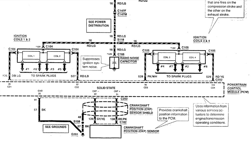

1999 Ford Explorer 4.0 OHV (pushrod) V6 - Engine won't start - has no spark, and I'm 99% sure it's a bad ECM. I'm just looking for confirmation, or if there's anything I missed.
The engine cranks over fine; it just doesn't start. It's not a fuel issue because I can hear the pump turn on when I turn the ignition on, and I hooked up my fuel pressure tester and I get 65 psi at the fuel rail. Also not a PATS issue as the theft light does not blink rapidly when cranking and there are no codes for PATS.
I hooked up a spark tester to one of the plug wires and there's no spark. Plugs and wires are new. I tested the coil pack by checking the resistance on the primary and secondary sides and it's within spec. I even threw another coil on just to be sure and still no spark.
Then I checked the connector that plugs into the coil. One of the pins has +12V like it should. I used an LED test light to see if the computer grounds out the other pins while cranking the engine. No flashing light, no signal from the computer.
The computer tells the coil to fire when it senses the engine is cranking. It knows when the engine is cranking when the crankshaft position sensor sees the crank rotating. So, the crank sensor was my next suspect. It's worth noting that the tach doesn't move at all while cranking, and the live data on my scanner shows 0 rpm while cranking. I know the computer is turning on because the check engine light turns on, the fuel pump turns on, and my scanner communicates with it when the ignition is on.
So at this point I have the problem narrowed down to either a bad crank sensor, a bad computer, or a problem with the wiring between the crank sensor and computer. (Unless I'm missing something?)
Then, I replaced the crank sensor and still no spark. I even replaced it again (with a Motorcraft part), thinking maybe I got a defective new one. Still no start. I think i can cross bad crank sensor off the list.
I found a pinout of the ECM online, found which wires at the ECM connector go to the crank sensor, and checked for continuity at either end of the wires. I have good continuity. Cross wiring problem off the list.
The only thing left is a bad ECM. Does everyone agree with my diagnosis? Anything else it could be?

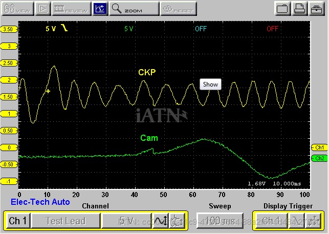

Exranger06 wrote: Ok, so the check engine light stays on while cranking. The DPFE sensor connector has 5V on two of the three pins.
OK, nice! The PCM still isn't seeing an RPM signal. Seeing two 5V pins at the DPFE is what I hoped for, as it uses a bias line on the signal wire. Totally normal.
Pretty sure this engine will run without the camshaft position sensor, so I'm not too worried about that. I think the next step is some CKP voltage measurements at the PCM during cranking. I know you installed a new OE sensor, AND tested the wires, but there's still something wrong here.
For reference, I grabbed a known good cranking CKP waveform from iATN:
I know that Exranger06 knows which pins to test at the PCM, but here's a circuit diagram for anyone else following along:
If you haven't seen it already, this ScannerDanner video demonstrates what we're looking for perfectly. Different engine, but the design of the sensor is identical.
Not sure if you have a scope available. If not, not a problem, your DVOM will work just fine. Connect your test leads across both backprobes and switch the DVOM to AC voltage. Crank the engine and look for a reading. How much voltage you'll see will depend on cranking speed, but I'd *guess* you're looking for around 500mV. Obviously, 0V would represent a problem.
The design of this sensor circuit is somewhat unique (read: weird), so please don't hesitate to ask questions about doing this test!
