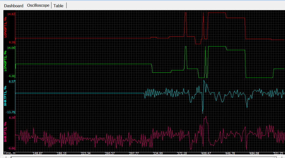

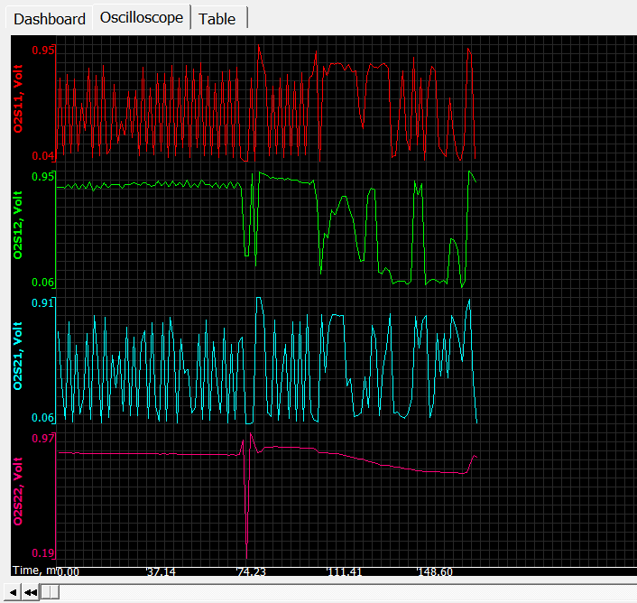

After watching the excellent videos on fuel trim analysis I was set to find the cause of my codes. But the charts look normal to the best of my understanding.
In the fuel trim charts up to the marker at 372 seconds the engine was idle. The spike in LTFT both banks immediately after is when i briefly went WOT. Then the rest of the chart is at ~2000RPM and just before marker 484 back to idle.
On the O2 sensors voltage chart engine is idle up to second 74. Then a snap of the pedal and hold at ~2000RPM.
The freeze frame is always at RPM > 1500, with both LTFT values at 15% and different STFT values, lowest I saw 10%, highest 21% all positive of course.
Fuel pressure is good and vacuum leaks not obvious, though I haven't done a smoke test. MAF appears to read reasonable values, 0.4V @idle, 3.8V @WOT.
Thanks
8 years 10 months ago #15948 by Tyler
Replied by Tyler on topic 2002 MAZDA MPV P0171, P0174, P0151
Hey adrian! Do you recall what the coolant temp was when these captures were taken? Mostly wondering if there's an intake leak that's getting better with engine temperature. While we're talking about vacuum leaks, these engines are known for leaking rubber PCV elbows. They like to collapse and suck air, but don't always show on a smoke test, and may not be audible.
The MAF going to 3.8V at WOT is a bit low... Would it be possible to watch the upstream O2 sensor and trims while doing a WOT run in first and second gears? That'll tell us a ton about the fuel system and the MAF.

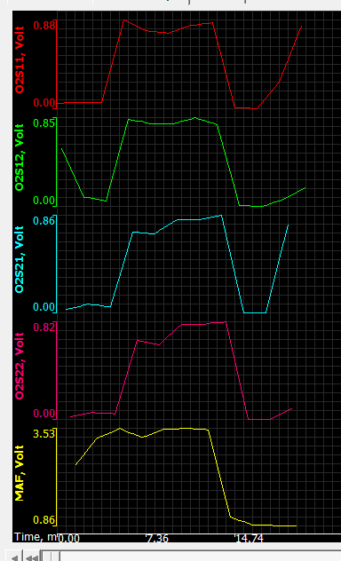

8 years 10 months ago #15962 by adrian.c
Replied by adrian.c on topic 2002 MAZDA MPV P0171, P0174, P0151
Hi Tyler, thanks for responding!
The engine was warm but had not been driven when I took those traces.
As far as the PCV hose and elbow they were replaced about two years ago and still look pretty healthy; at the time when they failed the symptom was a very rough idle, and now the car idles nicely. I'm not saying there's no vacuum leak, just relating past information.
I got a trace of the O2 levels and MAF while flooring the accelerator. About a second after it went in third gear I eased off the gas, see below.
8 years 10 months ago #16014 by Ben
Replied by Ben on topic Re:2002 MAZDA MPV P0171, P0174, P0151
Hey Adrian the o2s look good which suggest fuel system is good I see were only getting 3.5v on the maf which is a little low can you view grams on the maf signal at idle with a warm engine? It appears that the maf sensor needs a good cleaning. What engine is in this? does it have intake runners?
8 years 10 months ago #16035 by Tyler
Replied by Tyler on topic Re:2002 MAZDA MPV P0171, P0174, P0151
Thanks for the capture! I'm with Ben, the MAF is definitely low. Cleaning is a great suggestion, follow by resetting the KAM and doing another WOT run.

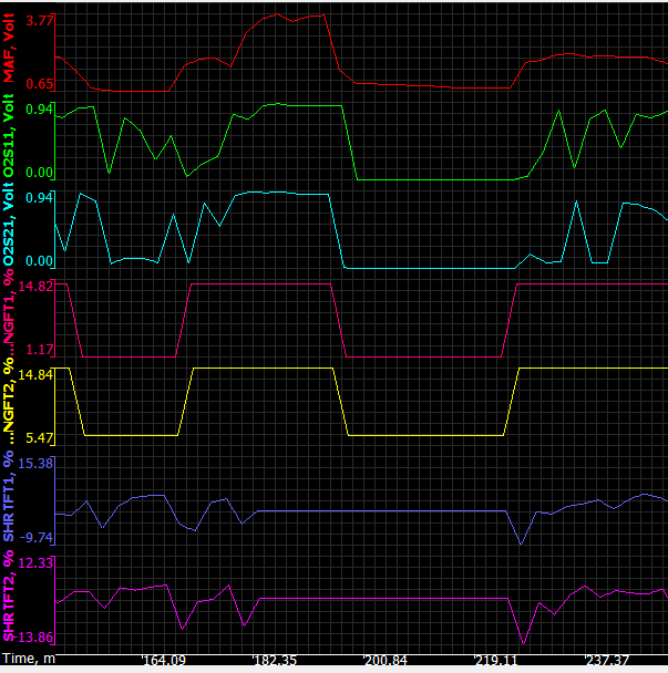

Below is the plot of the MAF, front O2 sensors, LTFT and STFT in order from top down, the WOT event is at marker 182 on the timeline.
8 years 9 months ago #16361 by Tyler
Ah dang, that's kinda disappointing. :angry: I mean, I'm happy for the improvement! But there's clearly more to do. Just to be clear, the DTCs still come back after clearing them, correct?
As far as clearing the KAM, you can always go for the classic battery disconnect and have a cup 'o coffee. That'll reset the KAM, trims, and the idle strategy, too. So, don't be surprised if the idle is uncertain on first startup. I know the mobile version of FORScan won't reset KAM, not certain if the PC version will or not.

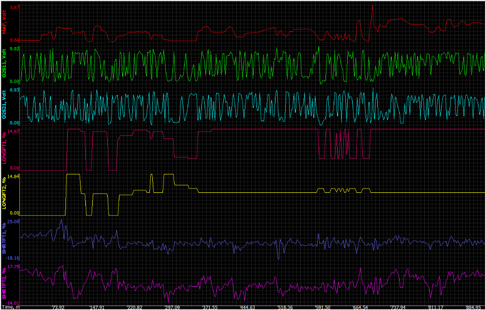

8 years 9 months ago #16529 by adrian.c
Sorry for the late reply, I took a trace right after the KAM reset on my first drive being curios to see how the trims looked; indeed they both started at 0 and began adjusting as I drove the car. Also the MAF peak reading is 3.87V, a bit higher than my previous one.
I don't know if it's my imagination but I even think there is more power to the engine than before, especially when I'm on an uphill and I hold the pedal observing how much speed it drops.
You're so awesome to tele-diagnose a car like this!
8 years 9 months ago #16536 by Tyler
Thanks for the update. :cheer: The long terms are still higher than I'd like, but at least the codes are gone! I see that the MAF max voltage definitely improved, but it still seems a bit low. :unsure: I don't have any captures from a Mazda MPV, but looking at other 3.0L Duratec engines from around the same year all show the MAF going over 4.0V on WOT.
Maybe I'm just nitpicking? :silly: I can't say it's enough justification to replace the MAF, especially since the codes are now gone. Either that, or there's a genuine breathing issue, and I tend to doubt that since you note that the engine seems to have plenty of power.
