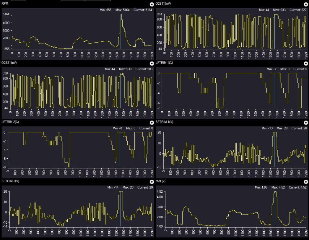

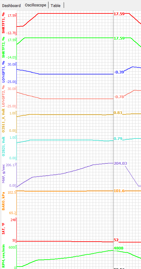

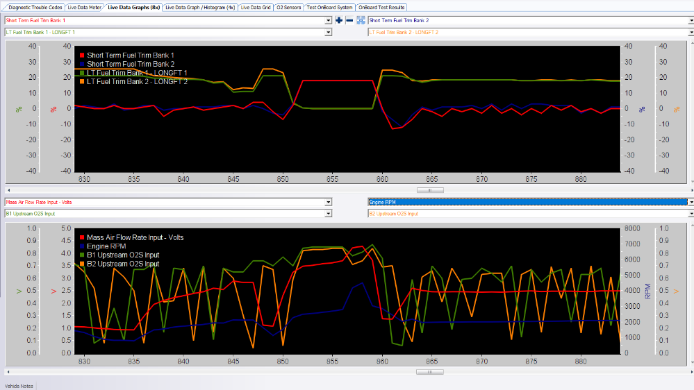

8 years 11 months ago - 8 years 7 months ago #15206 by Charles Acosta
Hello. At the 850 mark I start to go WOT. MY short term is climbing 20% on both banks which tells me its a rich command for a lean condition and its happening at the moment of WOT not long term memory. If its a lack of fuel delivery why is the O2 going rich not lean? Could it be ignition misfire? Thanks.

8 years 11 months ago #15210 by Andy.MacFadyen
Replied by Andy.MacFadyen on topic Fuel Trims Analyzing
Under sudden WOT acceleration close loop control is ignored
When the throttle suddenly goes wide open a huge gulp of air enters the inlet, the pressure in the manifold rises close to atmospheric, the mass of air entering each cylinder increases, the compression pressure increases as a result the engine computer has to compensate very quickly.
Back in the days of carbs this correction was done by device in the carb called an accelerator pump that squirted a surprisingly large amount of fuel into the intake venturi when the throttle was moved.

8 years 11 months ago #15217 by EricGoodrich
Replied by EricGoodrich on topic Fuel Trims Analyzing
a sudden WOT is a good way to test the ability of an O2 sensor to react to a deficiency of oxygen.

8 years 11 months ago - 8 years 11 months ago #15222 by Andy.MacFadyen
EricGoodrich wrote: a sudden WOT is a good way to test the ability of an O2 sensor to react to a deficiency of oxygen.
Yes - Just repeated very quick fluttering the the throttle at idle only moving the pedal 1/4" to 1/2" can drive the upstream O2 rich and give you a good idea if the sensors are working and the CAT is up to the job.
On road test if you have a suitable road to do it safely holding full throttle, then completely lifting off to get injector cut off is also a good test.
8 years 11 months ago #15223 by Tyler
Replied by Tyler on topic Fuel Trims Analyzing
Don't worry at all about the 20% short term trims at WOT - most Ford's I've seen from that era behave the exact same way. This '02 Crown Vic, for example:
I think you can absolutely rule out fuel delivery for now, with the O2's going full rich at wide open. The MAF going over 4.0V also suggests that the MAF is OK, and there are no volumetric efficiency issues. I also see that the long term trims improve slightly around frame 835, when you first get on the throttle, so I think you're on the right track with your vacuum leak diagnosis. ;-)

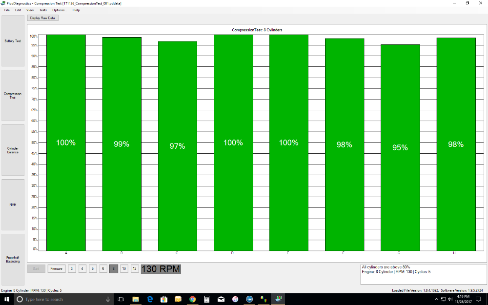

8 years 11 months ago #15293 by Charles Acosta
Replied by Charles Acosta on topic Fuel Trims Analyzing
UPDATE
So yesterday I finished installing lower, upper, front and rear seals gaskets. Smoked the intake and no smoke visible except for smoke coming out under port holes from the EGR valve. I reset the KAM and and started the engine. My LTFT went up to 23 & 28% immediately. At idle and at 2500 rpm I could not get the trims to improve.Yet driving and giving it some throttle the trims improve. I smoke the intake again to make sure I didn't miss anything the first time. To rule out the EGR valve I sprayed carb clean into it and the O2 and STFT didn't go rich at all. Upset about putting all those hours spent installing those gaskets I packed it in and took my family in my truck to drive 20 miles to a party.
This morning i setup my scan tool and do a cold engine start and noticed a 4% trim improvement at idle. Woohoo LOL! Again I could not get the numbers to improve at higher rpm at idle but improve when I drive as the image capture will show.
Did a compression test
Took a fuel pressure reading and it was at 64 psi and within spec. Snap throttle and idling held at 64 psi even though I have a bad check valve when the engine is off the pressure bleeds off.
Idling trim data is telling me fuel delivery. Driving trim data is telling me vacuum leak. O2s going rich at WOT. No smoke coming from the intake and PCV crankcase. I know this computer is going to throw me a pending lean codes soon and inspection sticker due next month. Can't diagnose the problem.

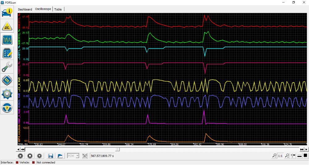

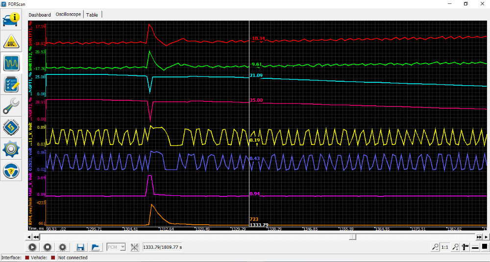

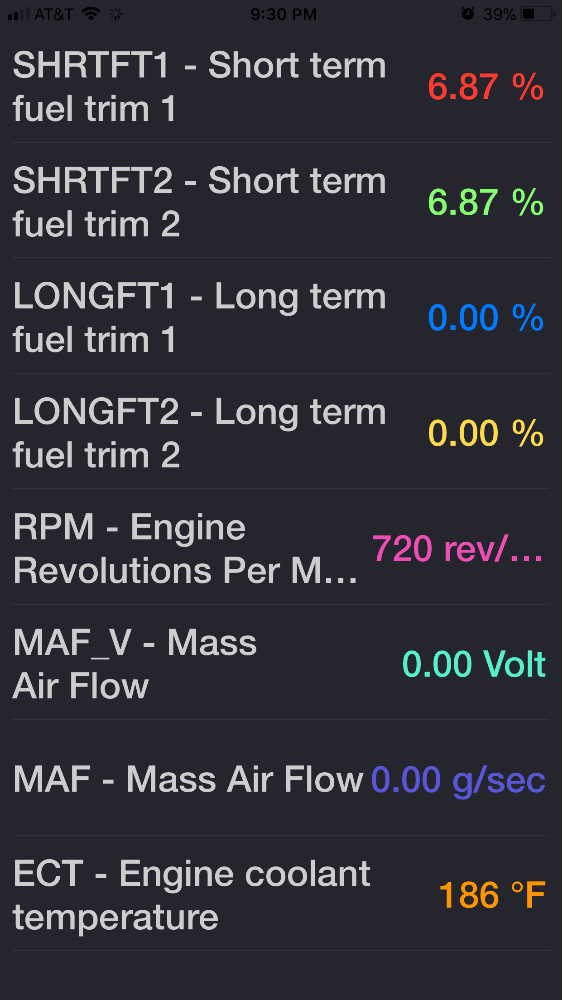

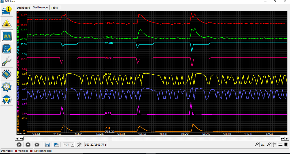

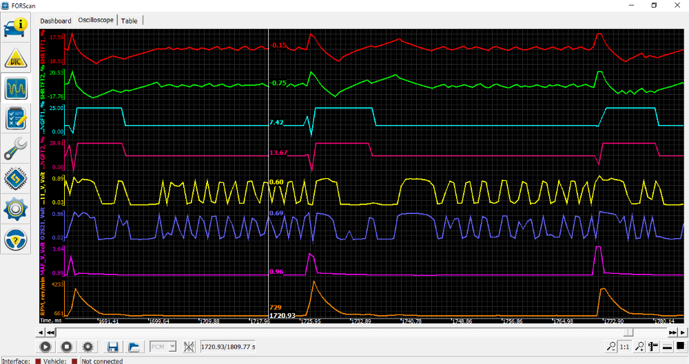

8 years 10 months ago #15388 by Charles Acosta
Update
So I removed the brake booster hose and plugged the hose with a vacuum gauge. As you can see the image below I have 28% and 25% at engine startup with no improvement with the brake booster disconnected.
Snapping the throttle long term goes down indicating vacuum leak.
I then blipped the throttle and noticed after doing so the short term goes negative at both banks. Otherwise I think and I might be wrong ,no reaction in the short term would've not happened if I didn't blipped the throttle.
While the short term is negative the long term doesn't react until seven or eight minutes later.
Look at the trims now. A vast improvement.
This is short lived because when i turned off the engine and started it up again 10 minutes later my long term was 23% and 18%. idling for five minutes the long term was not changing until I blipped the throttle several times in which the short term reacted bringing the long term to 14 & 10%.
Don/t know if it's coincedence or not but fuel trims improve while blipping the throttle during idle, Done it twice now. What could be cause this? Thanks.

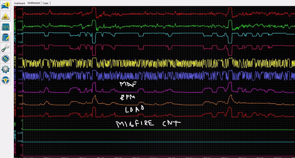

8 years 10 months ago #15758 by Charles Acosta

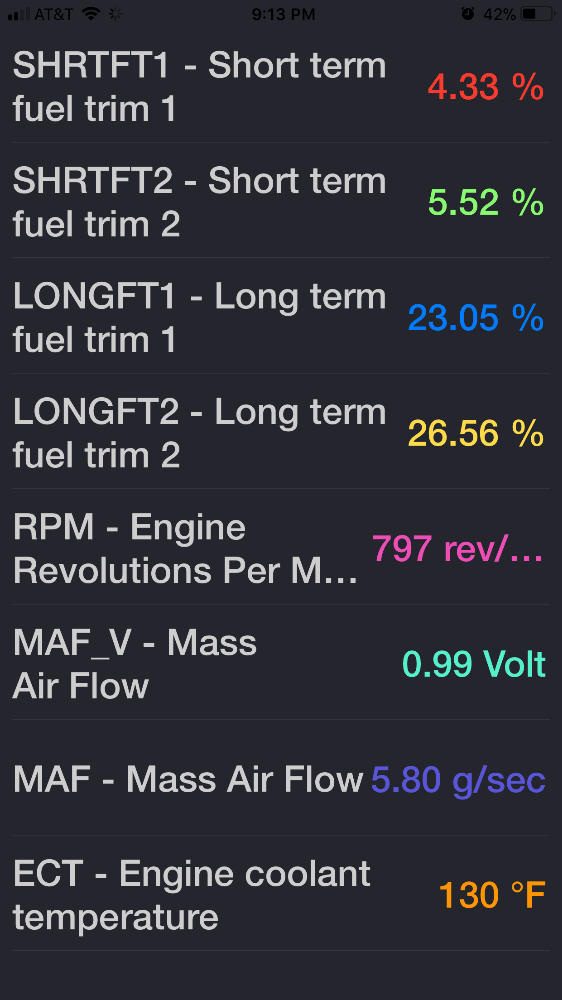

I'm still trying to figure out this lean condition when not busy from work. I bought the VE calculator from AES wave. Don't know if I'm understanding the help file. It says high RPM and high MAF g/s at WOT. I've also seen Paul's video. So before I plug in these numbers I'll show two captures and tell me which data to put in. Purple graph is MAF and green is RPM.
Is it A:
Is it B:
Or C:
Do I take the highest MAF from one capture and the highest RPM from another capture and put them in the calculator?
Thanks.

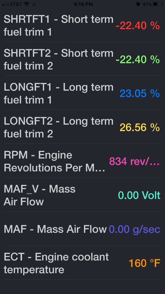

  • graywave
  • graywave's Avatar
8 years 10 months ago - 8 years 10 months ago #15850 by graywave
Replied by graywave on topic Fuel Trims Analyzing
EDIT - I didn't realize this thread continued further. Well maybe there is info in my post that will help if its not figured out yet.
I'm concerned about smoke coming from the EGR. That should be shut completely when smoking the intake. If it were me I would take a closer look at the EGR or the EGR Gasket. I know you mentioned spraying carb clean around it but I don't always have 100% success with that test, in fact, maybe only a handfull of times I have had success with that. Prime example on a 07 Corolla 1.8L. No change to AFR Sensor at all or even idle speed when spraying brake clean everywhere. Though replacing intake gasket, cleaning o-ring and matting surface on throttle body and cleaning matting surface for intake tube to t-body and cleaning throttle body brought the fuel trims back down around 7% instead of +14,+18 & +20 I was seeing at random times during idle between ST/LT FT
You mentioned your LTFT went to 23-28% immediately even after resetting the KAM. How soon after startup? How long was STFT high and how high was STFT after LTFT learned new trim numbers? I am wondering if the fuel trims never were erased for some reason. I remember a ford I was working on years ago, the scan tool offered a "fuel trim reset" option on a I think 99 or very early 2000s F150 with a shorted stuck rich O2. Maybe try that or disconnecting the battery and shorting out the NEG and POS leads together.

  • graywave
  • graywave's Avatar

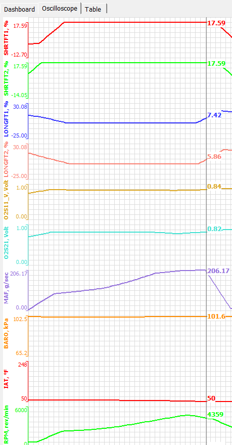

8 years 10 months ago - 8 years 10 months ago #15852 by graywave
In your screen capture linked below, I see very negative STFTs with High LTFTs. Its correcting for awhile, not completely but its correcting partially. This is where a fuel trim reset would come in handy to whip out long terms.
www.scannerdanner.com/media/kunena/attac...hot18_2017-11-29.png
