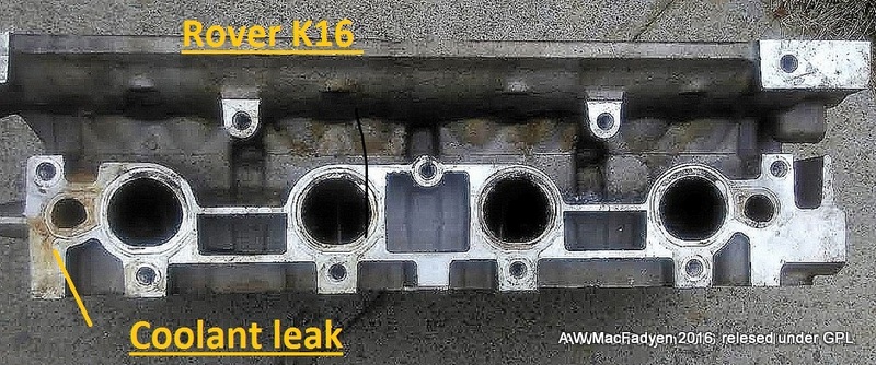

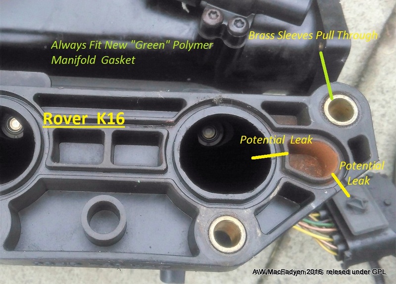

On the Freelander 1 on all engine types the coolant tank caps are always suspect I pressure test them insitu ---- if it is the 4 cylinder K16 1.8 there is a fair chance it is inlet manifold gasket.

9 years 11 months ago - 9 years 11 months ago #1760 by Andy.MacFadyen
Replied by Andy.MacFadyen on topic Heater core?
A couple of shots of fairly typical inlet K16 leaks --- very hard to spot
9 years 11 months ago - 9 years 11 months ago #1761 by Andy.MacFadyen
Note rust trace on cylinder head.
