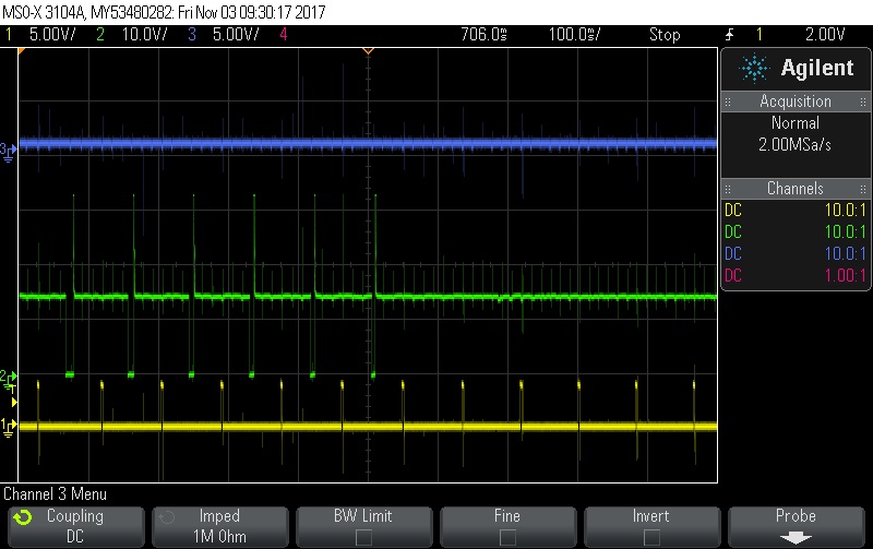

8 years 11 months ago #14443 by jack260
Replied by jack260 on topic 2007 Lexus ES350 won't stay running
I've got a better scope trace attached. Trace 1 (yellow) is the IGT signal for coil 6. Trace 2 is the Injector signal for what I believe is cylinder 6. Trace 3 is the IGF signal common to all coils. It looks non-existent! What should it look like? Could it have high resistance short to ground?
  • jack260
  • jack260's Avatar Topic Author
8 years 11 months ago #14444 by jack260
HA! Problem solved!
When I couldn't get a signal on the IGF line, I unplugged the ignition coils one at a time and measured the resistance from the IGF pin to ground. The first 2 were in the megohm range, but the 3rd was 16.5 kohms. I left it unplugged and the car started & ran on 5 cylinders. Obviously that one was dragging the IGF line down causing the ECU to shut down the engine.
Thanks to all for your help and suggestions.

8 years 11 months ago #14446 by juergen.scholl
Replied by juergen.scholl on topic 2007 Lexus ES350 won't stay running
The IGF signal is a 0 to 5 volt square wave similar to the IGT signal. It should start almost immeaditly after the IGT signal starts to rise, maybe 2 ms later or so.
As each coil produces it's IGF signal on its own it is very improbable that all coils started to fail at once- check the IGF wire for a short to ground and also the continuity of this wire to the ecm (although an open in this wire would not take out the signal...) Also have a close look at the respective grounds for the coils.
There is a chance that one coil is shorted internally and hence the IGF circuit is dead. You can disconnect the coils one by one and check wether the IGF signal comes back .
Another option is to cut an IGF signal wire at one coil and then check with the scope on the coil side of the cut wire for a IGF signal. That way u can test coil by coil just connecting one by one to the connector with the cut wire.
