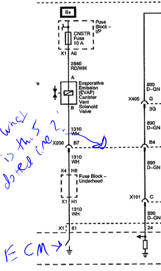

I'll working on a 3.5 impala that has a evap vent valve circuit code (can't remember which one off hand now) and here's where I'm at.
Bench tested the valve, got a slight click but no valve movement. Harness has 12v both when I bi-directionally open and close the valve. No change in voltage. Load pro indicates massive voltage drop in the circuit.
Am I looking for a short to ground here or could it be a computer issue that is applying a constant ground. The voltage drop is what has me thinking a short though.
Does it sound like I'm on track with this?

Wiring diagram shows Red/White wire is 12v from a fuse and the white wire is ground controlled by the PCM
8 years 11 months ago #14467 by bruce.oliver
Replied by bruce.oliver on topic Re:RE: Re:RE: Re:2008 Impala vent circuit
If you have ground on the white wire all the time, the wire could be shorted to ground

I've got the car back again now to figure this one out. I had some incorrect information that I provided earlier on. The voltage drop is on the ground wire. I have 12v when I replace the solenoid but not enough to make my test light shine. I'm confident the voltage drop is on the ground wire. Finding it is killing me though. What are some likely places to look here?

8 years 11 months ago #15023 by Tyler
Replied by Tyler on topic 2008 Impala vent circuit
X200 is a bulk connector, and the dotted line means all those wires are in the same connector. I don't know for certain, but I think X200 is an eight or ten pin connector that plugs into the body, near the right rear wheel. That same connector will have the fuel pump and fuel tank pressure sensor wiring in it, too.
I've never seen an issue with X200, so my guess would be that you're gonna find a wiring issue within a few inches of the vent valve connector.
