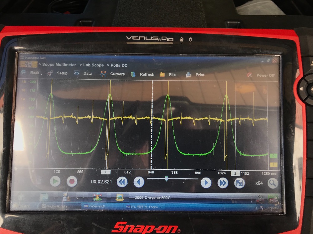

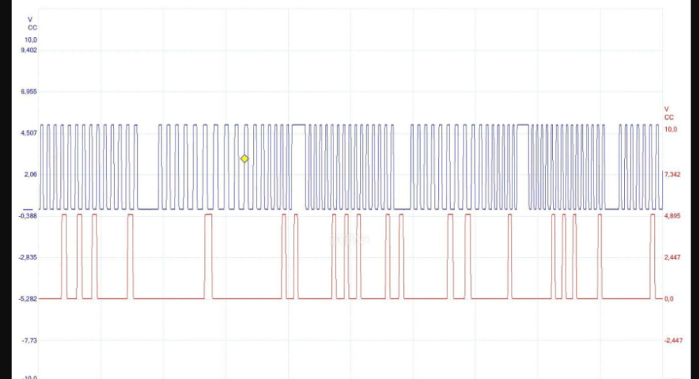

Good Morning everybody! I was wondering if anyone on here has a known good cam/crank waveform for a 2006 Chrysler 300 with a 5.7 L.
If anyone does and could share I would appreciate it very much.
Thanks!
Nandor

Well that’s better than nothing. I’ll see how it matches up to this one. I know there is a possibility it’s not the right one but I’ll see

Timing chain broke right at tdc.

That engine is a valve bender, just finished putting a long block in a 2010 for the same thing, chain was broken. The OEM plastic guide broke. There is a TSB about it.

Thanks for the info. I was actually just looking that up for the guy that will be doing the work on it. I seen about 50/50 people saying it was or wasent.
I’ll let him know about the tsb
