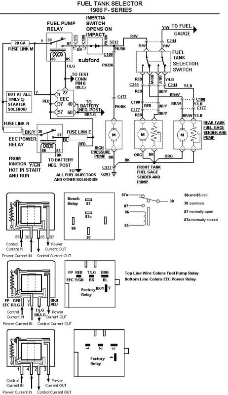

Hi,
Looking at doing a EEC/Fuel Pump relay upgrade on my 1989 F-150!
Have not found any SPECIFIC info on this as to an exact model of BOSCH Relay to use?
I ASSUME a BOSCH 40 amp, 4 pin relay,, with matching connector, would work???
If anyone has any ideas on this, I'm all ears!

Bosch fuel pump relays are generally 30 amp there might be a 40 amp version for diesels.
Fuel pump relays should have an internal diode called a "flyback diode" that helps prevent the relay contacts arcing when it makes and breaks. Cheap general purpose relays usually don't have a diode.

Hi,
Thanks Andy!
I'm having a crank no start issue on my 89 f 150.
I'm putting 12V in to my EEC relay and only getting 4.9V out reference voltage off of the TPS is only 1.5V ! (Voltage Drop?)
I'm going for now to put a BWD (Borg Warner) new connecter in.
The relay is a brand new Motorcraft!
Hope this fixes the no start problem?
Just looking at going to better relays on the EEC and fuel pump for this truck but not finding a lot of info on this upgrade???
Thanks again!

Hey seagiant! Where did you learn about this relay upgrade? Honestly curious, I've never heard of it before. :huh: When I've run into voltage drop problems on these relays in the past, I've just replace the relay and connector together. I also add some weatherproofing to the relay connectors, to (hopefully) prevent future failures.

Hi Tyler,
I've seen it mentioned on other forums.
I guess what guys are doing is going to JY's and getting BOSCH type relays, from 92-96 year trucks and then just wiring them in with new female spades (no connector!)
I'm going to stay with the old type (oem) connector for now, as I have enough on my plate trying to get this truck to start?
I am hoping with the new Borg Warner (BWD) connector I get rid of the voltage drop and the truck runs again!
