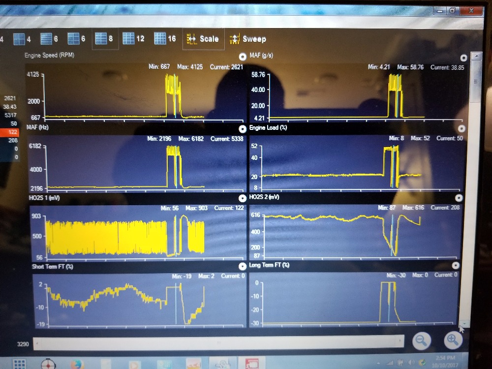

I added a Photo file that I uploaded to my laptop and took a screenshot of showing the MAF, Engine Load, o2 sensor data along with short and long term fuel trim from sitting at idle to also what happens when you go WOT from idle. IF you notice at idle the long term fuel trim sits at -30 while short term is at 0 .
The o2 sensor data numbers drop as well then rise back up.

It looks like the engine is getting a shed load of extra fuel at idle/low engine loads which id being fully corrected by the long term fuel trim.
I think it is a genuine over fuel condition rather than a faulty upstream O2.
Is the temperature reading from the scantool in the normal warm range ie 75c to 105c if reading below 75c it could be cold start enrichment. If running temperature read Okay then I would also look at the manifold vacuum reading.
Beyond that assuming you don't have a dead cylinder at idle I would look for a faulty (leaking) fuel pressure regulator or an injector problem

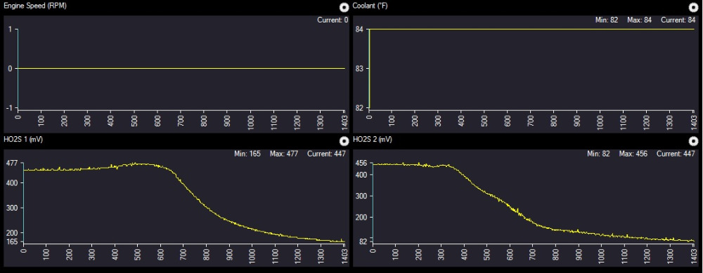

Hey Dtnel! For the record, when the Modis first came out, they DID let you look at all saved files. ;-) Even if you had 200+ saved. The problem was that it bogged down badly when you hit "View Saved Data", so Snappy introduced the 50 file limit in one of their updates.
I watched your videos, much appreciated. :cheer: Definitely a lack of activity going on. The signal only really goes 100 or 200mV lower or higher than 450mV, showing a lack of amplitude. Honestly, the behavior of the signal reminds me of a downstream sensor with a dead heater. :lol: The sensor will try to switch back and forth, but just can't do it. FYI, the heater circuits are NOT electrically monitored on this vehicle, so this is a possibility. For reference, here's some data I took off a known good 2003 Chevrolet Venture with the same 3.4L engine.
With the cat lit off (warmed up), the downstream sensor should generally hang out around 600-700mV, with rich and lean swings during load changes. I can supply more data off this Venture if you're interested.
If you wanted to be double sure that your downstream sensor isn't working, you can always pull the brake booster hose off. By introducing a big vacuum leak, you should be able to get both O2's to swing below 100mV, no problem. I'm guessing that your downstream won't be able to.
Thankfully, the wiring checks are pretty straightforward. ;-)

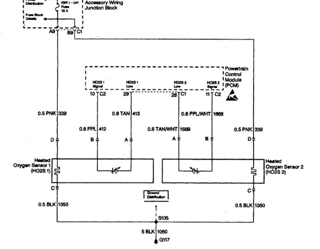

Pink should have 12V with the key on or running, black is a constant ground. Purple/white is the O2 signal, and tan/white is the sensor ground. For testing of the signal and ground, check out this video:

Andy, The Photo above is when I snap it to wide open throttle and it revs up and down and up and down.
I can't seem to find the Freeze Frame data from when the p0140 code set which would have been a separate deal then the photo taken above that I posted. I think I will get the component troubleshooter and do the checks on the other stuff that you mentioned as well.

Dtnel wrote: If I do take it for a drive and let it warm up first what data would it be more important for me to only include on a test drive so it's not putting unnecessary data in a record from a test drive. I did note on this Pontiac Montana compared to my 98 Toyota Camry the data stream moves much quicker from connecting to recording it throughout a drive.
Night and day difference, huh? :lol: You could probably watch 10 or 15 different PIDs on your Pontiac with no problem. The same ones you were watching before are perfect, but you could add a few other in if you wanted. ECT, MAP voltage, and EVAP Purge % are sometimes useful for diagnosing rich conditions.
If you're really interested in going in-depth with the scanner, you can monitor the O2's for heater operation the same way the PCM does. :cheer: This model uses a 'time to activity' test - on a cold startup, the PCM watches the O2 voltages carefully as the engine warms up. As the O2 heaters warm the sensors, the bias voltage of 450mV will gradually get pulled down to below 150mV or so, at which point the PCM knows the sensor is warmed up and ready to go. If the O2 signal doesn't go low within a set amount of time, it flags a code for the O2 heater. Chrysler used a very similar system on it's O2 heaters for many years:
After the car has sat overnight, turn the key on (don't start it), and watch both O2 signals. Both should start dropping lean after a minute or so. If one refuses to start dropping low, that's a sure sign of a dead heater. Here's an example of what you should see off a '99 Pontiac:

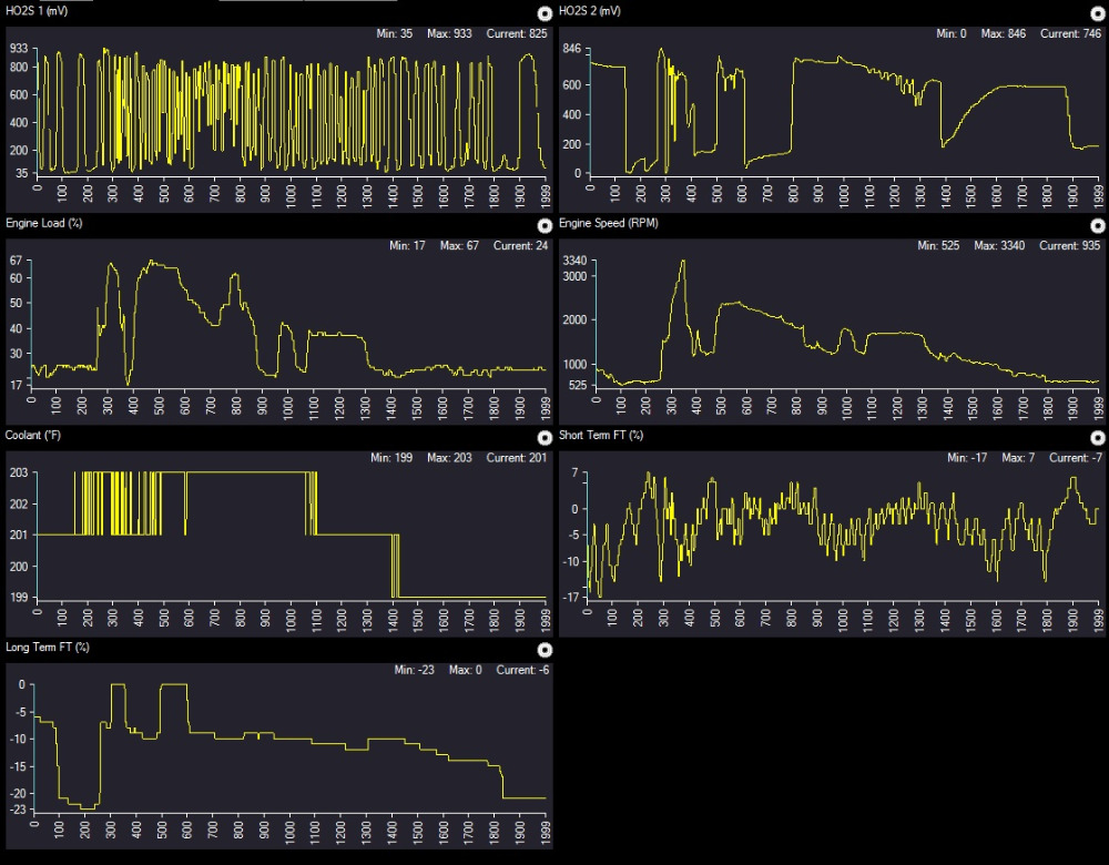

Did some poking around after swapping the rear O2 sensor. Still was acting the same. Reason I held off on upstream was I'm pretty sure I'm not going to be access the upstream sensor and I also think it's loading up as injector pushing to much fuel out because after I idle if I snap the throttle it's worse as in it sometime let's out a light backfire and seems as if it's sluggish to get the throttle going until it's through that and the rpms are at 2500 then with high rpms there's no sluggish.
Where it got worse was after I replaced not only the O2 sensor but the loading up came worse when I replaced the plastic portion of the PCV valve and went on ahead and slapped in a new PCV valve as I checked the movement of the one at the store versus the one I brought up the vehicle and the one I had on the vehicle was more sticky so to speak.
After I installed that PCV valve in the 90-degree boot to hook onto the pipe is where snapping the throttle made things worse and it was after the vehicle went into closed loop.
I did do a SCM file but that's another question I wanted to ask is I have the SCM file on my scan tool and can't put it onto my laptop and then how do I go about uploading the SCM file or are they files that are allowed to be uploaded to these forums where you guys can actually View the file in a format such as a video format or is there a way to add that file to some type of certain player and then link that to this forum to where you can click and watch a video of the scanner data instead of me having to use my phone to film the scanner.

Remember that snapping the throttle will momentarily force an open loop condition, which will change your fuel trim data and zero them out like we saw. This doesn't help give us any direction at all and is why I do not look at fuel trim numbers unless the throttle is being held at a steady angle.
Your -25% LTFT at idle only is suggesting an actual rich condition. But I didn't like the backfire you mentioned on the snap throttle, if it was an intake backfire, this suggests a lean condition. (opposite what trim numbers are telling us).
Do me a favor and look at the MAF honeycomb screen, is it there? Make sure someone didn't remove it. Second, at idle, remove the fuel vapor line from the canister purge valve and plug it off with your finger, then recheck fuel trim. Third, I want to see your upstream O2 sensor a little more at idle and 2500.
Forth, check that engine for a head gasket failure. (Coolant seeping into the engine will contaminate the O2, and cause false rich signals, negative trims, and actual lean conditions (backfire through intake).
