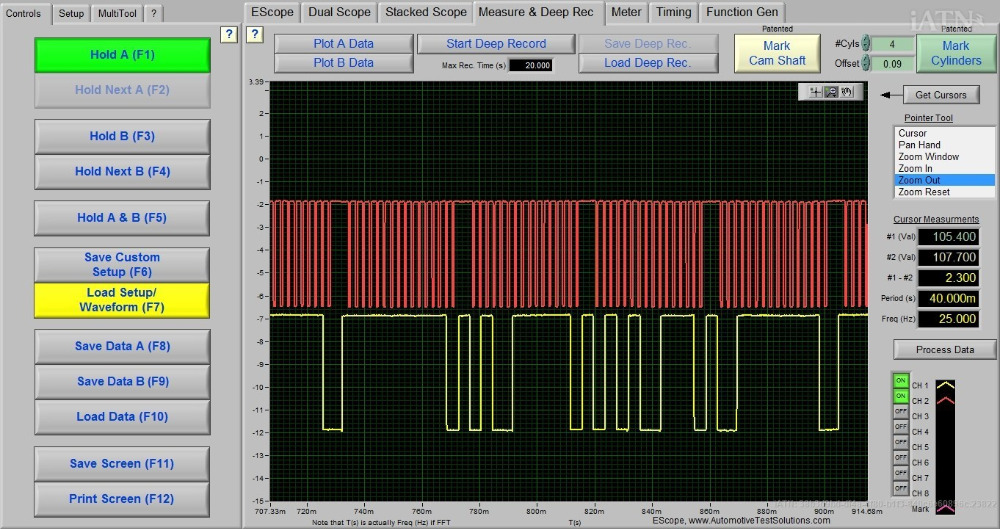

(Original post I accidently deleted during edit after fix): Can someone help me out with a good cam/crank waveform? I'm a DIYer trying to fix a family member's car. Thanks.

After fix:
