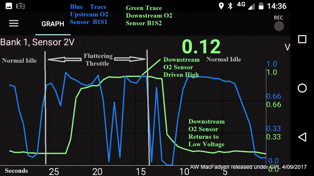

I tried searching the forum but didn't find anything. 2004 Honda CR-V LX 5 speed manual - check engine light recently came on, sometimes it turns off by itself, and sometimes it comes back on. I scanned for codes, and the only code that comes up is P0139 - O2 Sensor Circuit Slow Response (bank 1 sensor 2). Car runs perfectly fine, no drivability issues. I don't want to throw a new o2 sensor at it until I verify that that is the problem. What tests can I do to verify? I have an Equus 3160 scanner that can view live data.

The P0139 is a self-test generated by the engine computer as the engine reaches working temperature. The car in running fine because the downstream sensor on the car has not part in the control of the fuel injection. The job of the downstream sensor is simple to check if the cat convertor is doing its job.

This is how normal upstrem (Blue) and downstream (green) sensor repond to fluttering throttle pedal to drive the fueling rich and suddenly releasing the throttle to drive the exhaust lean. Fluttering the throttle is simple depressing the throttle about 1/2" on repeatedly for a few seconds to force the exhaust rich, then releasing it to force the exhaust lean. If durring the test you can't force the output voltage high (0.9v=rich) and return quickly low (0.1v = lean) then you have a slow or dead sensor. Again check the sensor heater wiring before swapping the sensor.

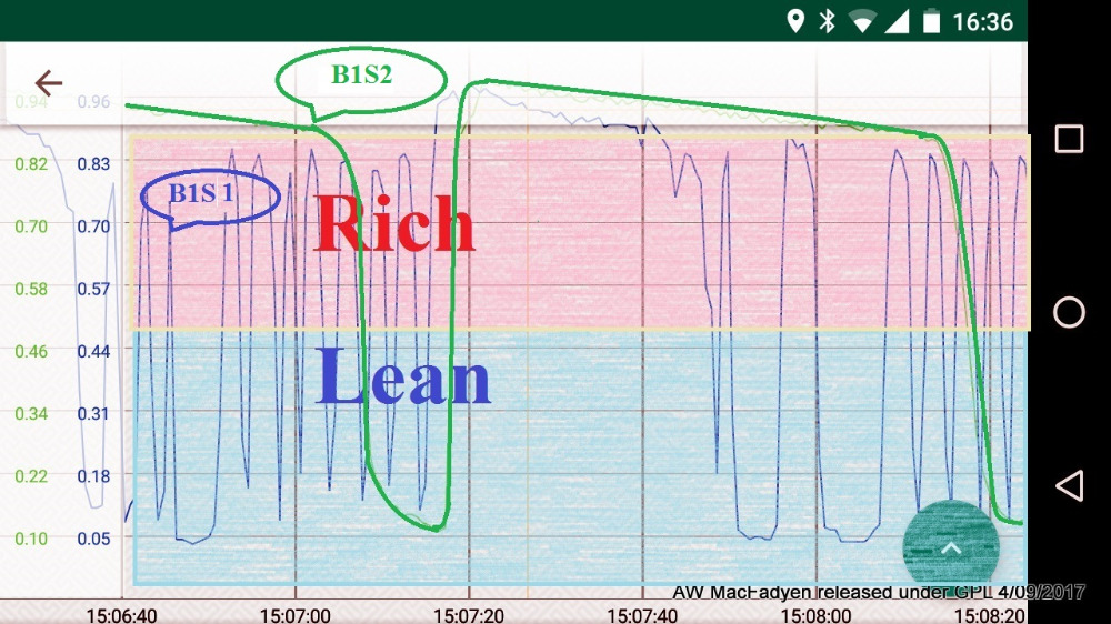

This garphic illustrates a normal Upstream and downstream O2 sensor response on a warm engine better.
By working the throttle a small ammount you can force the downstream O2 sensor rich (voltage around 0.9v) then rapidly lifting off and allowing the engine back to normal idle after a few seconds delay the downstream sensor should read lean (around 0.1v) . If by working the throttle you can't force the downstream sensor rich and then lean you a sensor issue.
