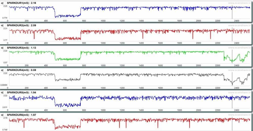

That was actually really cool because I found that out just by looking at some PIDS while sitting in the driver's seat. This is a 2006 Dodge 1500 with the 5.7L. In the engine data there is an ignition menu. It monitors the coils and has PIDS for each coil's dwell time as well as spark burn time. That's pretty cool! Right away I could see the number 6 coil had a problem. All coils had the same dwell time and all but the #6 had around 2.2ms burn time but the #6 was 0.2ms.
Do you recall which data list you found the coil burn times? I was doing plugs on a 5.7L in a 2012 Challenger today, wanted to look at some before and after data with the new plugs. Couldn't find the burn time PIDs, but that doesn't mean they weren't there :unsure:
Also, I remembered that I had a cool capture from a Mercury Mountaineer with spark duration PIDs. Just past frame 2200 is when I pulled a plug wire off the coil pack and manipulated the spark with a test light.
www.scanshare.io/share/LpF8BUxXqESsUm9pr0uPAw#4,5,6,7,8,9

Tyler wrote: Do you recall which data list you found the coil burn times? I was doing plugs on a 5.7L in a 2012 Challenger today, wanted to look at some before and after data with the new plugs. Couldn't find the burn time PIDs, but that doesn't mean they weren't there :unsure:
Yeah, on this Ram it was in a data list called Ignition. Didn't have too much else in there. Engine RPM, burn time and dwell times, end um... I think cam/crank sync states..? A couple others too that I can't remember.
That's a cool capture! I love capturing stuff when I'm trying to manually manipulate things.
