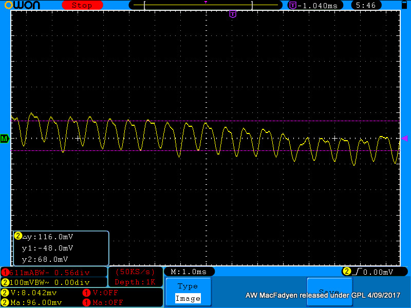

When you look at alternator ripple you get all sorts of noise from ignition and injectors and fuel pump also the charge voltage is continuously changing under the control of thevoltage regulator.
When looking at alternator ripple with a scope I use a high frequency filter to block spikes from the ignition and concentrate on looking for regular dropouts (missing peaks) or repeated odd looking peaks.
This capture fairly typical of a good working but high mileage Denso alternator, at idle with dip beam on 116mv ripple
