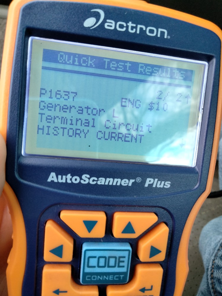

I have a 2002 Camaro 5.7 and I have a code P1637 for the alternator.  I noticed the red wire on the connector was broken off from the back of the alternator.  I replaced the connector and wire and code P1637 still appears.
I tested the charging system and it passed and no battery light comes on.
I used a test light to test the red wire from the alternator and the test light doesn't light.  Should there be full-time power on the red wire when the engine is running?

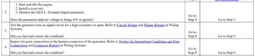

There's a key test provided in the P1637 flow chart:
Your Actron scanner won't have the 'GEN L–Terminal Signal' PID, but you can still check for voltage on the red wire, alternator plugged in and engine idling.

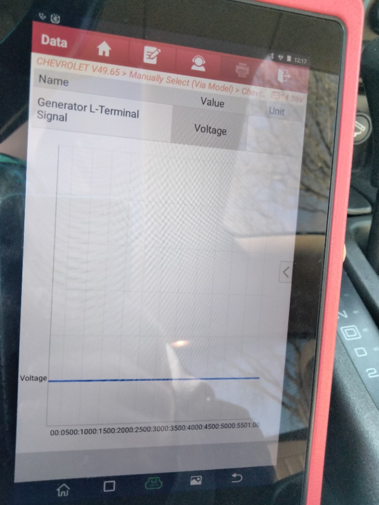

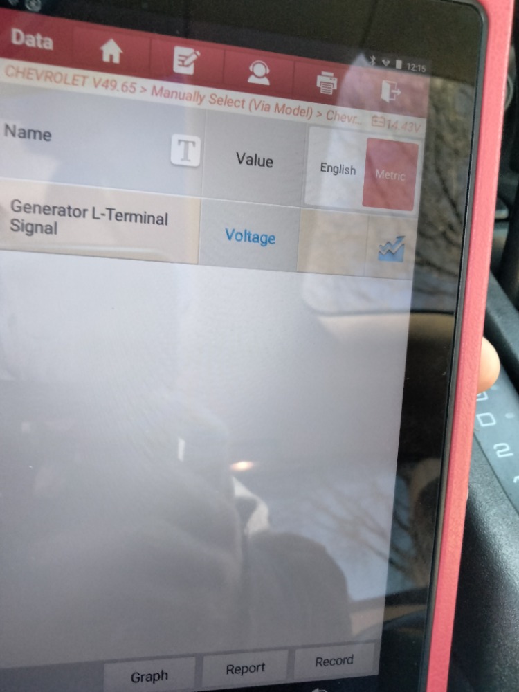

 I do have another scan tool. I pulled up the Generator L data pid and there's no data voltage shown (blank) and no activity on the graph. So possibly there's a break in the red wire somewhere in the harness to the pcm or a missing/bad ground?
