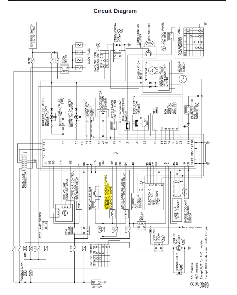

hello people kind of new in electrical diagnosis , hope you could help

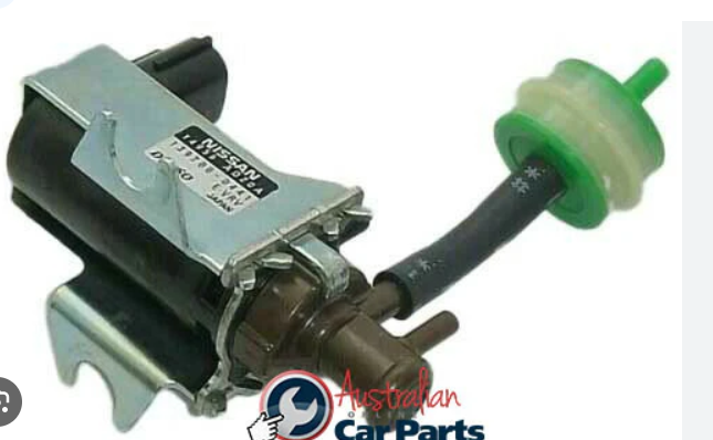

i have an issue with my variable nozzle turbocharger control solenoid  valve. its randomly open and close turn on and off  like "pumping"   i can see the westgate of the turbo open and close rapidly , i tried to replace 3 valves but all has same results ,

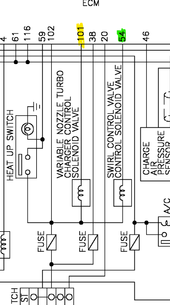

im attaching the wire diagram hope someone can direct me where to start it has only 2 wires i believe ground going (through inner solenoid coil) into pin 101 on the ecm as marked in the attachment .
it is a nissan terrano R20 engine ZD3.0 dissel , no trouble codes , i believe its called ford maverik in the US .
how can i defined if its ground/open/short or ECM perhaps  .
thanks in advance
