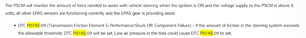

After a while, the steering stopped working, and the following codes appear when I scan: P07AE 09-C8
When you say the steering stopped working, you mean that the power steering assist quits, right? That'd go along with the P07AE setting in the PSCM. I snipped this bit about P07AE from service info:
Basically, the PSCM is seeing that the steering assist motor is having to work too hard to provide power steering assist. Service info doesn't say how it measures that, but I'm inferring that it's measuring assist motor current.
You're looking for anything that can make the steering harder to turn. Binding strut mounts, bent suspension, seized ball joints, like that.
If you don't find anything wrong with the steering/suspension, then it's down to a failing steering rack assembly. This is usually where P07AE ends up, in my experience.
