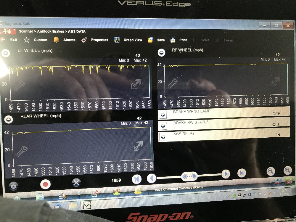

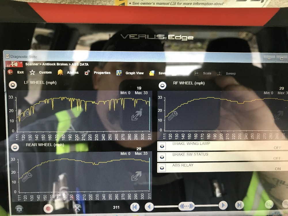

07 Chevy Colorado getting a left front wheel sensor error don't remember the code replaced front hubs left and right front sensors left and right making sure left sensor went to left side and right sensor went to right side I included two attachments screenshot I have no wiring diagrams 07 Chevy Colorado 2.9 L two-wheel drive standard suspension I did use my lab scope had good signals where I back probed at the wheel speed sensor connected to the chassis electrical harness

Is there any chance of an air gap problem on the LF? I ask because I know how these sensors mount on the bearing, and it's very easy to not fully seat the sensor mounting, resulting in an air gap issue. A quick visual on both front sensors might show a difference between the LF and RF. Not saying you screwed it up! Just been there, done that.
If you have the opportunity to scope the front wheel speed sensors again, you might try using the Frequency mode in the Graphing Multimeter on the Verus. This might show a glitch in the signal, compared to looking at the raw signal on the Lab Scope. A frequency glitch might be down to a defective tone wheel on your replacement hub.

Are those pictures of scan data? The LF is awful glitchy. Did that show up on the scope too? I second Tyler's suggestion, wanting to verify air gap and tone ring integrity.
If that all checks out, I know Chevy liked to mount the abs modules on a frame rails under the truck for just about everything. Not a great home for electronics in my opinion, but what do I know?
A visual inspection of the connector and module, then check the signal from the wheel in question right at the module may be in order.
