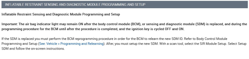

09 Chevy HHR that had the steering wheel airbag deployed.
I have another donor car of the same year.
Would I be able to replace the module, airbag, and seatbelts from the donor vehicle without additional programming?
Thanks for the help!
1 year 1 hour ago #66970 by Chad
Replied by Chad on topic Airbag deployment repairs 09' Chevy HHR
It will require programming.
