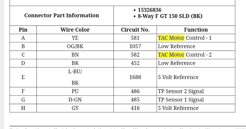

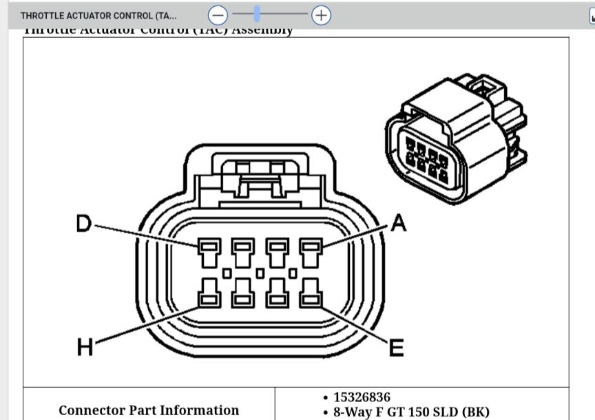

Long time YouTube channel viewer here, I'm currently workimg on a 2005 gmc W3500 same as isuzu npr with a 6.0 gm vortec, vehicle came in hitched on a tow truck with a missing cut off connector for the throttle body, I haven't been able to find a wiring diagram paying or not for this particular vehicle and I'm stuck trying to fix it, i would greatly appreciate it if anyone would be so kind to post a picture of the wiring pin out for the connector! Thank you so much in advance!

I really appreciate you taking the time to help me, unfortunately the connector is 8 pin and not 6.
