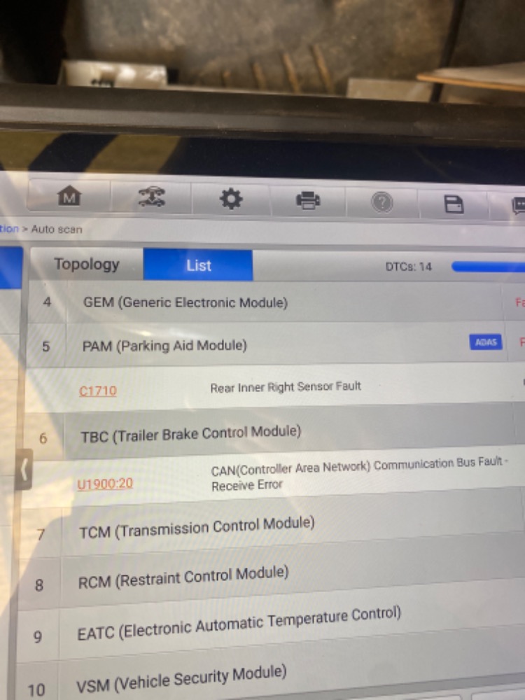

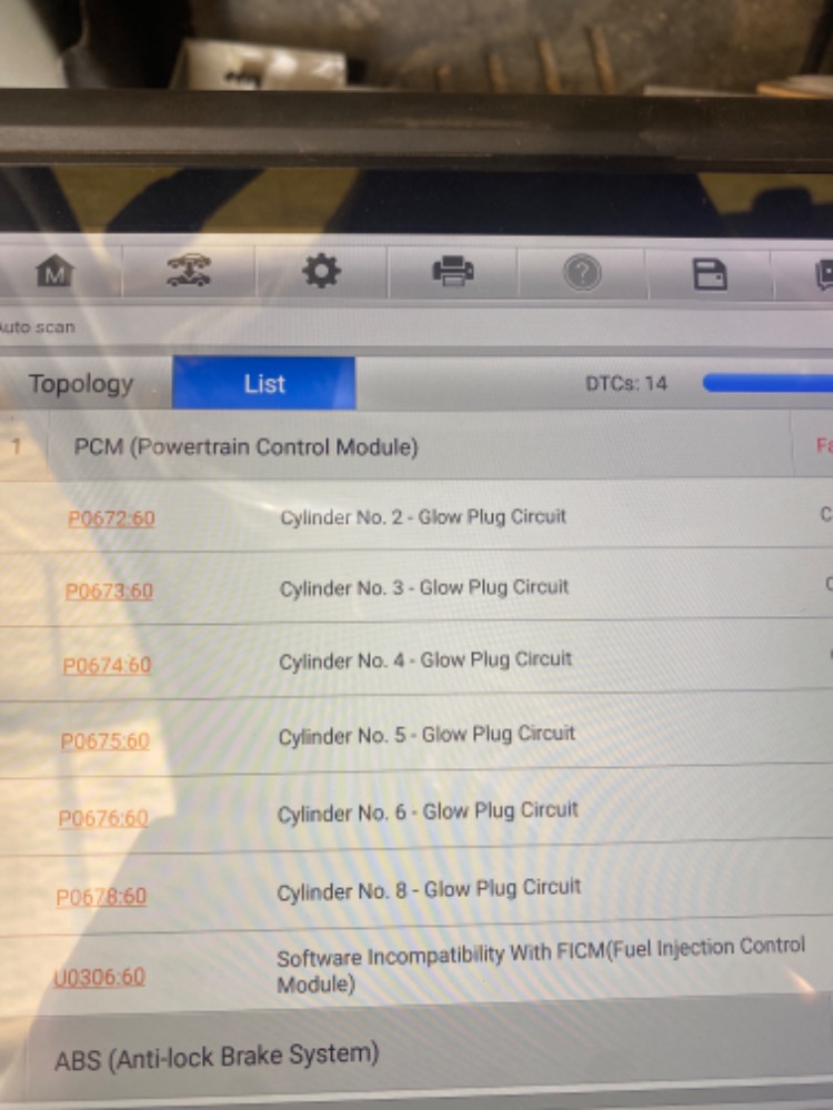

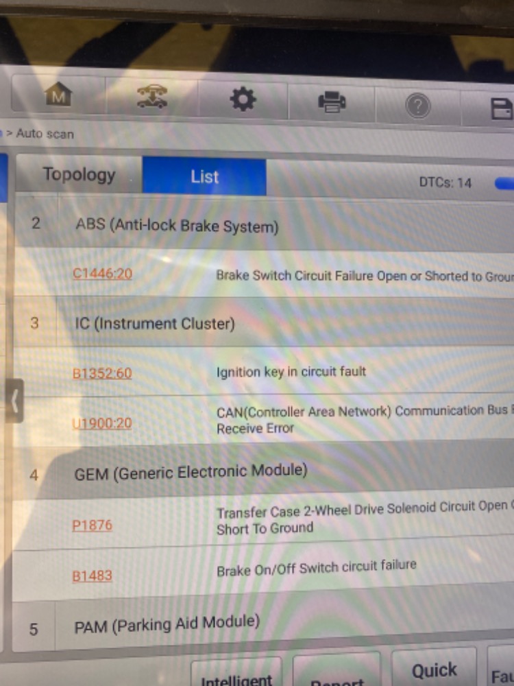

I have a 2004 Ford F-250 super duty 6L

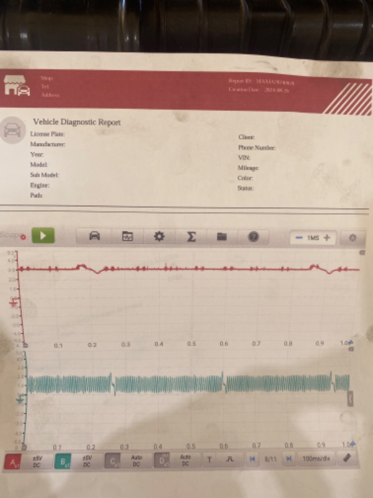

it had long cranking after the it got warm. I replaced the icp and the crankshaft sensor. It then would not start at all, and it showed a fault for all injectors having low voltage, I checked the cam/ crank signals to the pcm and I believe they were good ( 2wire sensors) replaced the fuel injector module and still no start. I belive I was getting all the correct voltages to the fuel module but it is telling me on the scanner that the fuel injector control module is not synced. I have a fault for the module not compatible but I read that it’s conman with using a different module rather than the original.
1 year 11 months ago #66793 by Lupe
Replied by Lupe on topic 2004 f250 6L no start
looks like you have comm codes i would start there . those are known for abs connector wiring corrosion and where water can get to connectors
