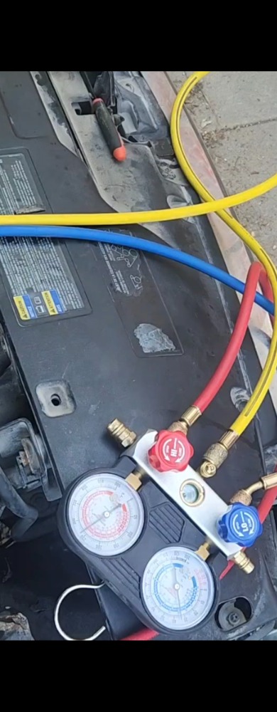

Hello, I have a 2004 gmc sierra with the 5.3. Recently I ruined my low port shradder so I had to evacuate the system and change that. After re-charging, everything was perfect, once I disconnected my hoses the ball that seals the high side would not seal. So, I had to re-evacuate the system and change that. Now, when I'm at idle everything fine, pressures around 50, low, and 250ish, high. But when im at high rpms my clutch disengages. I think it could be the compressor but confused as to why it's fine at idle. I have video files attached below, never mind it wont let me upload. But I have already replaced the belt and tensioner, thinking maybe it was slipping

86 ambient temp, I wanted to upload a video of the gauge set as I rev up, but too large. When clutch is not engaged low side goes up to 80 and high down to about 175. When clutch engages again, still at high rpms, low goes down to 30 and high about 250. Then disengages again goes to about same pressures and then engages again. I pressure tested with nitrogen, no decay, vacuumed to 30lbs sat for 30 min, very little to no decay. Proceeded to vacuum for 45 min to 1 hour. Then filled through the low side, vehicle running with the gauge set, I have a can tap on the freon can. Purge the line at every can change. System says that it takes 1.5lbs but only seems to take 1 and a half 12oz cans. Which seems off to me. The first time I recharged i remember it taking 2 and a half. But had to reduce it due to the high side not sealing. My gauge hoses have seemed to lost some of the rubber gaskets in the ends. Need to get some new ones soon, but would that possibly be a culprit to my issue?

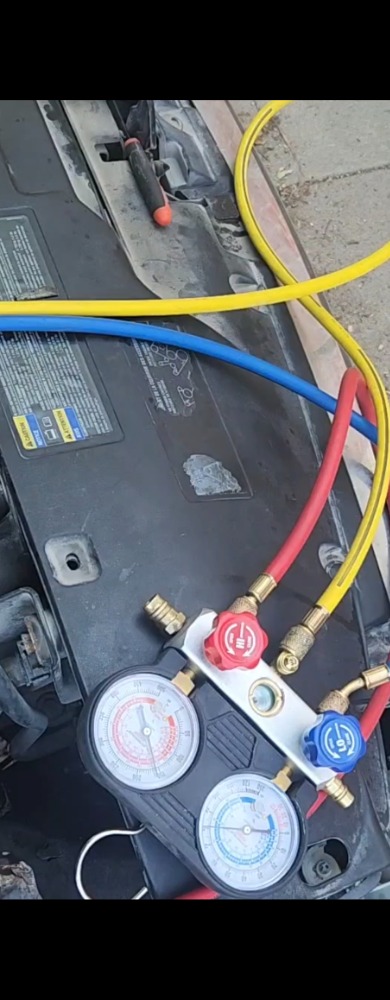

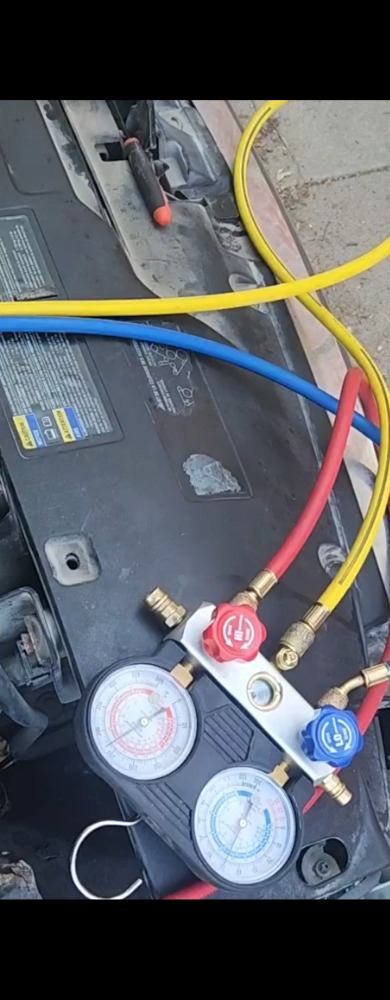

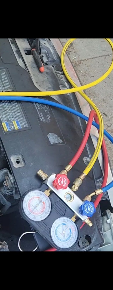

Attached are pictures taken from the video. Starting with before I rev(low: 50, high:250ish), low goes down to about 30 & high stays, then clutch disengages. Goes up to 80, down to 175. Then, engages again low goes back down and high side up

It sounds like you did the charging procedure correctly. The capacity chart that I have says that truck takes 26 ounces of R134. Does the sticker on the truck say 1.5 lbs which would be 21 ounces. If you only got a 12 ounce can and a half in, you are undercharged no matter which capacity is correct.
The compressor short cycling like that can be an indication of a low charge.
Your pressures seem to be in line when it's running given your ambient temperature.
2 years 1 month ago - 2 years 1 month ago #66730 by 70monte
Replied by 70monte on topic Ac clutch issue
Given your ambient temperature, pressures should be in the 45-55 psi range on the low side and around 225-250 psi on the high side.
You mention that the compressor kicks off at higher rpms but does it stay off or just continues to cycle? If your pressures on the high side are not getting extremely high, then the high pressure cutout switch should not be shutting off the compressor.
