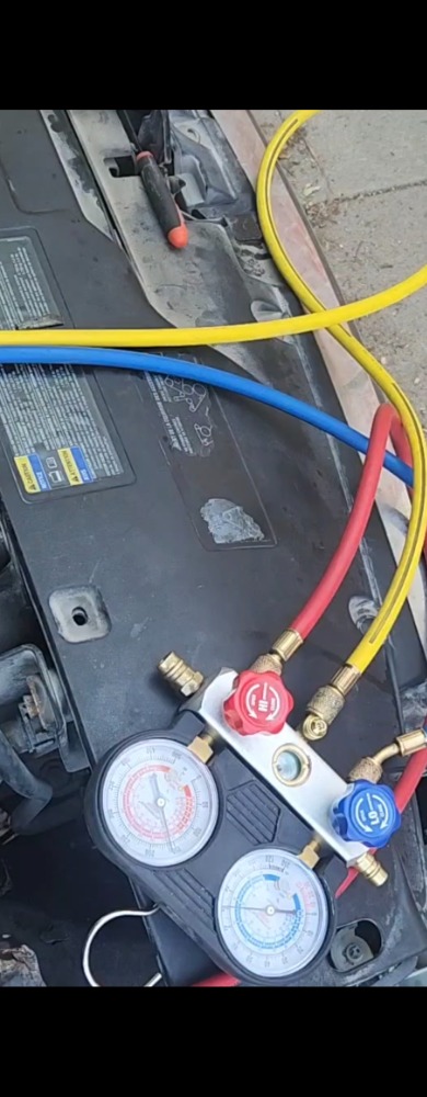

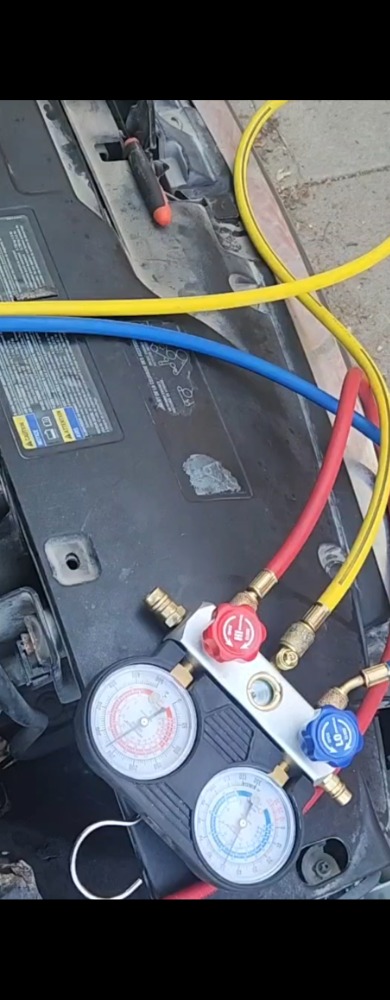

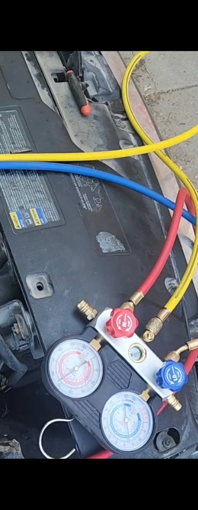

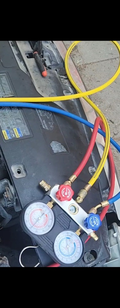

  • BJMajor12
  • BJMajor12's Avatar Topic Author
1 year 11 months ago #66728 by BJMajor12
Replied by BJMajor12 on topic Ac clutch issue
Attached are pictures taken from the video. Starting with before I rev(low: 50, high:250ish), low goes down to about 30 & high stays, then clutch disengages. Goes up to 80, down to 175. Then, engages again low goes back down and high side up
