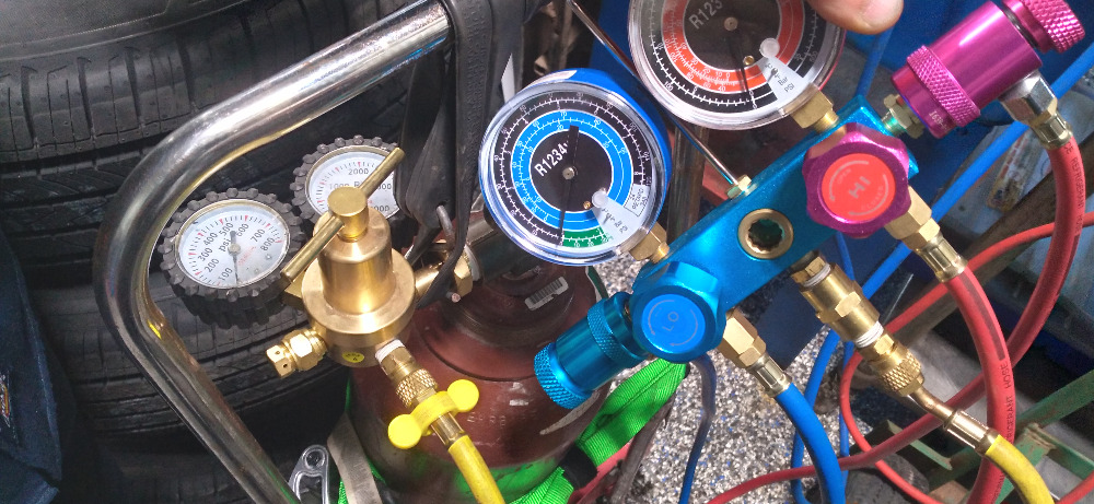

What size nitrogen tank do I need for a/c diag. Could I get away with using 20 cu ft or should I use a 40?
Also, where do you get your can tap attachment to put a shradder valve in it?
Last edit: 1 year 11 months ago by BJMajor12. Reason: Add comment
1 year 11 months ago #66667 by Chad
Replied by Chad on topic A/c diag
The size tank that you need depends on how much AC work you do and the size of leaks that you encounter. It doesn't take much to  pressurize a system one time. The bigger the bottle, the less you have to refill.
Here is an Amazon Link to the regulator that we use.
