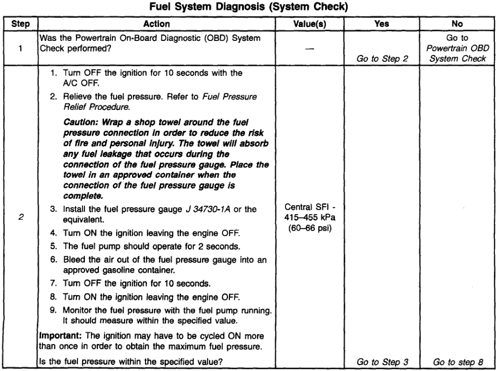

I'm going to follow Alldata's procedure for fuel test to a T tomorrow. I ususally just hook one line to a gauge with no relief valve and check that way, but it calls out to remove the relay, remove the fuel pressure, cycle the key, then install the gauge set, cycle the key, and remove the air, the cycle again to test. (Attached image)

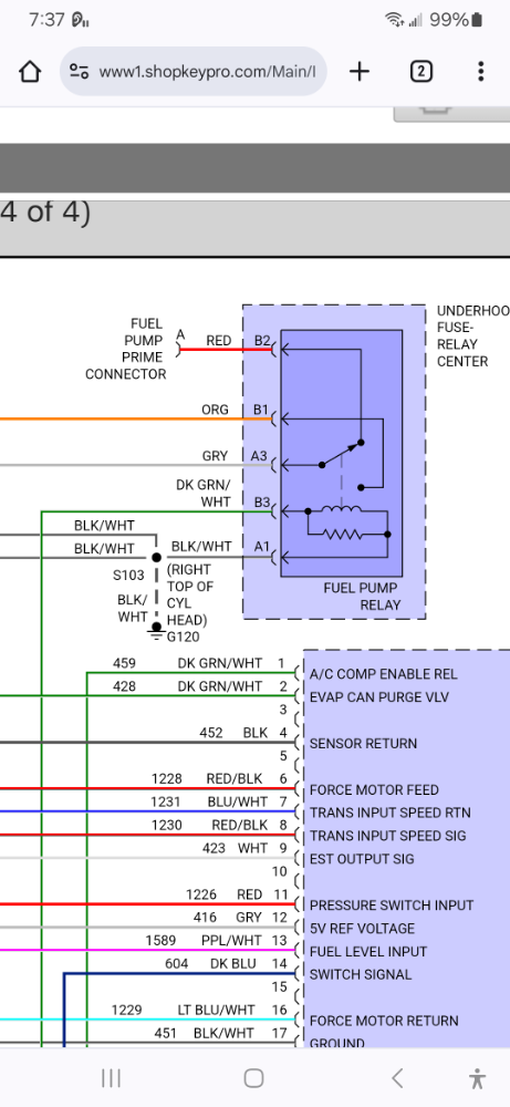

I am able to get the truck to start and run immediately when I jump the fuel pump relay, so I can see the fuel pump does infact run, and I swapped out multiple different relays, all of which click.
I'm lost on what it could be, I even took apart the fuse box and checked for melted wires, and found no issues.

2 years 1 month ago #66718
I would investigate the control circuit of the fuel pump relay.
Cranking long enough to build oil pressure should activate the fuel pump relay on that system.
However, with the relay unplugged from the fuse block, you obviously know which two pins to jump to send power to the pump.
Of the two remaining terminals, A1 on the diagram black and white should be constant ground. B3 green and white should be switched power from the computer to activate the fuel pump relay while the engine is cranking or running.
Replied by Noah on topic '98 C1500 5.0L RWD No start
