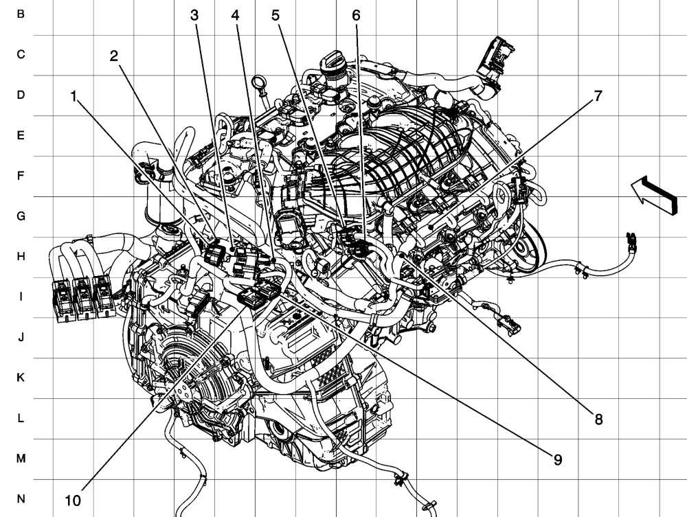

I grabbed a harness diagram that includes X111, which is the one of the engine to instrument panel connectors. X111 carries the APP wires, among others. X111 is labeled as '9' in the picture:
The diagram can give you a rough idea of how the harness routes and possible suspect areas.

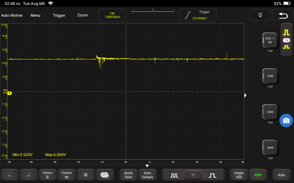

I think I am going to scope the App 2 5v ref signal and drive around the vehicle and see if I see anything out of ordinary.
My problem is I literally shook down the entire harness already so I am not even sure how I will handle the situation if I see a blip on the scope.

Here is the only blip I saw in the 5v ref circuit 3 was at startup. That hash is at startup.

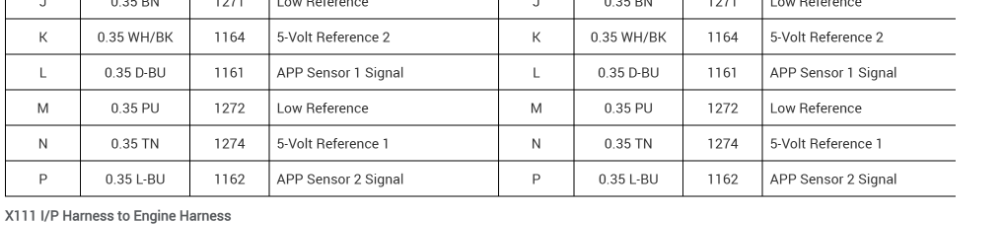

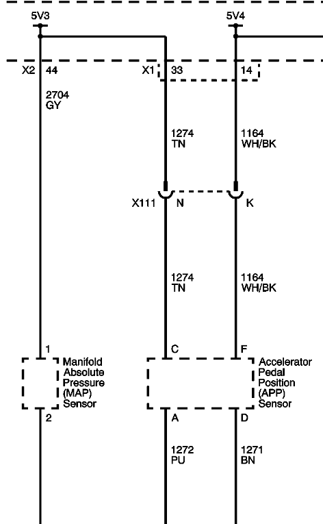

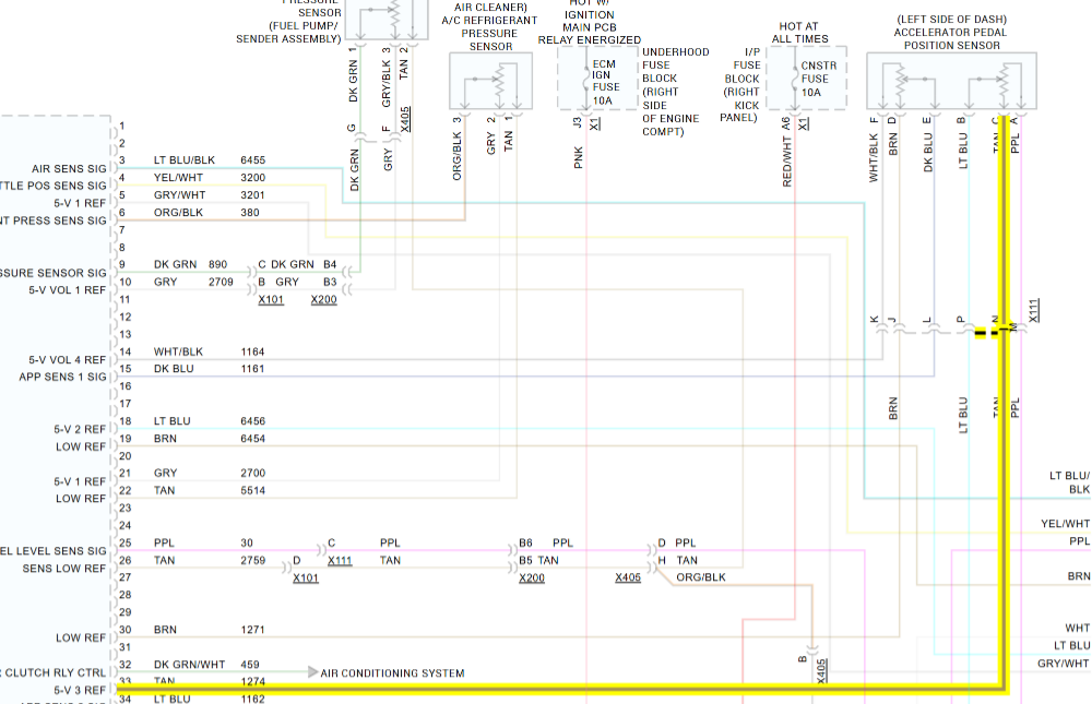

I have same the codes. I am back probed into x111 pin N for 5v ref 3 to APP (according to OE reference diagram and powertrain management) and 5v ref 3 right into MAP sensor. From X1 of ECM, pin 33 is a tan wire, remains tan through x111 then into APP. Connector view shows Pin N on X111 to be a 5v ref 1?
