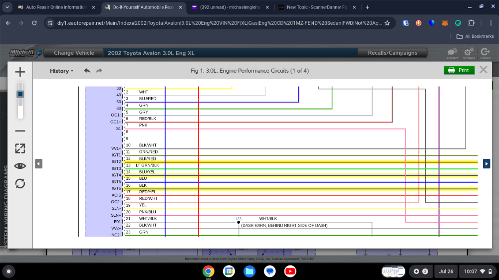

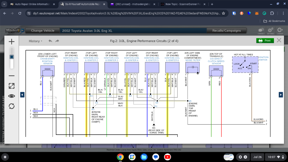

The reason I am thinking it probably is not that is because of some of the new DTCs which pulled up which are - Igniter Circuit #2, #4, and #6. So I am then thinking, perhaps they are tied into the same circuit going into the ECM and that is where it is failing. They look to be on separate circuits, so probably not a failing ECM. Then I am thinking a timing issue.
I just looked up another code on Mitchell 1, and, although it doesn't actually show the specific code scanned (P1354), it does show P1350, which mentions the VVT sensor for camshaft position. It seems logical that it could throw off the whole bank igniter circuits. How would I check this without a scope? I only have a meter and test light.

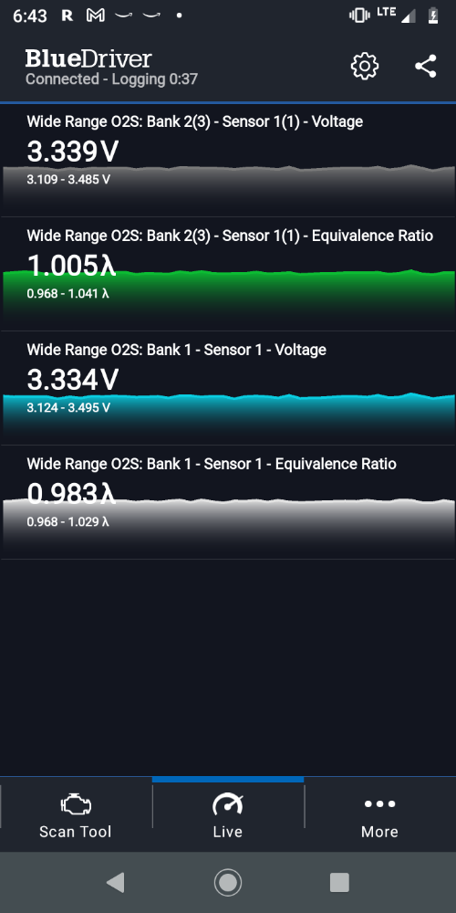

Another is P1150, which is A/F ratio sensor stuck at 3.3 v, which indicates possible open. Could an open A/F sensor cause the misfires? But why would the VVT sensor (P1354) scan. I do have a coolant issue, which it says could be related to that.

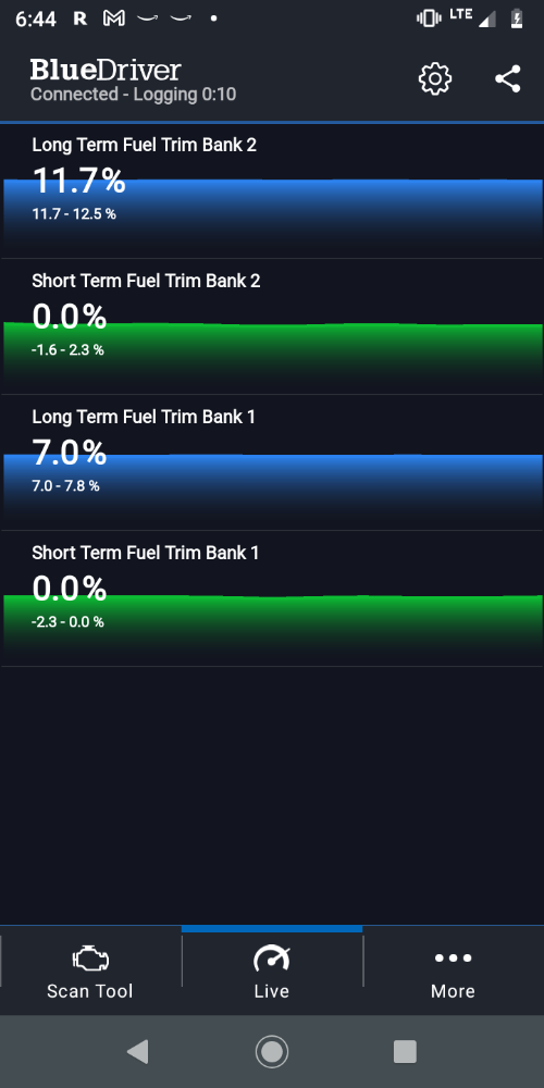

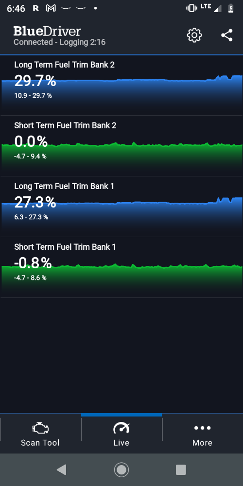

Like I mentioned earlier, I will upload the DTC report along with some screenshots of live data and diagrams.
