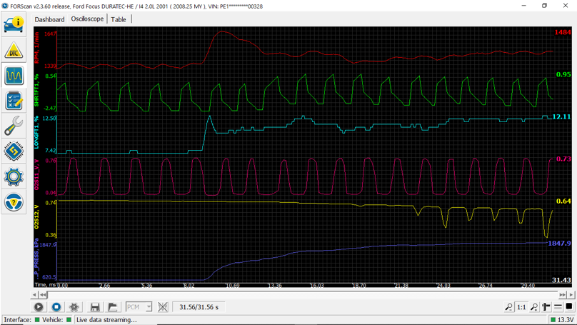

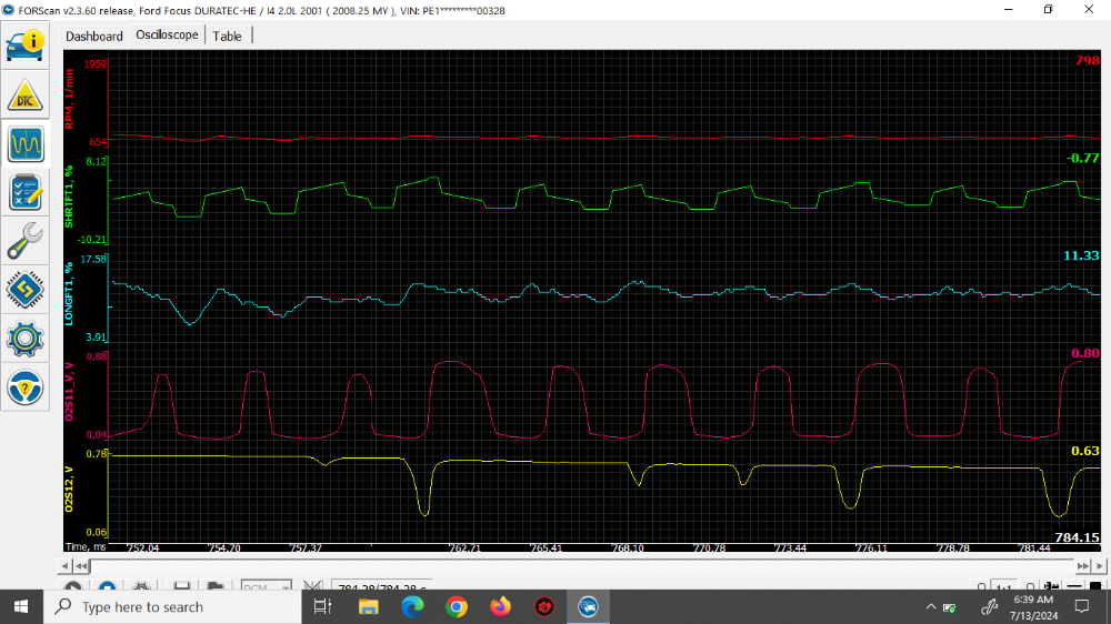

Would the drop in the rear o2 sensor confirm a sticky valve? I have a tick and the vacuum gauge has 1'' of flutter. It happens at idle and low rpm sometimes.

Compression tests and leakdown tests are perfect.  The injectors were leaky and have been cleaned.  However, on start up there is no valve tick and the vacuum gauge is rock steady at 24''. As it warms up the tick starts and the gauge fluctuates 0.5-1''. When it is really hot, the noise will sometimes stop and the gauge is rock steady at 24''. Adding a load such as headlights or AC will make the tick louder-turning them off will remove the noise. All ancillaries have been removed and checked.
I am leaning toward a sticky valve as the car is only used every 6 months and sometimes the engine is quiet.
