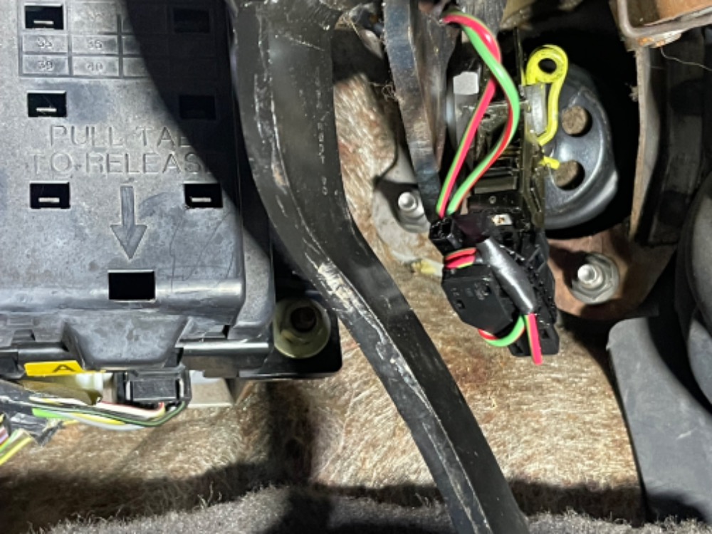

Put car together enough to test brakes. Started engine, pressed pedal, and it seems firm enough, but the weird thing is now I cannot get the car out of Park. Shift lever will not move. Shift cable, whose bracket I did have to move out of the way to get booster out, does not seem bound up or jammed. I am pretty sure I pit the brake pedal back together correctly. But I guess I could be wrong, so I’ve attached a picture. I have tried moving the shift lever with the linkage connected at transmission as well as unconnected. Can’t figure out what I have done wrong. Any ideas appreciated! UPDATE: My brake lights do not illuminate when I press brake pedal. So I am guessing I did not reinstall pedal switch correctly, maybe that has something to do with it?
ANOTHER UPDATE: Did some additional research and I know now I definitely reinstalled switch wrong. I am reinstalling brake switch correctly and will give it another try.

Replied by Noah on topic 2001 Ford Taurus wagon DOHC Brake Booster
Definitely going to be a problem with the brake pedal position switch. A little difficult to tell from the picture if it's installed correctly, but the wires don't exactly look like they are laying naturally, like they may have gotten twisted. And is that tape? Maybe bad news under that tape...

Replied by popoften on topic 2001 Ford Taurus wagon DOHC Brake Booster
Reinstalled the brake light switch, and brake lights work again and can shift out of park and into all gears. Yes I think that is tape, it appears someone has been in here before. Thanks, guys, car is back on the road! YOU ROCK!!!
