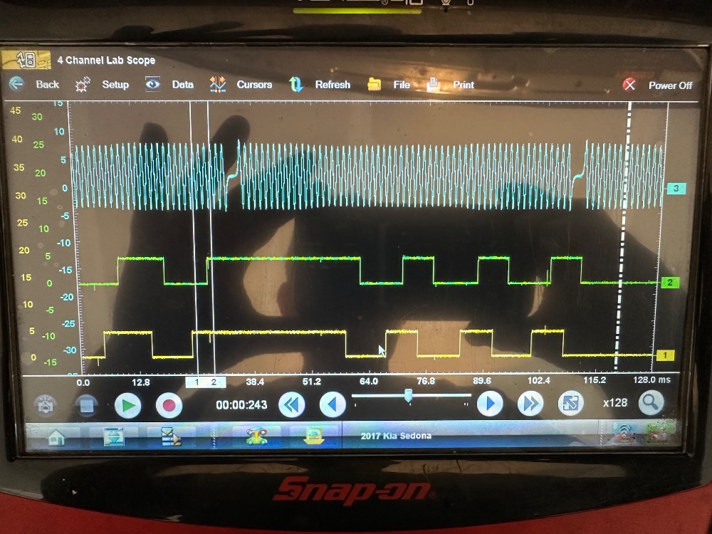

First I went into scan data and viewed the desired and actual of all 4 cams at idle. All 4 cams where were at zero as expected. I then ran the control valve test. you can hear all 4 of them click and when engine is idling all 4 work as designed. I did this test multiple times but never caught one not working.
looking at scan data again, this time just the intake cam on bank 2. I started to notice something. At idle, and I can get it to do it more just off idle, the intake cam actual position would jump up. Sometimes 2 degrees and sometimes as much as 15 degrees. when this would happen I would see the phase command percentage go to 100% to correct it. I unplugged the connector that has the 4 wires in it that go to both intake oil control valves and then I couldn't get it to jump around again. after I plugged it back in and did a key cycle the engine would have to run for a little bit before it would start doing it again.
Next I backprobed both cam sensors and monitored them on my scope. (I haven't been able to get my hands on a known good yet) but what I found was, intake and exhaust cam signals match up with each other while at idle and just off idle. When the intake actual position starts jumping around I can see a distinct difference in the position of the cam signals. And the intake cam signal is not dropping out.
Seeing the intake cam signal move tells me that the cam is actually moving out of time. And that it isn't a sensor problem.
While doing all this I was clearing the P0018 code and could get it to set again pretty consistently while just sitting in my garage.
After all this I cleared the code again and then added the 2 quarts of oil it needed and redid all the test.
I never seen the cam move out of time again.
Then I took it on a test drive for about 20 minutes. then pulled over and shut the car off. Waited a few minutes and then drove back. I did this to get at least 2 key cycles in. Code never came back. Great!!! It's fixed it just needed oil!!!

And monitoring the bank 2 intake cam I can see the same random jumping around.
My questions:
1. Can an oil control valve cause this? I can't explain why an oil control valve would cause it to randomly move. Or was unplugging it causing some default strategy that was masking the problem and that's why I never seen it move while they were unplugged. When I added oil it did seem to fix the problem for a little bit.
2. Could this be a sheared pin problem on the phaser on the front of the cam? This seems like a likely culprit. But if it was I can't imagine I could have drove it that long without ever setting a code. And he drove it for almost a full day before it set right as he was getting home.
3. Could this be a slack chain problem/ jumped timing? Until I get a known good waveform I feel like this is the least likely at this point. I feel like if the timing jumped There would be other codes associated with this and he would have drivability problems and possibly misfire codes.
Im trying to find a way to prove what is bad before I have to start taking stuff apart. it sucks that the whole valve cover has to come off to check timing.

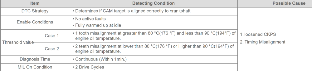

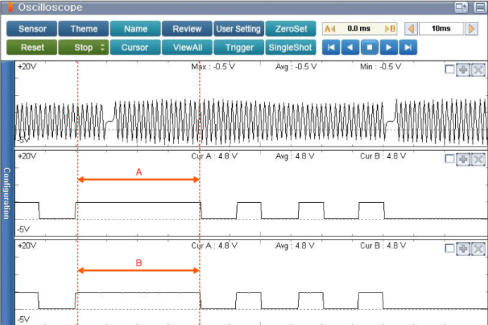

Hey kerry.kozma! While researching P0018, I found this known good cam/crank waveform in Kia service info:
For giggles, I also looked up the code set criteria. It's oddly depending on engine oil temperature. Found that interesting! No other manufacturer (that I know of) changes their cam/crank failure thresholds based on engine oil temp.
It's possible? But wouldn't be my first suspicion. Normally, I see VVT solenoids either fail electrically, or stick open. The timing behavior you're describing is much more erratic than that.

Agreed. I know you're not excited to take stuff apart, but at least your fault is for the front bank of the engine! If the cam/crank waveform lines up, I'd say it's time to take the front valve cover off and put a wrench on the cams. If you can turn the intake cam more than a few degrees without the sprocket/chain moving, you've found the problem. Compare to the exhaust cam if you're in doubt.
Not on this engine, but I have seen on other Kia/Hyundai products where the phaser lock pin wears a groove/slot into the phaser housing over time. Eventually, when the engine is hot enough, the clearance between the phaser and the pin opens up enough that the pin can no longer lock the phaser into the parked position. Those vehicles only faulted during closed throttle decel after a long test drive.

First, can I ask where you found that known good and the code setting criteria? Searching for the P0018 Kia and all I found were 3 minute YouTube videos with the guarantee I can fix that code in 5 minutes lol.
I did assume the intake and exhaust should line up so at least I got that right.
Im going to check it again since those cam sensors are easy to get to and make sure they are and then see if I can see the intake cam timing shift again when I see it changing in scan data.

Finally back from Mexico City and got the van back over to my house.
His kid was driving it while we were gone and now complains of a low power problem.
I scoped the timing and found it looks like the intake cam has jumped 3 teeth.
I took this capture with the intake and exhaust oil control valves unplugged and the variable intake solenoid valve unplugged for bank 2.
He asked me if he could get just that bank fixed and I told him he needs to replace all the timing components because the engine has been ran low on oil for so long.
Just want to say thanks again for info!! You guys are amazing!
