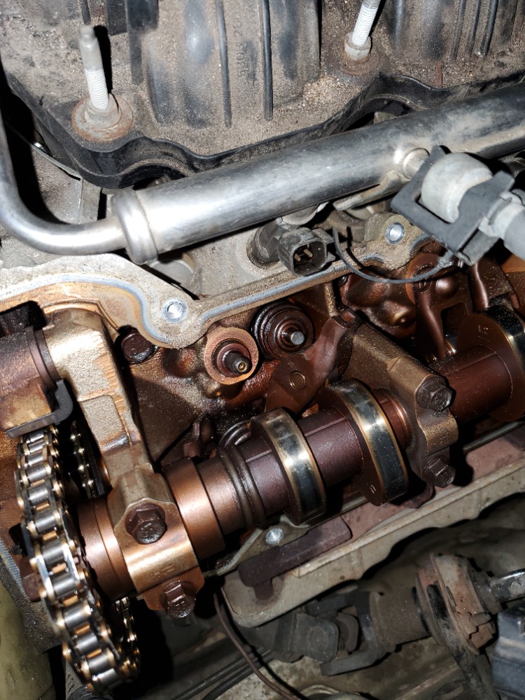

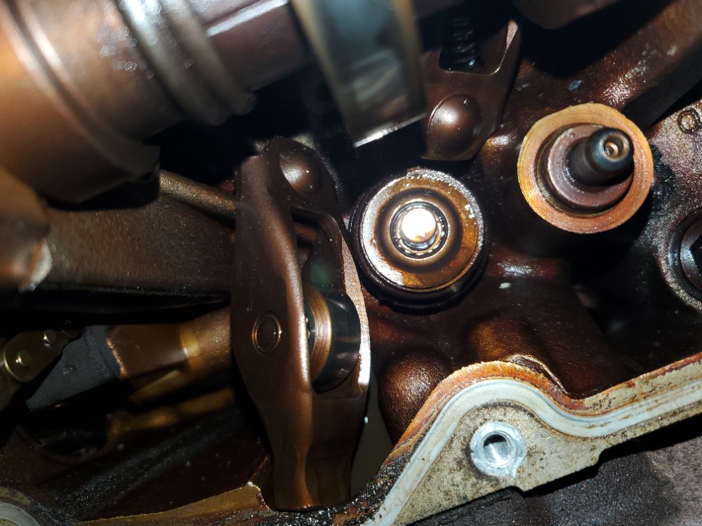

Ok, got all coils checked with a a propper spark tester all checked out with nice strong spark. Moved onto compression check. Cylinders 1 and 2 no compression al all. Cylinders 3,4,5,6-170-180. Guess i am pulling valve covers to check rocker arms. Not familiar with this engine but learning quickly. Any experts who have dealt with slipped rockers and if replacement heads or engine the better repair in worse case senerio? Ill report findings. High milage engine not sure if overheated so could be dropped valve seat and rocker issue.

Compression test for the win!
Not great news, but now you know where you are going.
If you see anything cool, post pix please.
Surprised it never set misfire codes on one and two...

1 year 6 months ago #65945 by CFAaron05
Replied by CFAaron05 on topic 2005 Jeep Liberty Crank No Start
    Got the drivers side valve cover off and guess what we found? Two rocker arms laying in the head recesses.
