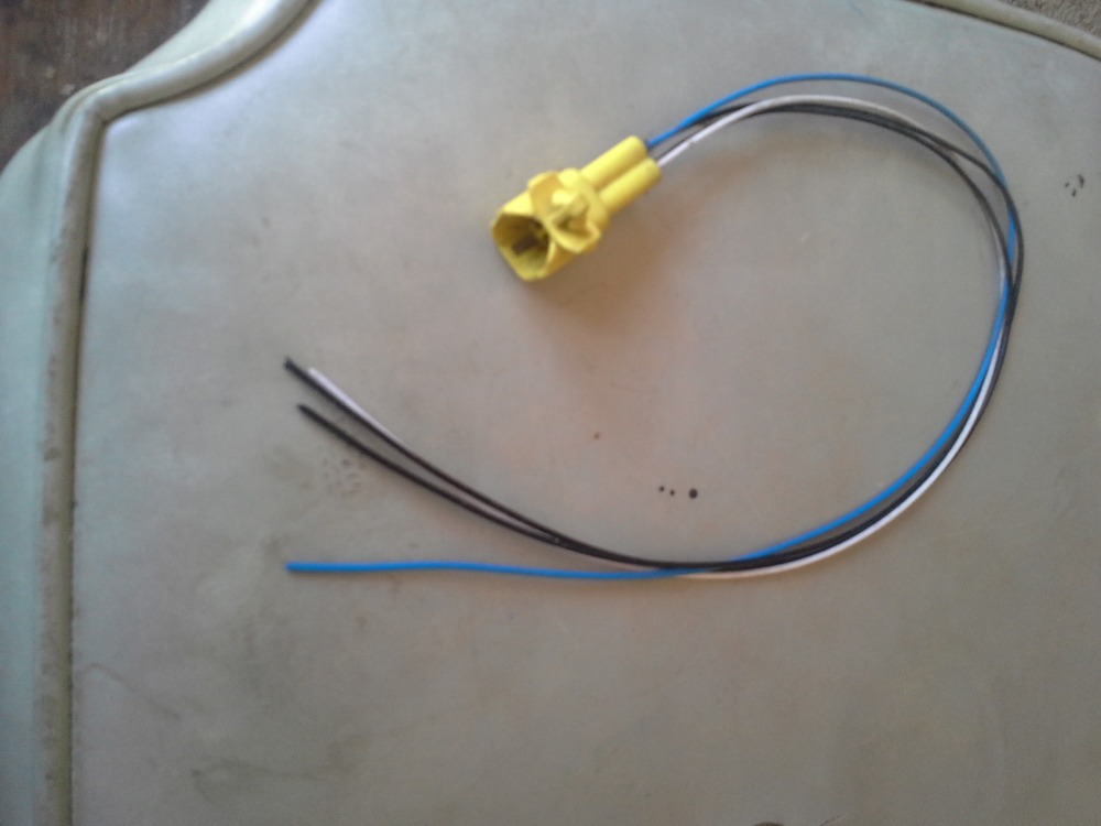

How many wires does this sensor have?Check the pins on the new sensor vs the old sensor .. an 02 sensor shouldn't have that affect on an engine on first start .? Are you able to keep it running by pushing the gas pedal?

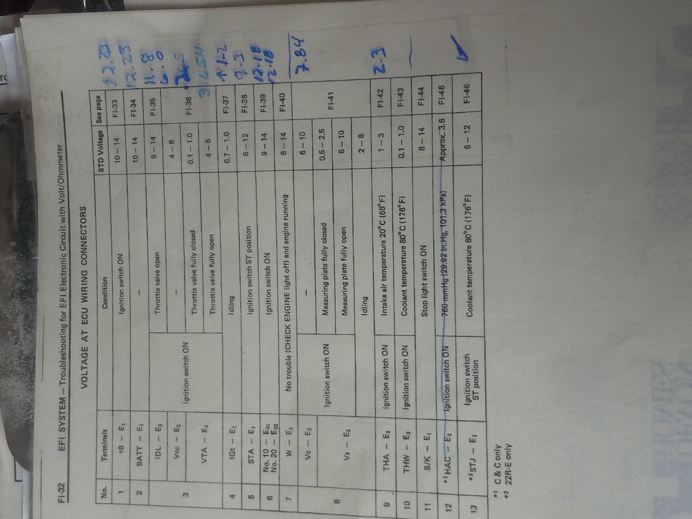

- StepSide88
- Posts: 72
9 years 2 months ago #11355
by StepSide88
Replied by StepSide88 on topic Re:88 Toyota EFI - reading more than than flashes?
- StepSide88
- Posts: 72
9 years 2 months ago #11440
by StepSide88

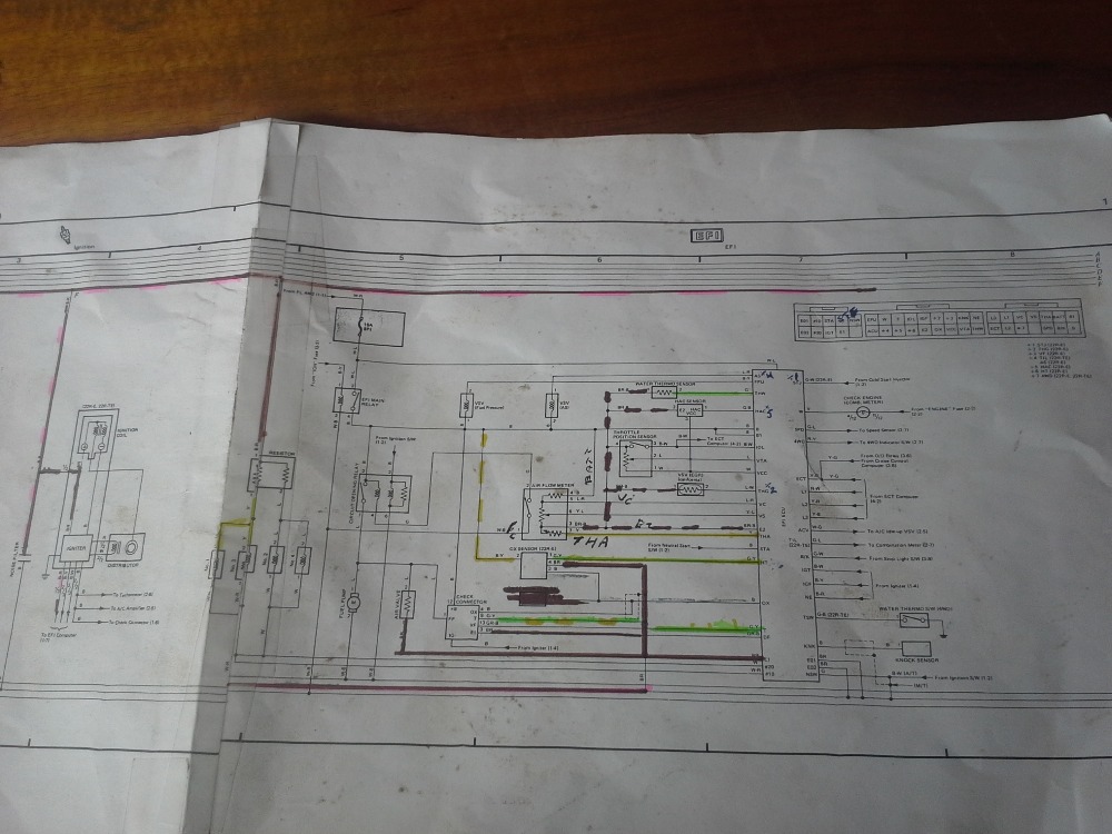

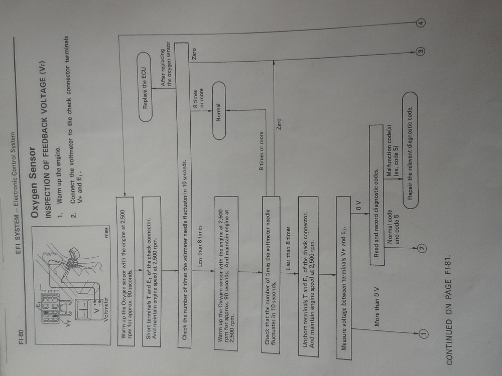

After days of tracing connections and checking the Resistance per the FSM I'm back where I starterd only now I have 2 codes.
A #21 which says O2
and #31 Mas Air
I have one test for checking the signal from ECU to O2 left to preform, but I have 2 digital DMOV and the test is to read how many times in ten seconds the needle bounces.
If I knew more I'd hook up the 2 channel Oscilloscope and get this reading but so far all I'm getting is the scope trigger signal from what I can tell.
I could post the FSM O2 flow chart, schematic and check lists readings I have if that would help.
I'm really trying to make the process of checking things thoroughly before buying a new ECU work.
but this last test is kicking my butt.
A #21 which says O2
and #31 Mas Air

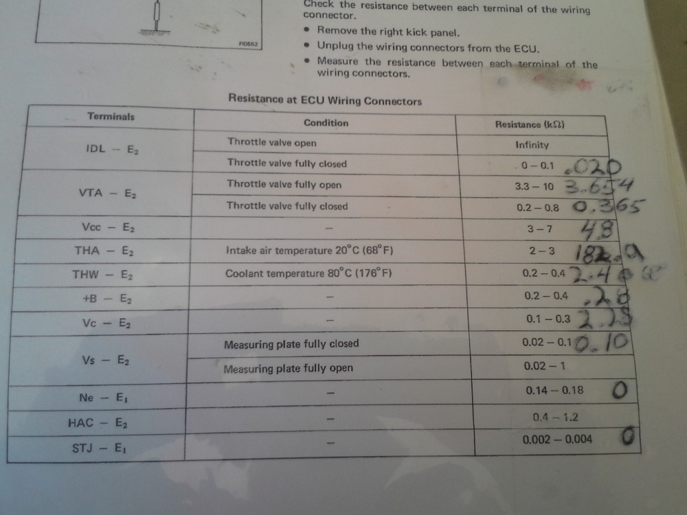

Sorry I've been away for a while . Where are you at currently does the car still die immediately after starting ? The oxygen sensor doesn't have that much control that quick ,the maf however certainly could cause that. I'm not sure if this car has a backup strategy for the maf if you were to disconnect it or not but it's worth a try. Also I see stj-e1 and ne-e1 isn't within spec what are those components?

Well I ordered a 1008 hantek which will arrive Wed and a new ECU a few days later I think.
I spent half a day driving around looking for a new analog DVOM or is that AVOM?
No success. Came home and rehabbed an old (1950s?) meter enough to get the signal I needed... No signal.
That's when I ordered the ECU.
The flow chart and my frustrations all seemed to align in that moment.
STA looks to be the ecu to ign switch/ecu pin of the Circuit Opening relay
NE is a leg for the Igniter its part of Igt,Igf,NE
STJ is cold start injector
Still won't stay running more than a few sec at most.
I ran through the Mass air check list and checked wire continuity but all those passed in spec
