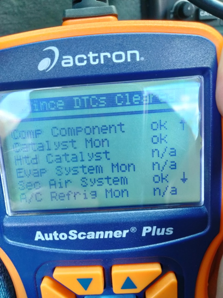

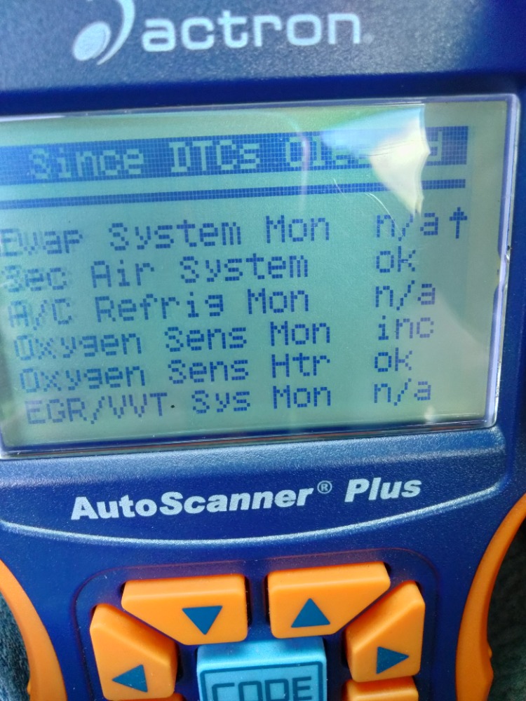

I drove the Vette and now the catalyst and heater 02 monitor shows ok but the oxygen sensor monitor shows inclusive. Will this pass?

I don't know. In Massachusetts where I live and work, you can have any one incomplete monitor and pass. Also anything fifteen years or older is emissions exempt...
You can ask the inspection station if it will pass like that, or keep driving it until that monitor completes.
