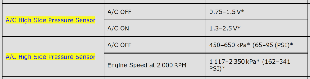

Hey aluiaam! I couldn't find a pressure/voltage chart in service info, but I did find this bit in the scan tool data parameters chart:
According to this, it would seem that your voltage reading of .974V should be sufficient to allow compressor engagement.
I wouldn't say that there's anything wrong with your testing or methodology, necessarily. Thorough, certainly! But maybe a bit indirect, or possibly unnecessary.

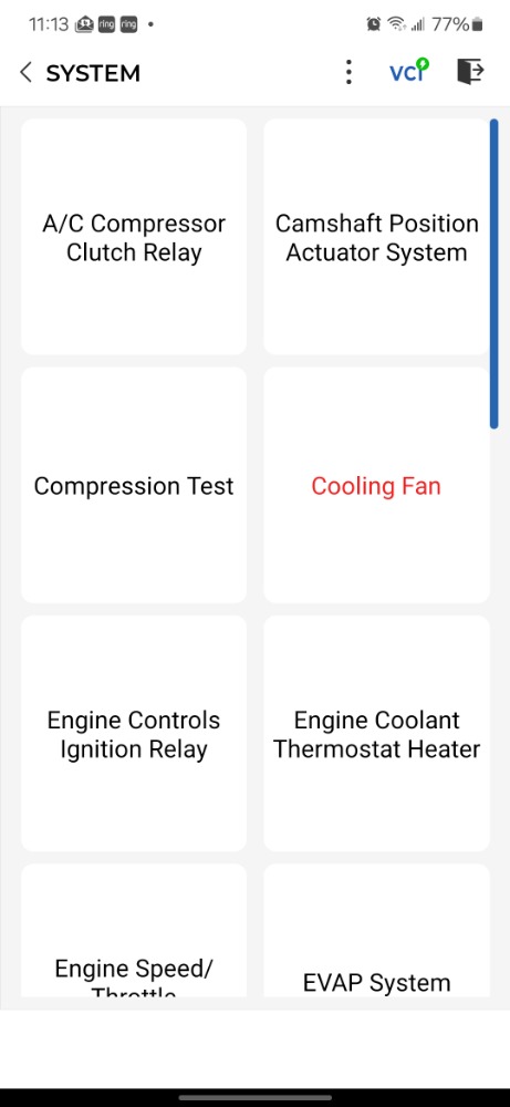

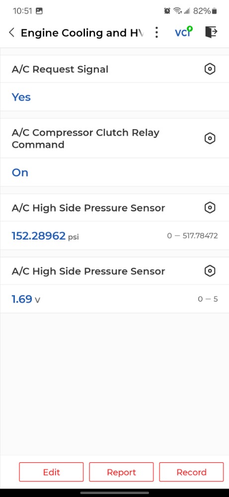

As for a scan tool, it's tough go to wrong with the TopDon TopScan:
www.topdon.us/collections/service-tools/products/topscan
The TopDon (Launch) coverage for GM vehicle is usually excellent. HVAC scan data and bidirectional controls will be there, as well. As long as you have a smartphone, it's an incredible value at $60. Paul even used it in a recent Premium video:
www.scannerdanner.com/scannerdanner-prem...sor-diagnostics.html
