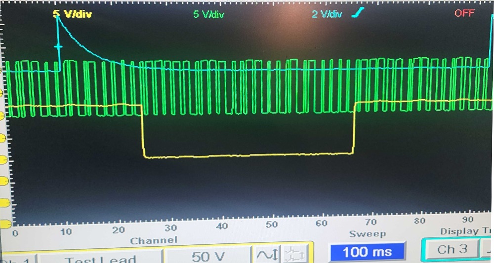

The attached scope image is back probing PCM at CKP and CMP and an inductive lead on the #1 plug wire for the trigger. Blue is the inductive trigger on #1 plug wire. Green is CKP. Yellow is CMP.

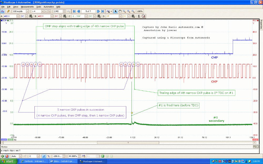

For comparison, I found a sample of the expected 24x CKP pulse (on the LSEngineDIY site) and how it should look in relation the 1x cam pulse. To my eye this looks like what we have.

Thanks for the reply. This is NOT a distributor style ignition, it is an LS1 style Coil Near Plug. The cam card shows it has the original firing order, not the old BBC order. I also checked the cam part number to confirm. I suppose it is possible that the cam was ground wrong but I think that is pretty unlikely. In my scope pic, you can see that the #1 firing event is quite a bit advanced from the falling edge of the CMP which leads me to believe there is a significant ignition timing issue going on where the spark is way too far advanced. Since that is not adjustable and the CMP and CKP signal appear to be in proper sync, I am not sure what could cause that to be so far out of whack. I found this image on the LS1Tech website (see attached) that shows what is supposed to be the proper relationship of these signals and it looks like my CMP is a few degrees retarded relative to CKP but the #1 firing event is SIGNIFICANTLY advanced. Since this is PCM controlled I am not sure what would cause such a huge variance if the CMP and CKP are in spec, which they appear to be.

That is an inductive clamp on the plug wire. It is as accurately representative of the plug firing as a timing light and I set it as the trigger channel for time reference on the other channels so it should be what you are looking for. I scaled it with a caliper and it looks to be 69 degrees of ignition advance at 1,500 RPM. Doubtful the advance is causing misfires on 3 cylinders but perhaps whatever is causing the misfires is causing excessive advance??
