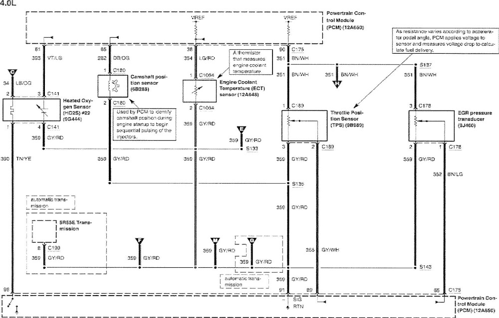

Does anyone have a wiring diagram for a 2006 Ford Ranger 4.0. Im trying to locate the the upstream wiring harness but it looks like that it was removed or cut out
