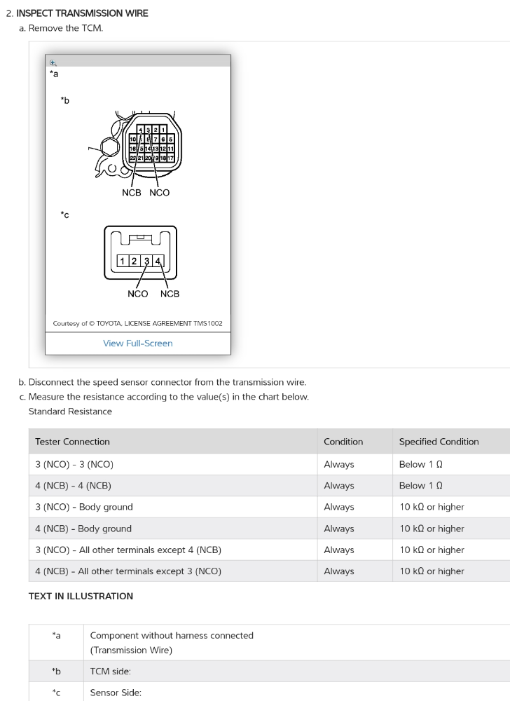

P0793: Intermediate shaft speed sensor A malfunction.
It appears that service of the intermediate shaft speed sensor requires removal of the valve body from the transmission.
If you have a scanner that displays transmission data, you may be able to watch that particular sensor on a test drive, but the computer has all ready flagged it as a problem, so I wouldn't be surprised to see it acting irregular. If you have a scope, you could scope the speed sensor, but again, with that code, I would expect it to be irregular. Really, all you're left with is to check the wires from the transmission to the computer for chaffing or poor connections. Anything else must be done inside the transmission.

Thank you - I've picked up the manual from an ebay seller. It's likely either the sensor itself or the transmission control unit. I don't want to break open the transmission myself so I'm going to bring it into a shop. I don't have any of those scanning tools.
