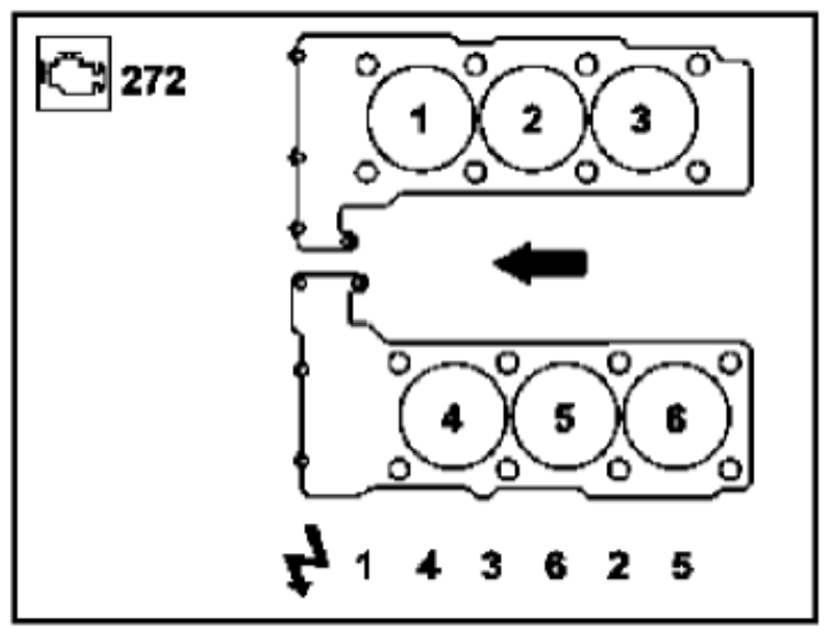

First off, let's be clear about which cylinders have no spark. This is the cylinder layout for your engine for reference:

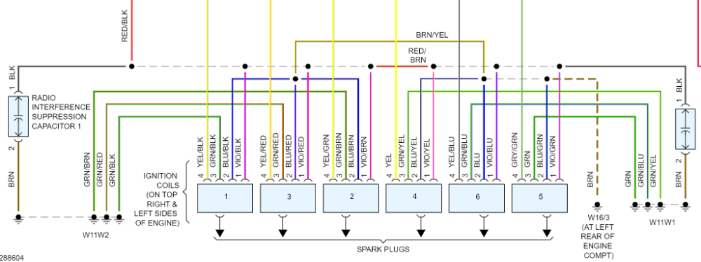

Second, this is a wiring diagram of your ignition coils. Engine running, pick a cylinder with no spark and measure voltage at each of the four pins with a multimeter.
Let us know what your voltage readings are and we can help you further.

coils 4,5,6, the problem. no voltage.
.81 volts across 4,5,6 # 1 wire. should be 12v
.000 volts across 4,5,6, # 2 wire
.002 volts across 4,5,6 # 3 wire
.2 volts across 4,5,6, # 4 wire.
- Mark Hart
- Posts: 3
2 years 7 months ago #64817
by Mark Hart
Replied by Mark Hart on topic Mercedes 2006 ML 350
I connected a 12v wire to position 1, from the cylinders 1,2,3 to give me 12v on 4,5,6 and the engine started, ran and idled. I have power at the coils on 4,5,6. I then performed a cylinder drop and the engine responded on each. Still running a little rough though and engine light on but not flashing like before.
