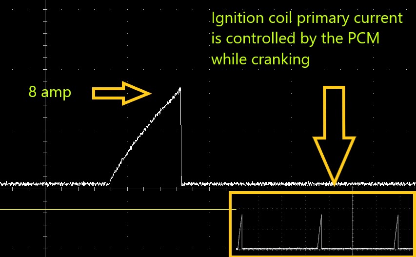

Ford Focus 1.6L 2005 (EU), crank no start no code, strange ignition waveform was created by glongprr
The car was running fine. One morning, it started for 2 seconds then died. I checked the fuel pressure, which was low (15 psi). I replaced the fuel pump, that fixed the fuel pressure issue (50 psi), but the car now won't start. It cranks, sometimes almost wants to start. There are no DTC error codes. I couldn't find any obvious problems except for a strange secondary ignition waveform.
What I checked
What I didn't check
What I noticed

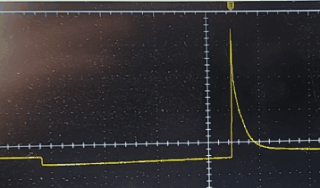

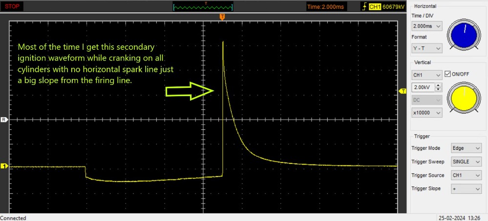

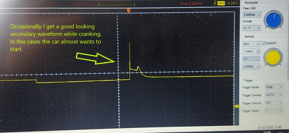

While checking the secondary ignition with a scope, I noticed a strange secondary waveform with no spark line. (see: image ) Occasionally, it produced a correct secondary waveform with the horizontal spark line (see: image ), and the car wants to start in these cases. All cylinders produce this bad secondary waveform. Here is how it looks like on the scope: image
Also a short video that shows cranking with bad secondary waveform and you`ll see it produces a good waveform and the car almost wants to start: streamable.com/a6mzgv
Occasionally, I can hear small booms (explosions) from the throttle body while cranking. I guess unburnt fuel exits through the intake valve.
I replaced the ignition coil, but the problem stayed the same. No spark line in the secondary waveform. I tried to find similar bad waveforms on the net with some explanation, but no luck. I have no idea what can cause such a bad secondary waveform without a spark line. HT leads? Spark plugs? Its like something is blocking the spark from forming. Do you have any idea?

Replied by Tyler on topic Ford Focus 1.6L 2005 (EU), crank no start no code, strange ignition waveform
Love the secondary captures.
Thanks for including those!
That gentle slope down from the firing line is usually an indication of a secondary circuit short to ground, IMO. Water in the spark plug tubes, coolant/fluid across the spark plug gap, wire grounding out, like that. Not saying your Focus actually has any of those specific problems. Just giving examples of what I've seen cause that ignition waveform.
The engine doesn't sound like the piston rings are washed out, but I'd be tempted to pull the spark plugs and check for fouling anyway. If the plugs are wet with gas, dry them and the cylinder out as best you can. You can also try feathering the throttle during cranking in an attempt to get the cylinders dried out enough to start. Take care not to overheat the starter, and have a battery charger/jump pack handy.
Speaking of gas, was the vehicle refueled immediately prior to no start happening? How did the fuel in the tank look when you replaced the pump?

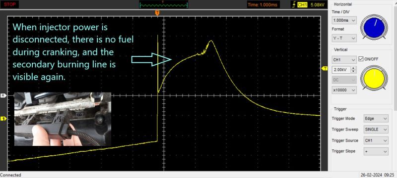

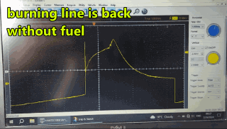

Thanks, Tyler! Your hint regarding the fuel injectors was really helpful!
The secondary burn line is back (without fuel)
I thought that if the missing burn line in the secondary waveform is caused by a fuel issue, then simply cutting the fuel while cranking should show a change in the secondary waveform. So, I disconnected the injectors from the power and checked the waveform again. Now, the burn line in the secondary waveform appeared, confirming that the issue is definitely caused by fuel in the cylinder, and the ignition system is fine.
Here is the video of the secondary waveform with the reappeared burn line while cranking.
As you can see no the burn line is definetly visible while cranking whithout fuel:

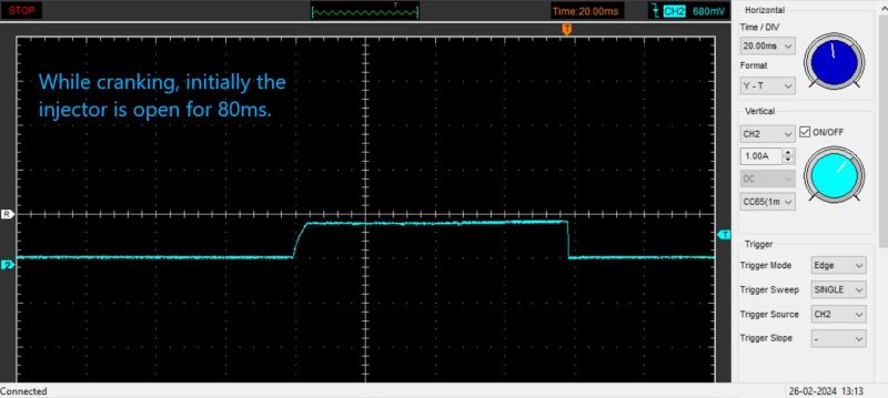

The injector curret test was good
I checked the fuel injector current waveform, and the PCM definitely controls the injectors, creating a quite long pulse of 80ms while cranking. As I mentioned, I already checked the injectors; they are neither stuck open nor closed and can hold pressure. Additionally, I performed an injector balance test, and all injectors were found to be in good condition.
Here is the video of the injector current while cranking.
Injector pulse related sensors look good (except one)
Now, I suspect that the PCM floods the cylinders with fuel, preventing the plugs from producing a spark. As you suggested, I checked all the sensors that might be related to injector pulse while cranking:
What I suspect after the tests above
I noticed that the throttle plate in the throttle body doesn't move when the key is on but not cranking, even when I move the accelerator pedal. Additionally, it remains stationary while cranking. It's an electronic throttle body, and I'm unsure if this is normal. I would expect the throttle plate to be moved by the PCM, at least when cranking. Thus, I suspect something strange with the throttle plate control. However, if the computer detects that it commands the throttle plate to move and it doesn't, it should set an error code. Yet, as I mentioned, there are no codes.
In this video I show that when it is key on engine off, I move the accelerator pedal but the throttleplate not moving, it just clicks when I turn off the key. (background noise)
As far as I know, these Fords have a problem with the instrument cluster. The solder joints can crack, causing various electrical problems and error codes. The instrument cluster in this specific car has been repaired twice already due to cracked solder joints. However, when this issue occurred previously, it was obvious; the instrument cluster lights were blinking, and various communication error codes were displayed (including throttle body). Moreover, in this model, the throttle is controlled by the instrument cluster. But since there are no codes, I'm not sure if the instrument cluster is causing this issue.

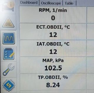

- Engine coolant temperature (ETC): 12°C (53°F) - matches the actual ambient temperature
- Intake air temperature (IAT): 13°C (55°F) - matches the actual ambient temperature
- MAP: shows vacuum while cranking
- Throttle position (TP): I was moving the accelerator pedal while cranking and I could see throttle position value changing on the scan tool. (In reality it was not moving.)

Okay, so now the car is running. As I mentioned, I had a sudden crank with no start. I checked everything, and everything looked good. While I was checking the secondary waveform, it looked strange. I haven't seen anything like it anywhere else on the internet, not even anything similar. Based on Tyler's suggestion, I ended up checking the fuel-related stuff again. When I completely cut the fuel while cranking, the secondary waveform looked normal.
This suggested that the waveform I'm looking at means that the cylinder is flooded with fuel, and the spark plug is not able to create a good spark. Why is the cylinder flooded with fuel? Is it because there is no air? I checked the electric throttle body, and the butterfly valve was not moving while I was pressing on the accelerator pedal (also, there were no DTC codes). So, the PCM detected the accelerator pedal movement but didn't control the butterfly valve for some reason.
I ended up resetting the PCM and all other modules in the car and sprayed a ton of brake cleaner into the throttle body while cranking. That caused something to happen; the engine started, and the butterfly valve in the throttle body was now controlled again by the PCM. So the car runs fine now.
Maybe it was a glitch in the PCM that somehow fixed itself by resetting it and spraying brake clean. I'm not happy with this fix; it is totally confusing. But if there is some sort of error that cannot be explained, just reset the PCM and the other modules as the last resort.
