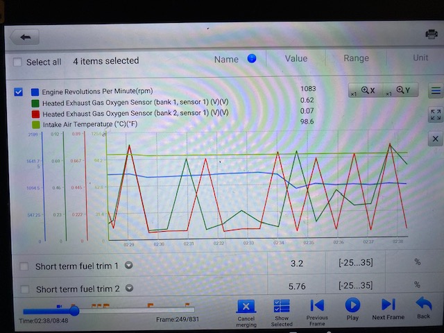

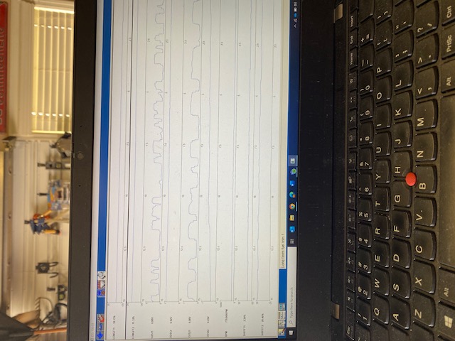

04 Ford Ranger XLT 4.0L.  Problem apparently began after vehicle was at body shop for over 7 weeks.  Damage area was to RF headlamp/fender/hood.  Vehicle was taken to a shop where they replaced the MAFS, Intake, coil pack, plug wires/plugs, fuel filter and fuel pump.  They said they disconnected cats with no change, then they gave up.  Initially P0301-303 and P0174 were stored.  Cleared dtc's and only P0174 returns.  STFT bank 1 close to Stoich, LTFT bank 1 -9% to -12%.  STFT bank 2(at idle) 25% within 15-30 seconds from start up, LTFT bank 2 25%. At 2500 rpm STFT B2 will drop to 3%-5%. I do not hear a vac leak and have sprayed this engine with enough carb cleaner to choke a bear.  O2s and FT do not react when spraying to find leak.  I removed vac line and sprayed carb cleaner directly into intake and do see that O2s and FT do respond.  All injectors ohm at 16.4-17.4(engine at operating temp).  I can see with a scope the bank 2 injector pulse is slightly longer than bank 1 and they do respond to throttle snap.  O2s, via scope, are switching however rears are B1 .70 and B2 starts around .60 then will drop to around .28.  I've verified ECM power/grounds are good/clean. At idle there is felt a slight stumble from the engine, using Fords IDS and power balance test, shows cylinders 1-3 as being weak. Electrically I don't see anything obvious, mechanically the engine sounds/drives fine(no ticking/knocking/etc). Both front/rear O2s have been replaced along with the ECM. The way B2 FT is reacting it acts like a large vac. leak.  But does not explain why B1 is opposite. I wouldn't think timing would be off, no dtc's and vehicle starts/runs fine.  Thoughts?

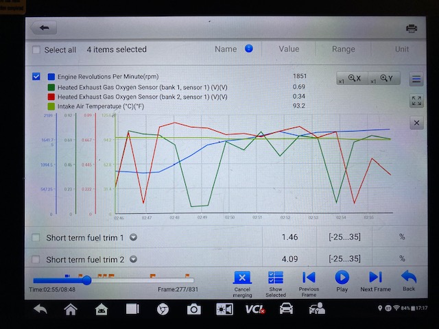

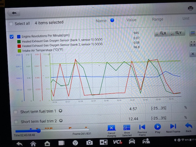

2 years 7 months ago #64675 by jgill9736
Replied by jgill9736 on topic P0174 FT too lean bank 2
Ran WOT and monitored IAT and front O2s.  Hopefully my attachment shows up, not very computer savvy, lol.
2 years 7 months ago - 2 years 7 months ago #64676 by bills4065
Replied by bills4065 on topic P0174 FT too lean bank 2
When you get a chance take for a drive and graph both the long term and short term fuel trims for both banks. I would throw in calculated load % paid also. Your O2 sensors did what they should at wot. I see the upstream sensors were replaced, I would just confirm not a chance O2 harnesses accidentally got switched and plugged into wrong banks. Just nice cruise, do not need pedal to metal. Just curious, is Bank 2 Sensor 1 switching normally?

  • jgill9736
  • jgill9736's Avatar Topic Author
2 years 7 months ago - 2 years 7 months ago #64677 by jgill9736
Will have to road test another day. Will update after next road test. With scope, O2s were switching nicely. With IDS and graphing PIDS, they are erratic, same with Autel. I'll try and upload other pics shortly.  The O2s are connected properly. Bk1s1 connects at the back of block near bk1 head.  Bk2s1 connects under vehicle near shift linkage of trans.  Both rears are similar, BK1s2 connects near the starter and Bk2s2 connects near the top rear of trans.  The harnesses are not long enough to switch connection points.  I double checked that early on.

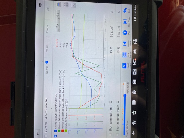

  • jgill9736
2 years 7 months ago #64767 by jgill9736
Road tested from cold start to operating temp. recording LTFT/STFT and engine load.  Trying to get video uploaded to youtube to share.  Also recorded front/rear o2s along with MAFs.  Not sure about MAFs reading from Autel, it differs from IDS.  Vehicle did have OEM mafs, i replaced with a used one from an 09 ranger, same part number, no change to fuel trims. This is the link for the O2s recording,

  • jgill9736
2 years 7 months ago #64768 by jgill9736
Here is the link to LTFT/STFT and engine load. This  was from cold start to operating temp. The O2s video is at operating temp.

2 years 7 months ago - 2 years 7 months ago #64803 by bills4065
Your O2s and Mafs video - I noticed the mass air flow sensor read 0 until into 1 minute 15 seconds of the recording. If there are no vacuum leaks anywhere, and you can not find any -this displays all the symptoms of a bank blockage, but your back pressure test throws that thought out the window lol  I think time to put a smoke machine on this truck. Thoughts anyone?
