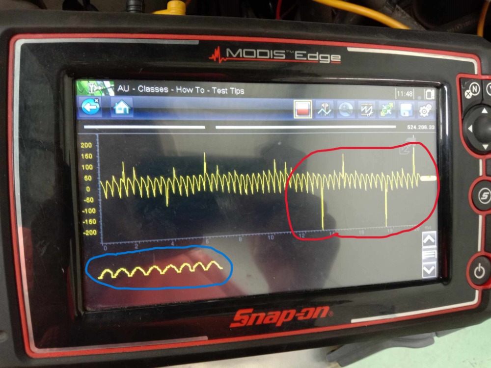

Hi guys, in Australia struggling with this one i think i am on the money but want to prove it!

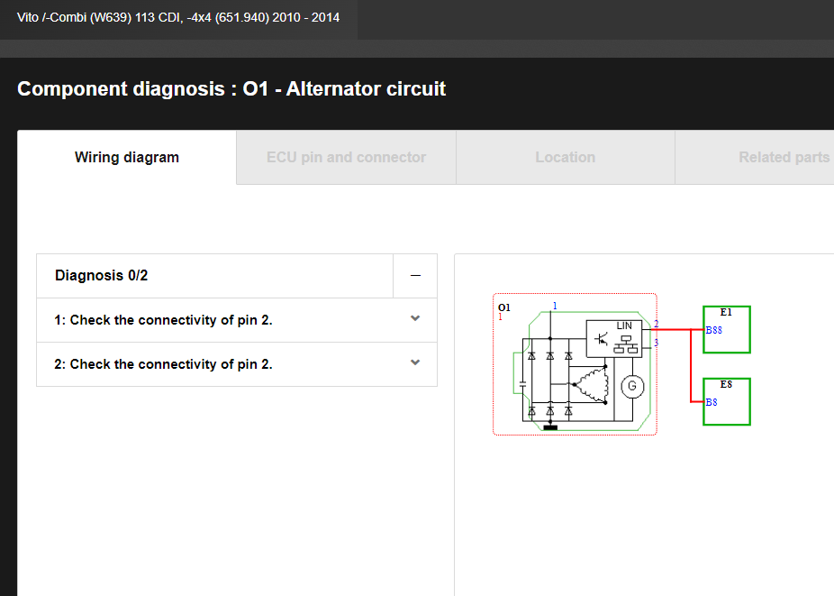

U0106 lost communication with glow plug control unit, we have tested all feeds to the glow plug control unit and they are fine. Tested CAN OK.
Found that on the LIN the control module and the alternator are linked
I have a picture of the diagram showing the link, and my alternator ripple test....first time poster just working out how to upload hopefuly it has attached
I have confidence in the wiring, now i am torn between the glow module and the alternator, 0 symptons on the car just a CEL

Your AC Ripple capture looks perfect in my Opinion. <100mV. All the tails and humps look very even and no repetitive anomalies are present.
Remember there are three positive and three negative diodes, so follow your ripple "humps" in 3's. Your good!
What you have circled in red (those big spikes) is the internal regulator in the Alternator Switching as the PCM controls it's output via the Lin Bus.
You can test this by adding various loads and you'll notice those spikes will coincide with loads being turned on or off.

Just as Paul stated: there is no obvious problem to be seen in your capture.

I have had multiple people tell me that ripple is bad so am very confused.
The fault is permanent
The glow plug module is outputting to the glow plugs and all glow plugs have been powered individually and there amperage is the same

If the fault is permanent, (and sets with the engine off), then it isn't going to be alternator related.
