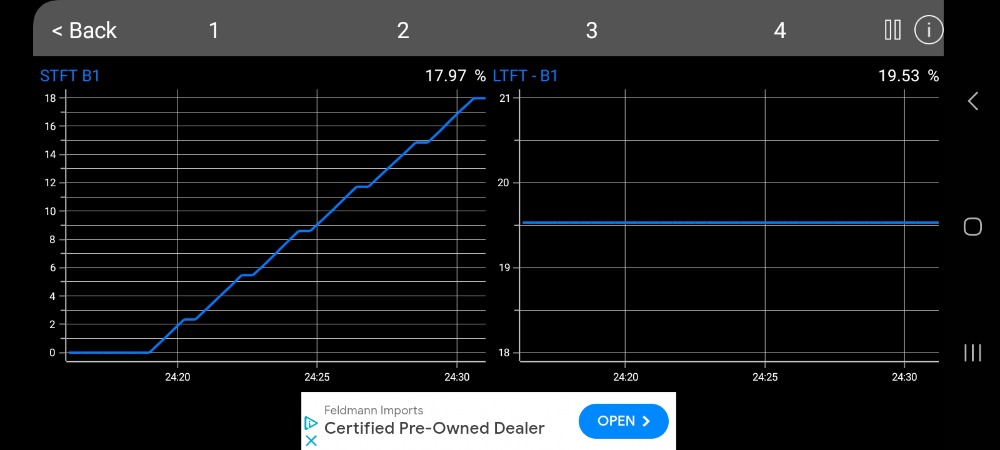

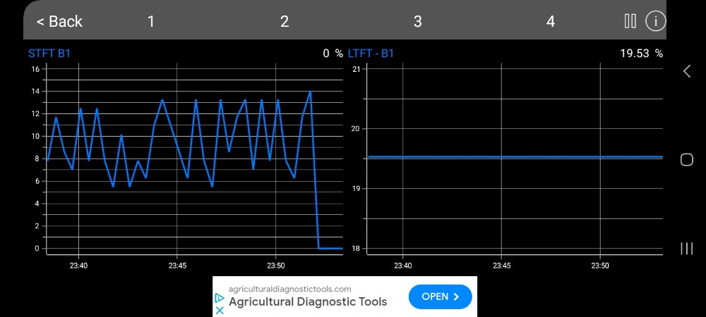

Hello,
Big fan of scanner danner vids.
I have a 97 toyota tacoma 2.7l, 5 speed, 4x4.
It has a p0401 and ltft always at +19.53.
The stft does funny things. At idle stft goes to +19.53. Tapping the throttle will immediately bring it to zero. When driving, at 1500rpm stft is ar around +10%, at 2500rpm its bounces +- 5% at zero.
I tested the exhaust for leaks and found one at the manifold around the first o2 sensor and have since had thr manifold welded there.
Is this scenario a guaranteed vacuum/exhaust leak and I should keep searching for more leaks or something else.
Also, how does the p0401 relate to this.
The truck drives fine and idles fine.
Thanks for the help.

so if I am understanding you correctly, at 1500 rpm you have a combined fuel trim of 29.53%. At 2500 rpm you say your combined fuel trim numbers are getting better, ie going lower . Try checking stft and ltft at 1500, 2500, and 3500 rpm. see what your values are at these rpms.The way I am reading what you have said, your combined lt and st trims are getting better when you increase rpm, is this correct?

That's correct. Ltft is at +19.53% from when I start the car to when i turn it off and never moves. Stft will move as described in first post.
