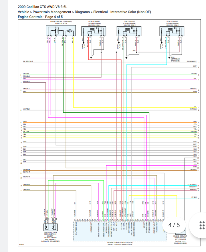

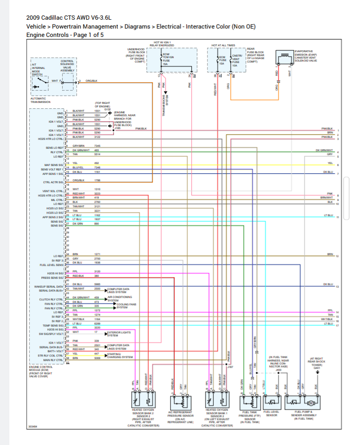

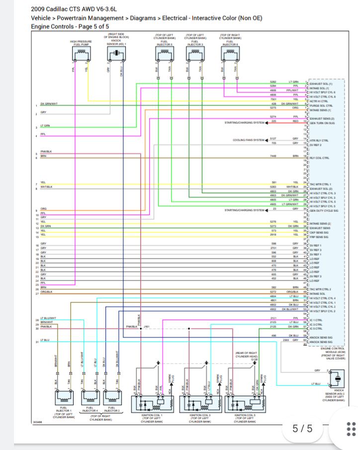

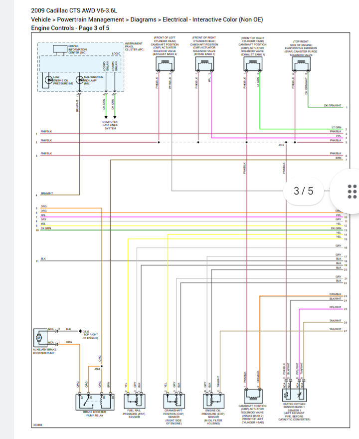

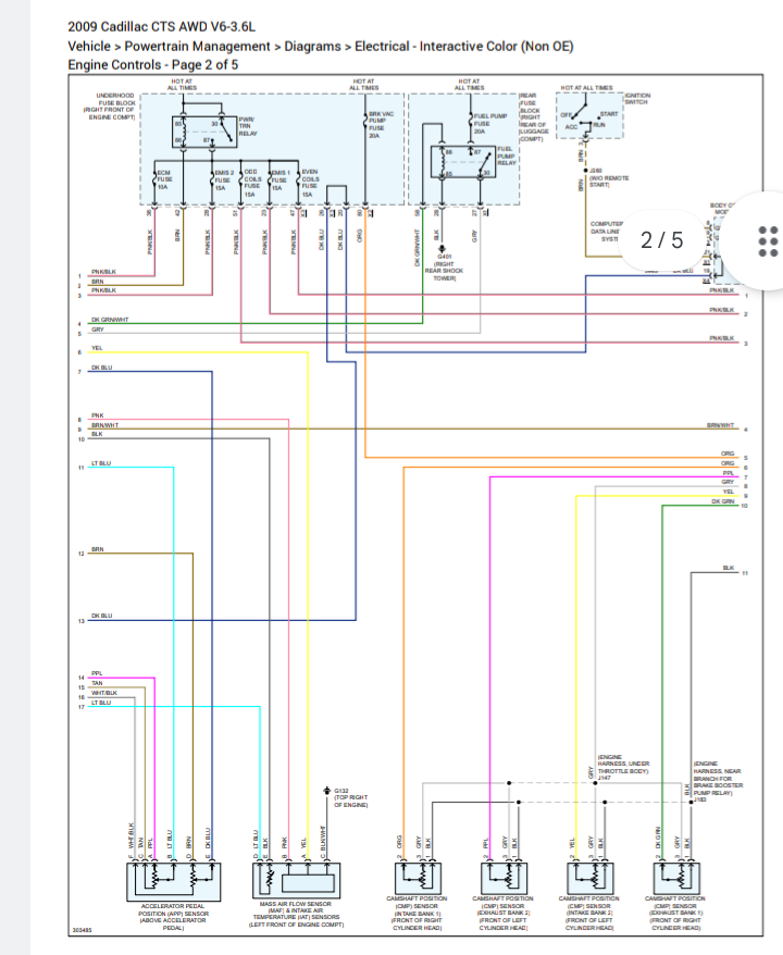

- cadillac 3.6 cts D.I is a NO start ,with a p0335 =[Crankshaft position "A" circuit malfunction] scan data shows pid ckp counts at 0 during cranking. With the sensor unplugged there is .02/.02 /5 volts on the pin terminals. wire diagram shows pin 1 =low Ref ,pin 2=ckp sig, pin 3=5 volt ref 3. with test light connected to B+, I tapped on the sig wire, thinking its a pull up hall effect ,to bypass the sensor and generate a signal, with no change to ckp counts on scan tool. but the testlight illuminated, suggesting a ground on the sig wire.
- i am fairly sure that it is a pull down sensor, and there should be 5 volts on the signal wire = .0/5./5.volts on the pins. all 4 cam sensors have this layout and i can generate a sig by pulling the 5 volt sig to ground with a test light/bypass.
- due to the .02 volts on the CKP sig wire, i cant pull it to ground as its already at ground voltage . and i cant pull it up with 5 volts either as the voltage stays at .02 volts. so i believe the sig wire is shorted to ground . i located all sensors on the 5 volt ref 3 circuits and unplugged them allthough its a signal wire and i dont think sig wires are ever shared . not 100% sure. i even unplugged all sensors on 5 volt system to be sure.
- question= is the sig wire shorted, is the ecm just not sending the 5 volts as iv tested at the ecm after isolating the sig wire,?? still .02 volts. what am i missing ? if any one has any direction or input i appreciate it. thanks
- these electrical diagrams are the best i could find , the year, make ,and model are correct , but some of the wire colors are wrong. about 10% are wrong color.

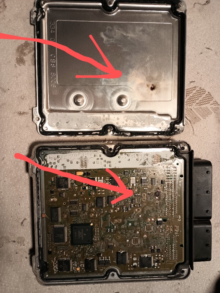

You could try cutting the CKP signal wire a few inches away from the computer. (Where it will be easy to repair.).
If the 5v is present after cutting the wire, it is definitely shorted in the harness somewhere. If it does not, then in it is time to suspect the PCM and check the powers and grounds to it.

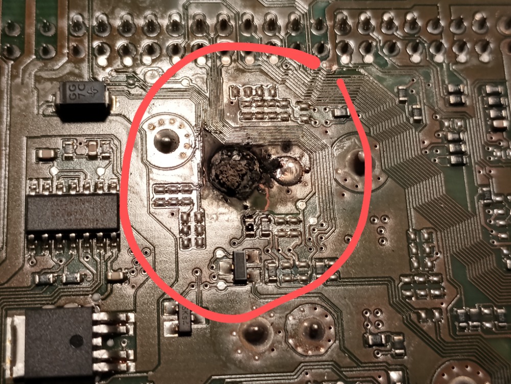

2 years 9 months ago - 2 years 9 months ago #64240
by Patrickreaves
Replied by Patrickreaves on topic cadillac cts 3.6 D.I. ckp sensor sig shorted to ground ?

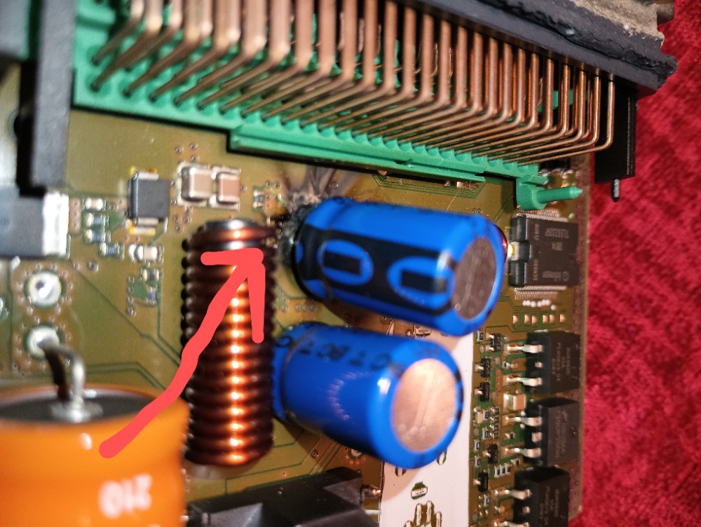

Called the bad computer finally. CKP sig shorted to ground internally of the ecm.

Thank you for the update. I am pretty sure it was not hard for you to make the call. It was obvious that the signal was shorted to ground. All that was needed to do was just unplug both the sensor and the control module connectors and ohm either end of the signal to ground or use a test light connected to ground. If there were continuity to ground or the test light illuminated, the signal wire would be shorted to ground.
